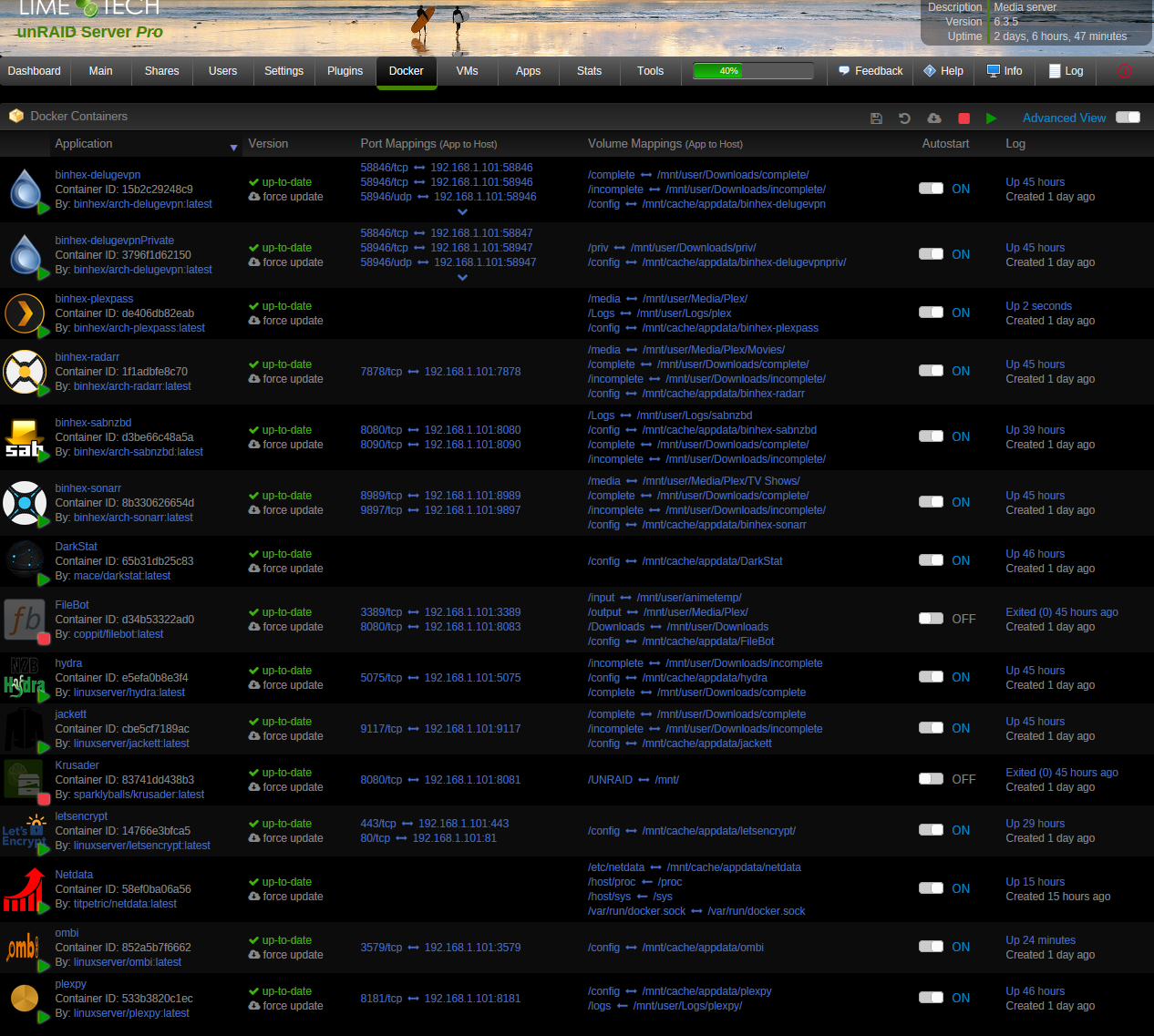

Been using unRAID for a few months, with no issues until recent. After having done a CA backup, where it had an error where it said that it failed to complete backup, I was successful to backup my appdata, and flash after a second attempt.

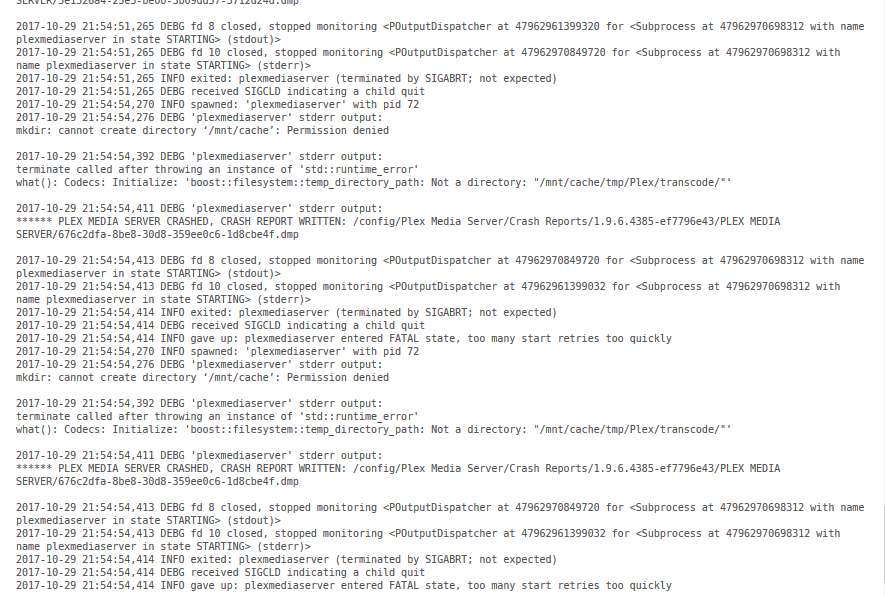

After a few hours, an issue I was noticing occur was with Sonarr/Radarr where in their logs, from the docker page, where they mention they only have read access, and was crashing their applications. Following that, Plex has been having the issue where it will respond back with the issue of Permission Denied (included below labeled as PlexLivelog).
These issues were yesterday, where shutting down Docker, removing image, and rebuilding the containers seems to have fixed the Sonarr/Radarr problem. Then in the morning, I received a notification of " Call Traces found on your server ", and was recommended to upload the diagnostics to the forum.

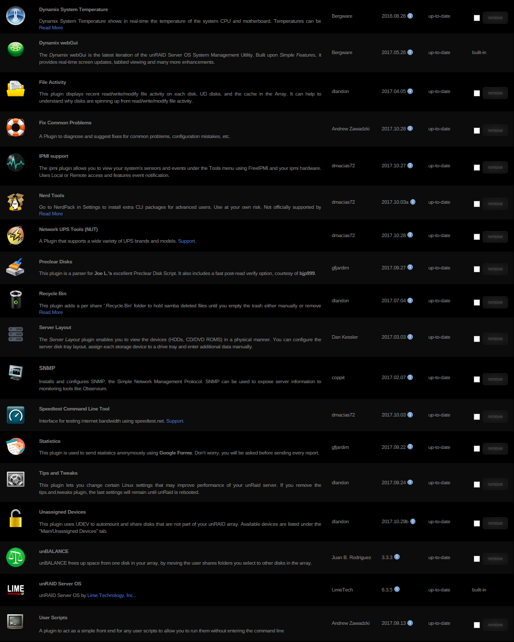

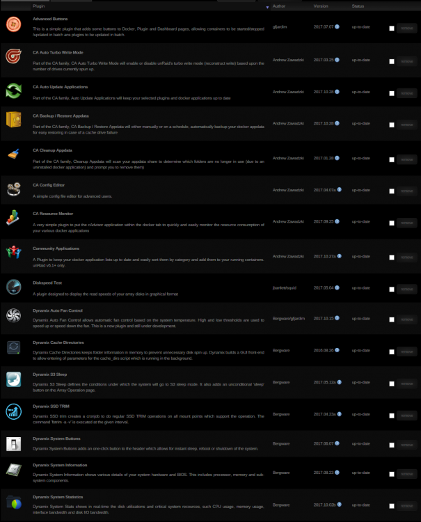

I've also gone ahead to include a screenshot of Hardware, plugins (if relevant), and another screenshot of all active Containers, with the unRAID version shown (6.3.5).

The docker image is corrupt, delete and re-create.
