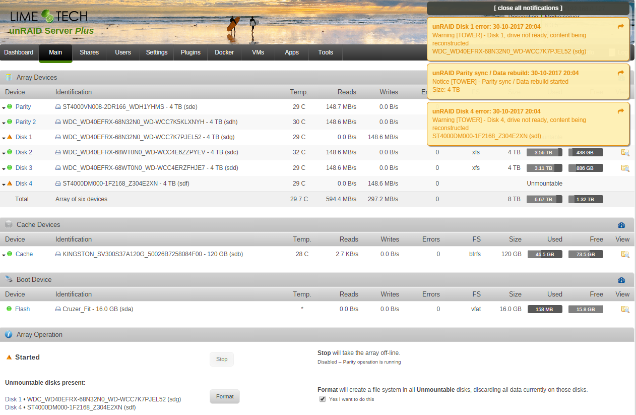

I got home from work and noticed my Plex Server wasn't responding, and not my SMB share, and not the WebGUI either. I held the power button down on the unRAID server to shut it down and when it came backup I had "device disabled, contents emulated" on two of disks (three at first, one of which was a parity drive, but that fixed itself after another reboot).
All of these disks were connected to my PCI SATA controller, so I'm fairly sure that thing got a spasm, or the SATA cables connecting them got (very old cheap cables, I'm ordering some new ones, I promise) so I think the disks are alright. I also ran a SMART test on them and both were fine, apparently.
So I followed the instructions here https://wiki.lime-technology.com/Troubleshooting#Re-enable_the_drive for re-enabling drive(s) and yep, it's doing that now.
But I am confused.
Do I need to format them as the "unmountable disks present" warning says? It seems to be doing it's job (note the write speeds) so I am very confused.
Don't format anything!!
Please go to Tools -> Diagnostics and post the file so folks can take a more detailed look and offer help.

I think the formatting isn't needed because when it's reconstructing its rebuilding the disk on a hardware/sector by sector basis, so when it's done reconstructing the file system will be back, right?
Same reason that my dockers are gone right? They were on Disk 1, but since Disk 1 is disabled they can't be "found", but they'll be back once the disk has been reconstructed?
I'm not gonna be home at all tomorrow so I'm hoping this will just sort it self out, I can't really do anything about it right now until the weekend.

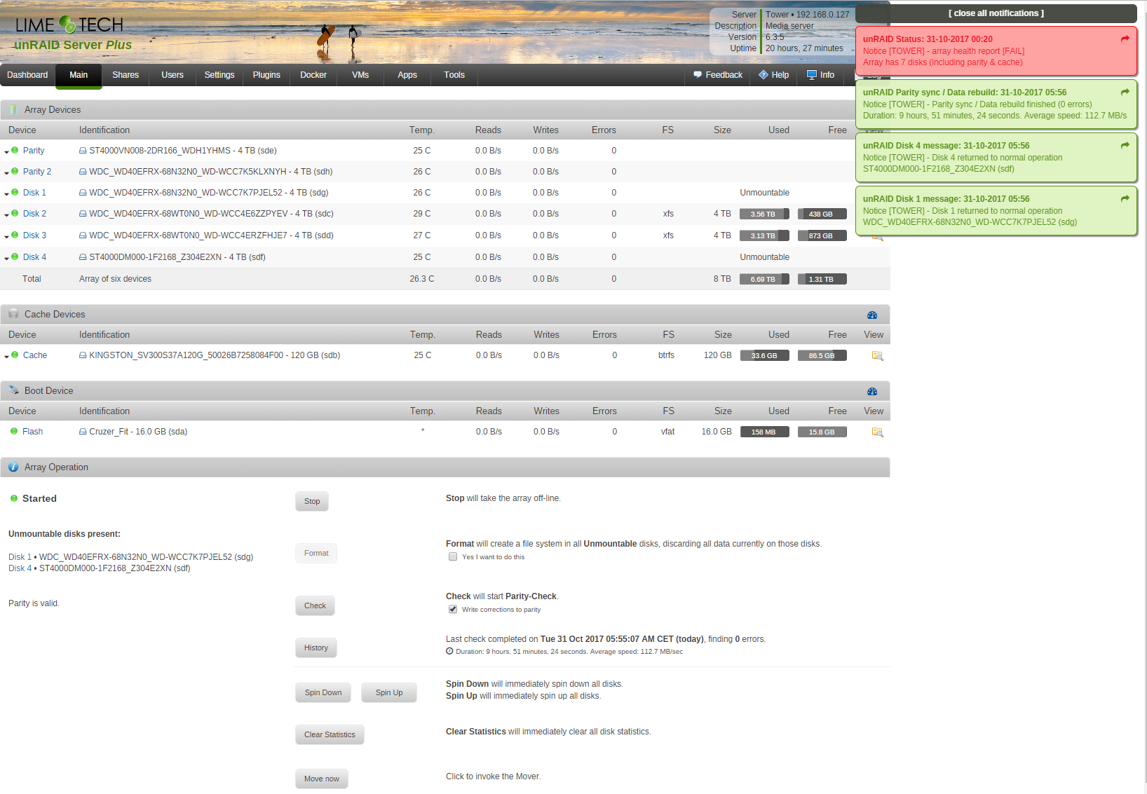

Probably will have to fix filesystem AFTER the rebuild. Definitely DO NOT format anything.
The reconstruction finished without errors, but now it looks like this. What do I do?
Stop the array and the start the array in maintenance mode.
Click on the disk you want to repair, e.g. disk 1 or disk 4.  Scroll to the section CHECK FILESYSTEM STATUS and click the Check button. By default it will to a read only scan. See the Help text to do a repair action (in your case remove the -n option).

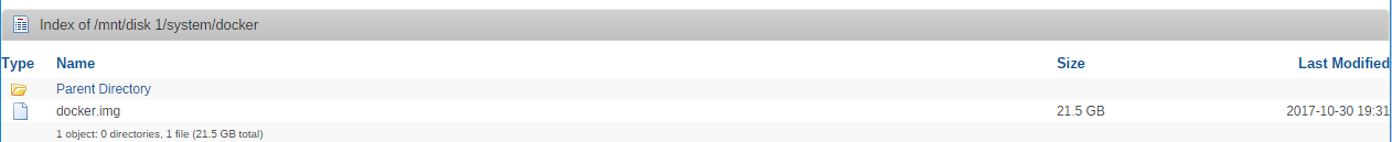

So I ran with the -L command, after Googling, and hey, everything is back now... except my Docker containers, all of them are gone.
On Disk 1, there is a docker.img file that was modified around the time I got home from work and noticed everything had hung up.
Any ideas? I would really prefer if Plex didn't have to re-identify everything.
EDIT 2: I'm fairly sure it has something to do with the cache, as nothing happens when I invoke the mover, and there is a docker.img on the cache.
EDIT 3: Actually, the mover does move stuff that is in my share. But there is still a 20 GB docker.img on there that won't move.
EDIT 4: I used templates to re-create my Plex and PlexPy docker, and all the content is there so it's all good. I'm not sure what to do with the 2 docker.img's though.
EDIT 5 (sorry): I followed the instructions here on how to delete your docker.img, and it disappeared from my cache drive. But the one on Disk 1 remained, and when I went to the Docker tab, there everything was, just as it was before everything went down.
So I think I'm good now!
