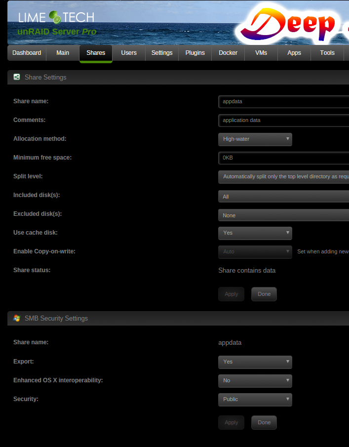

I have a 1TB SSD for a cache drive. Below is the configuration for the appdata folder. I am not sure how to make it "cache only."I installed netdata. Which section of it should I screenshot? There is a ton of information in it.
Set 'use cache disk' to only
Got it, the appdata is now set to cache only. How do I disable the swap file? I have looked everywhere.

You want to go back and set cache disk to Prefer, and the run mover.  That will bring the appdata files back from the array.  You can then leave it as Prefer or switch to Only.
