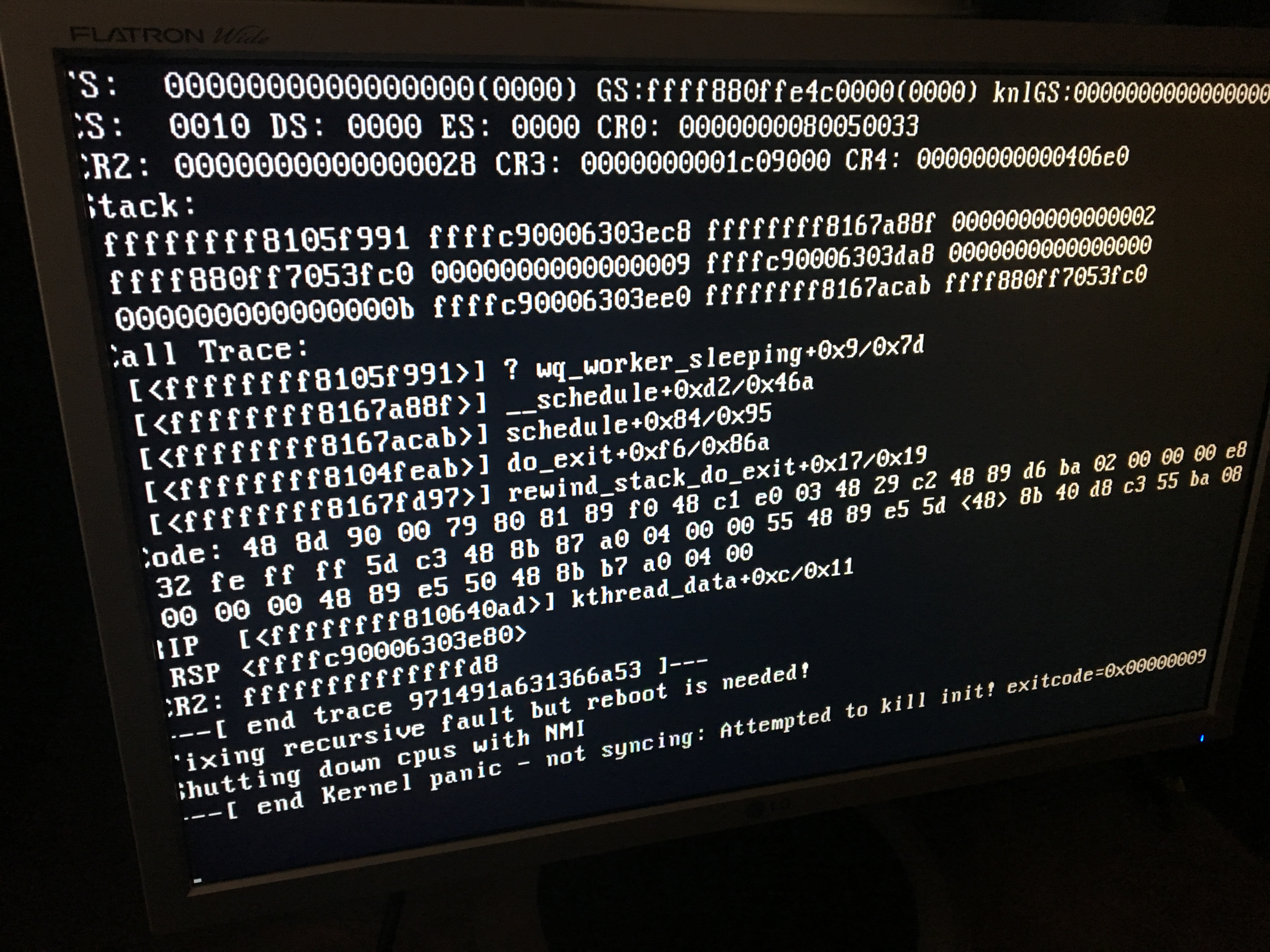

What do I need to provide to help you guys debug why I can't upgrade?
I've tried twice (as new versions come out) and when I upgrade I get a kernel panic. Since I can't login I can't get logs and all I can see is what's the screen when it panics. Is there anything I can do to help debug this issue, I really want to upgrade as I'm a few minor versions behind.

What are you seeing on a monitor?  (A Good sharp, not-blurred, not flash spot visible in the photo is what is needed.)
This was from last time.
To be clear, 6.2.4 has been stable running for months with zero issues. It's only if I try to upgrade to a newer version that I get this so I can't imagine I have faulty hardware.

Did you see the boot menu and (1) did both of the bz* files get unzipped and (2) the boot process actually start?
Yes to all.
