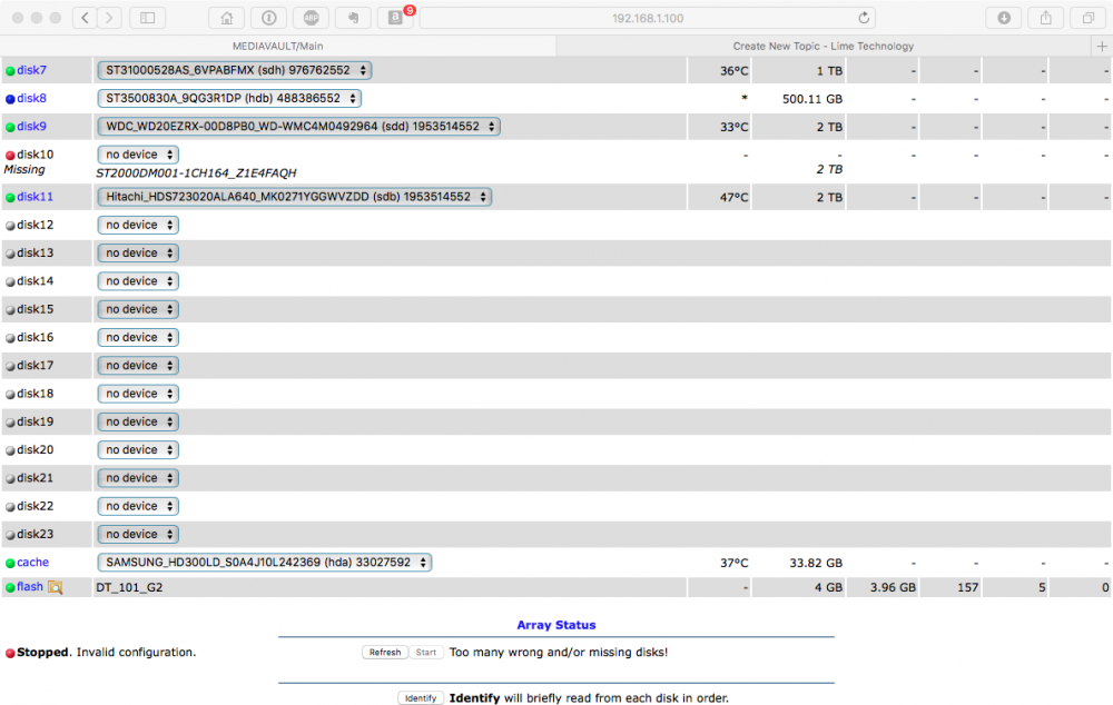

OK, this is a little more complicated than I thought. Running 5.0
Left my server to copy all files off so I can rebuild it. Turns out not all of the files copied so I tried to reboot it again. Turns out there are two failed disks, a 500 and a 2TB.

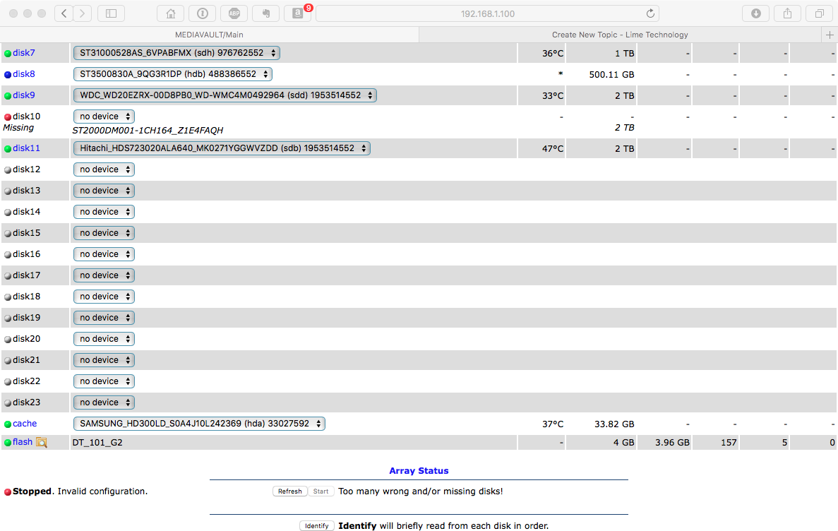

The 500 shows up to be assigned but the server does not give me the option to start with the too many missing/wrong disk error. I can assign it and the button turns blue.
I bought a 4TB figuring that I could replace the 2TB and then there would be just one missing disk after a rebuild but when I exchanged the 2TB disk for the 4TB, it says, WRONG.
The first pic is how the server boots up. The second pic shows that it sees the failed 500 but won't use it.

You have to failed disks with single parity so you can't rebuild any disk.
Post the exact unRAID version you're running, SMART report for disk8 and disk10(if this one is still detected).

Disk 8 seems to want to let me reassign it but disk 10 doesn't show up at all. So lets just forget about it for now. Assuming I want to start the array by assigning disk 8 because it will let and and leave disk 10 out, what do I do?
Thank you very much for your help.
If disk8 is bad it may still crap out later, I would like to at least see a SMART report, but if you want to proceed and forget about data on disk10, do this:
-Utils -> New Config
-assign all disks, double check parity disk is in the parity slot, remaining disks you can use any order you like
-start the array, a parity sync will begin, data on all data disks should be accessible
