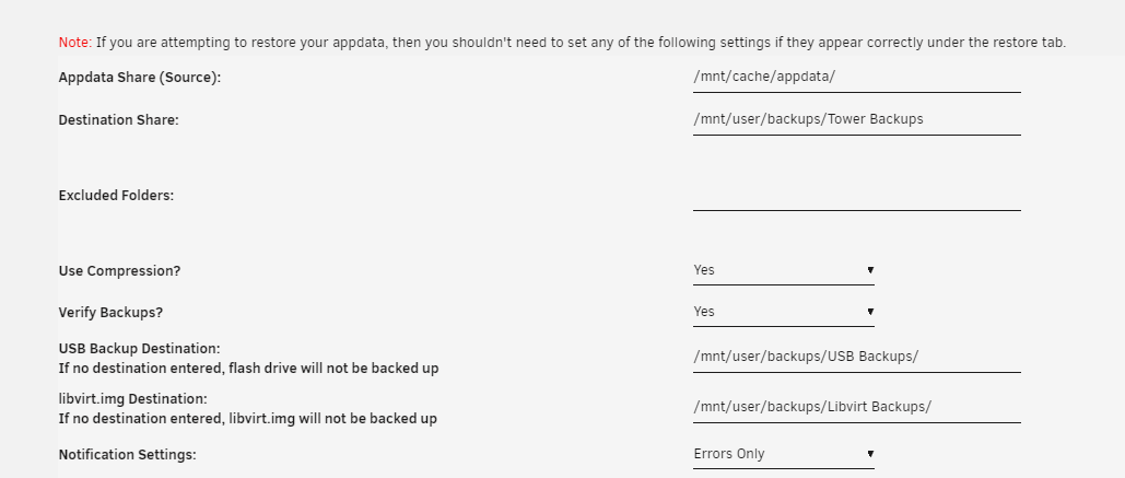

Having some weird issues with permissions. Accessing the backups from Windows system. The "USB" and "libvirt" backups working fine. But when I try access the files under "Tower Backups" I get an error that I cannot access. Pasted in the Plugin settings, which all look fine. It's all up to date as well.
Thanks!
