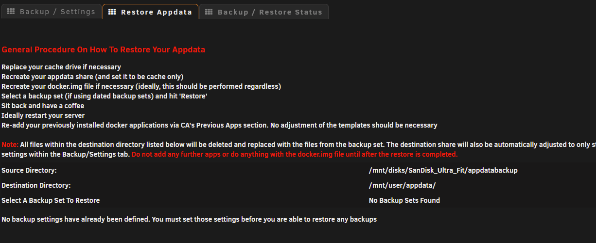

I don't know why but I can't start a rebuild. I have not changed anything and there are now Backups but they are still on the stick.
Is the USB mounted?  Can you access it over the network?  What's the contents within the appdatabackup folder on it?
The USB is mounted and I can access it over the network-share
This is the content and the schedule for backup was successful but I don't get the option to recover
When I am getting in the folder there are folders for every date and in there is a file like "CA_backup.tar.gz"
I'll have to look at it.  Not sure why it won't work.  What you might try doing though is create a new share on the array, and copy the backup folder into that share.
Then on the Backup settings, change the destination to the array share and folder.  Reload the tab and see if it picks up the backup set on the restore tab
Now it is working!
Thank you
