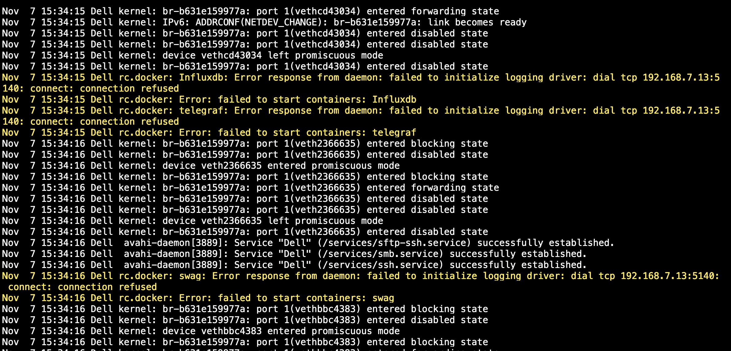

Strange problem with my first appdata backup on 6.11.2 - some containers (which were running and set to autostart) weren't restarted post-backup.
Maybe coincidence but all the affected containers use a custom network (none of the non-custom network containers failed to start.)
Maybe a fluke or maybe an issue with my setup, although I haven't changed anything and this plugin's been rock solid.
Anyone else see this?

Interesting - the containers that didn't autostart use my vpn container's custom network.
I have the order right (vpn before the others) and wait 60 set on the vpn container but I never considered whether ca.backup observed wait time since it always "just worked" – maybe it used to and now it doesn't.
If the plan's to go to container-specific tar files, that delay's probably sufficient to make observance irrelevant.
Got a bit further (regarding: some containers sometimes doesnt start).
This time, it happened to mysql:
[09.11.2022 17:46:38] Starting mysql
[09.11.2022 17:46:39] Error response from daemon: failed to create shim task: OCI runtime create failed: runc create failed: unable to start container process: error during container init: error running hook #0: error running hook: exit status 1, stdout: , stderr: time="2022-11-09T17:46:39+01:00" level=fatal msg="failed to set IPv6 gateway while updating gateway: file exists": unknown
Error: failed to start containers: mysql
(the important error seems to be: "failed to set IPv6 gateway while updating gateway: file exists")
And I have no clue what that mean. Maybe a 1 sec wait between docker start's do the trick?
This issue only occurs occasionally!

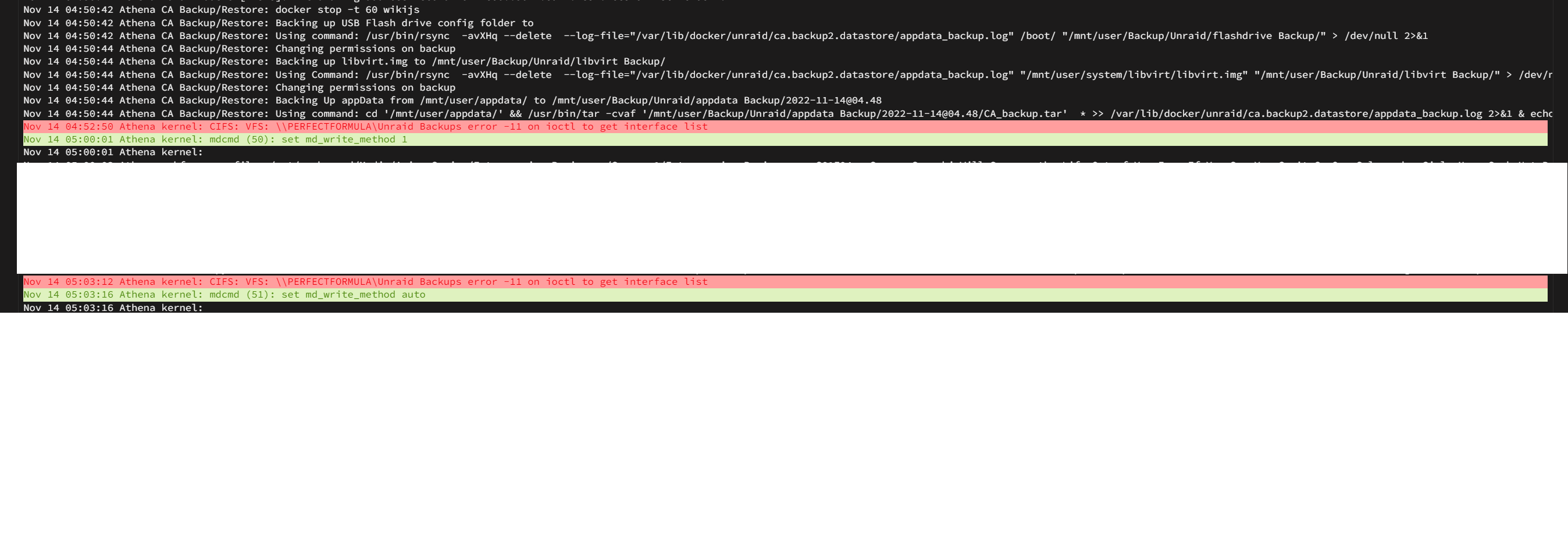

I might have run into another issue as well. it seems that when running on a scheduale it will split the backup into two files or 3 some times causing duplication of taken space.
I have not been able to figure out what is causing this but my hunch is that it does this when it fills up one disk and has to move to the next or if a move runs on the cache.
I have tried direct to array and also to cache first but always duplicate .tar files

Could you show a screeshot?
Any last log entries?

Ill have to wait for a backup to run so I can get a screenshot for you of the duplicate issue.

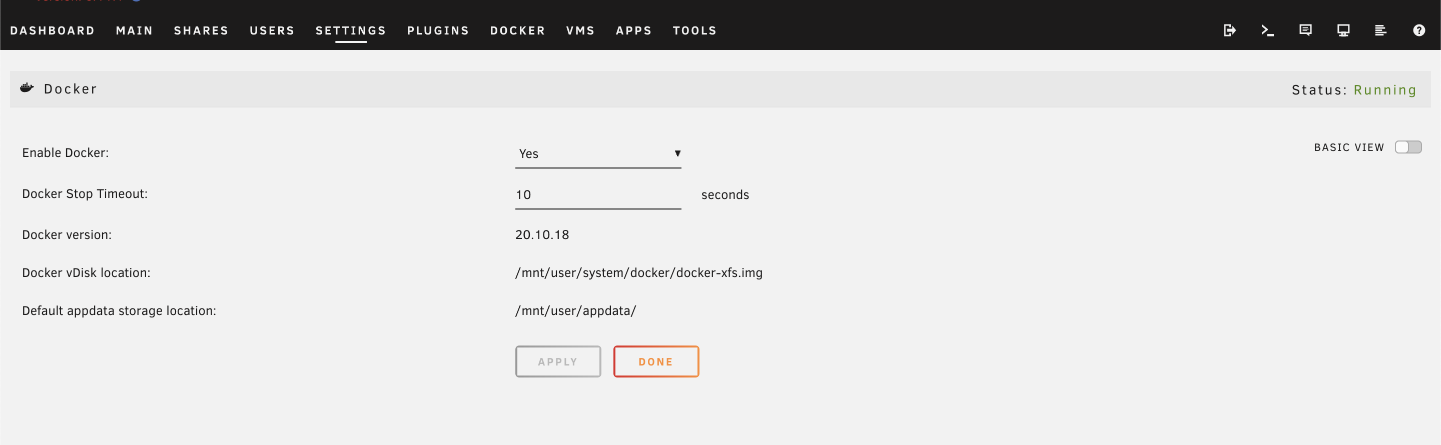

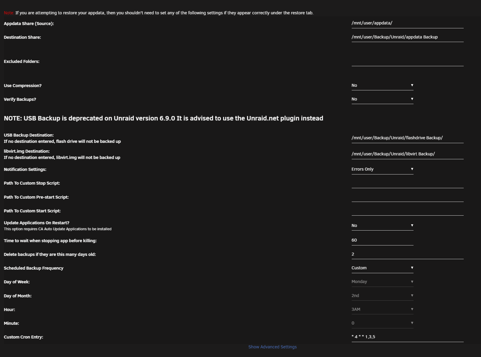

Please see below is a couple of screenshots of the duplicate issue that has me a bit stumped.
I have been through the code that lives within the plugin as a brief overview but nothing stood out as incorrect in regards to this issue.
"\flash\config\plugins\ca.backup2\ca.backup2-2022.07.23-x86_64-1.txz\ca.backup2-2022.07.23-x86_64-1.tar\usr\local\emhttp\plugins\ca.backup2\"
I found an interesting file with paths in it that led me to a backup log file "/var/lib/docker/unraid/ca.backup2.datastore/appdata_backup.log" but as it gets re-written each backup it only shows data for the 4:48am backup and not the 4:00am one. so that is not useful, I did not find any errors within this log either.
The fact that its getting re-written most likely in my opinion means that the plugin is having issues interpreting either the settings entered or the cron that I have set
Edited by IronBeardKnight
Adding additional investegation
