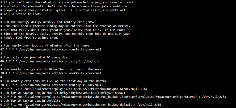

Interesting, the backup seem to start 2 times.
Could you post the output of "crontab -l" inside an unraid terminal?

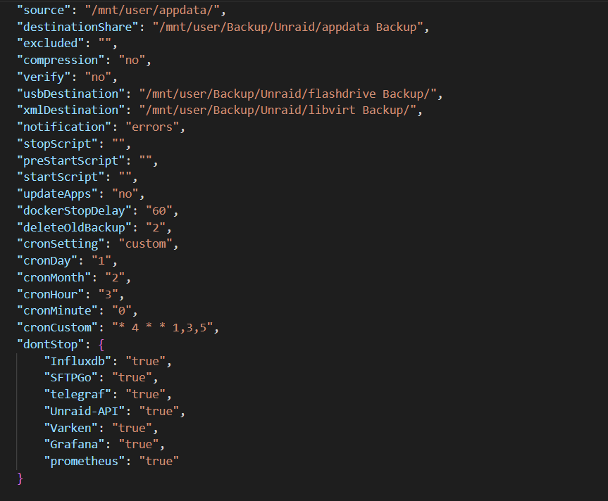

That seems incorrect - could you post your schedule settings from inside the plugin settings page? The current setting says "At every minute past hour 4 on Monday, Wednesday, and Friday."
https://crontab.guru/ is what I used as referance and from my understanding it is supposed to run at 4am every monday, wednesday and friday.
From BackupOptions.json :
Edited by IronBeardKnight
OMG you are right i'm clearly having a major brain cell malfunction lol I should remove the * and replace it with 00
so it looks like this " 00 4 * * 1,3,5 "
Do you think that is correct?
3 minutes ago, KluthR said:
Exactly. It should be starting with 0 4, not * 4.
Testing now! It will take a while to run through but i'm sure this is the solution. Thank you so much for your help, I just overlooked it lol I vaguely remember having it set to 00 4 previously but that was many unraid revisions ago probably before backup version 2 came out.

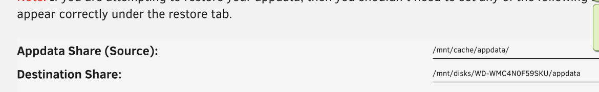

Is there any way to change the Destination folder? Or do I just have to copy everything before I reboot?
Could you be more specific? I dont really get what you mean.
When I go to the restore data tab, it shows it restoring to:  /mnt/cache/appdata and I can NOT change that location.
But my appdata is located in /mnt/cache_ssd/appdata
* I did do the restore and copied the files over which worked, but it would have been nice to be able to choose where to restore.
