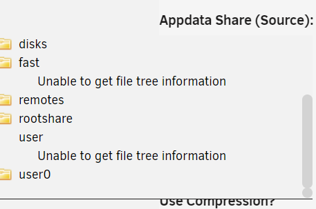

Trying to browse to source and get "Unable to get file tree information"
With latest 2022.12.04?? If you have 2022.12.02, please update, there was an permissions issue.
I just tested it, it works on my side:
The FileTree is also not a part of the plugin and should work independently from it.
That is the only version I have ever installed. Was using Squid's before.
Having similar when trying to browse destination.
Sometimes it works to get down into the tree partway. Seems like something is timing out since it will 'spin' for a while before giving up.
Browse tree in other places like docker host paths works fine and immediately.
Nope, sorry . cannot replicate this issue. I checked the FileTree component which is used inside the plugin: Its a common unRAID feature.
CA Backup just registers a call, when you hit the input field. unRaid is doing all the rest.

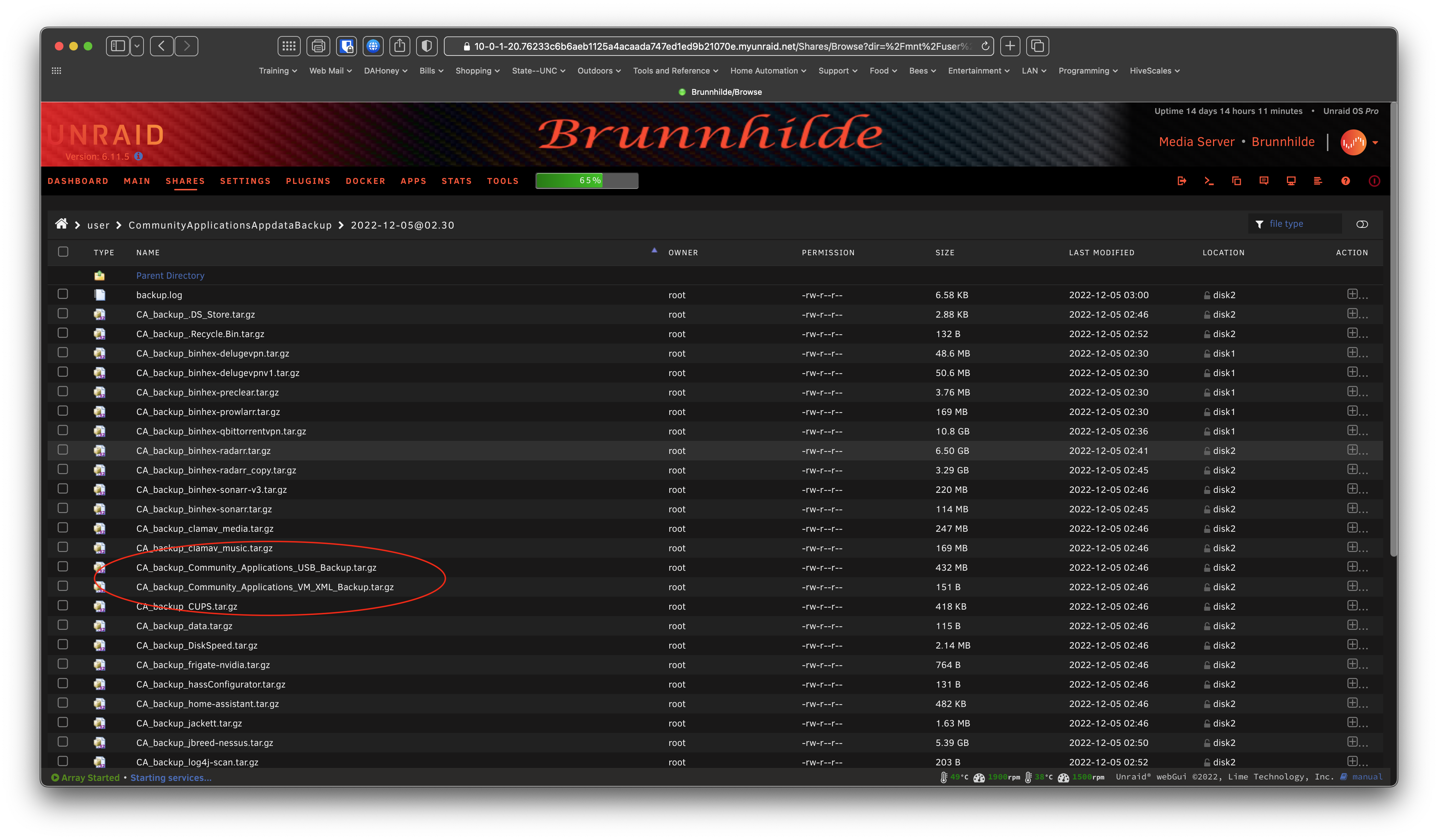

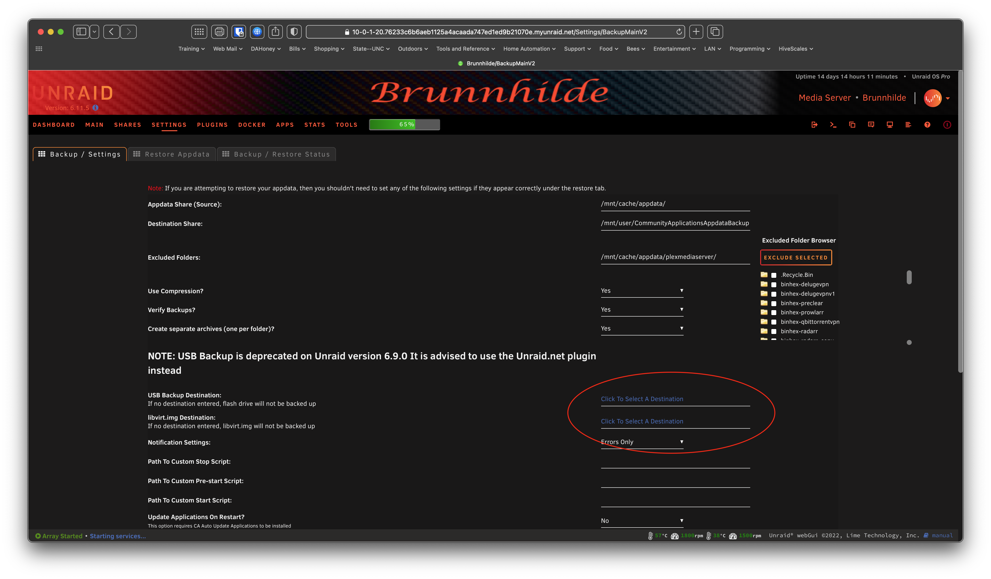

I also see that the plugin is creating a backup of my flash drive and libvirt.img even though I have not set a destination for those and therefore should be disabled.
Thats interesting as well. I doesnt touched code here, sure it is disabled/empty?

387900246_Screenshot2022-12-05at7_17_13AM.thumb.png.9707aaf693e986db05c46fa6307cc7eb.png337699859_Screenshot2022-12-05at7_18_01AM.thumb.png.5b012e42fc89644a45d38a5096a6ec6e.png
As you can see in the screenshots no location is set for flash or VM backups and  according to the info there that should disable those backups but if you check the screenshot of this morning’s backup you’ll see a tar file for both. My “excluded” settings are being respected though. Perhaps I can just manually type in the path to exclude for those?
Are you sure, that not just a folder with same name exists in your source folder?
The mentioned log should be copied to the destination after the run. Addiotionally, you could also take a look into the Backup status tab. Could you do that and post the result?
A bit embarrassing: I cant remember, if the plugin copies it in case of failure as well, Ill check that as well.
