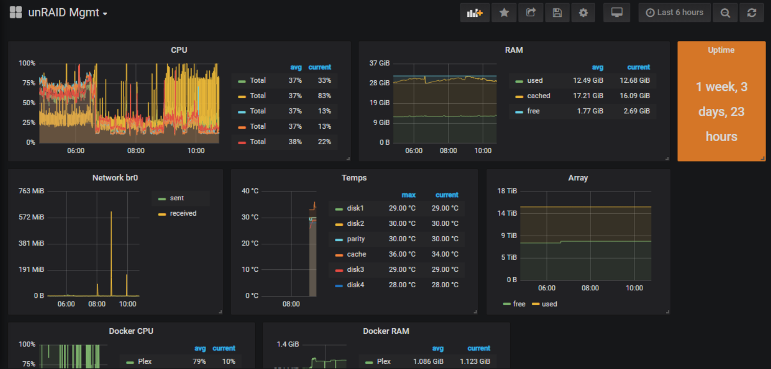

I just liked the dashboard on this site, and was trying to figure out how to mirror it using the pre-made docker images, and somehow figure out how to create the DB users etc and connect it all.  Usually I can find a really good tutorial here, and was wondering if I've just missed it.
https://denlab.io/setup-a-wicked-grafana-dashboard-to-monitor-practically-anything/

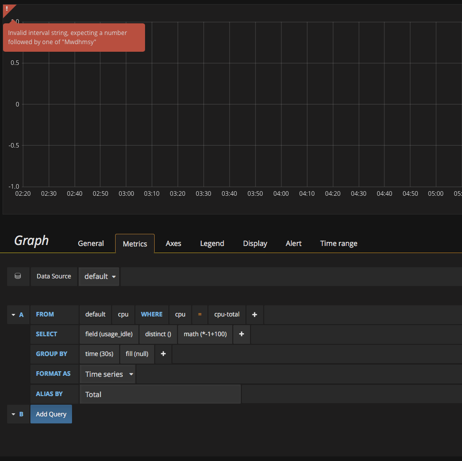

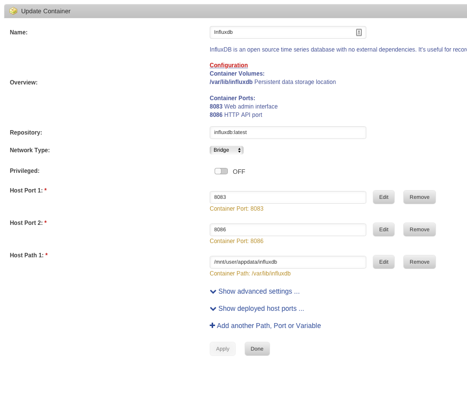

I get a random error when following the first step in making a dashboard for CPU.

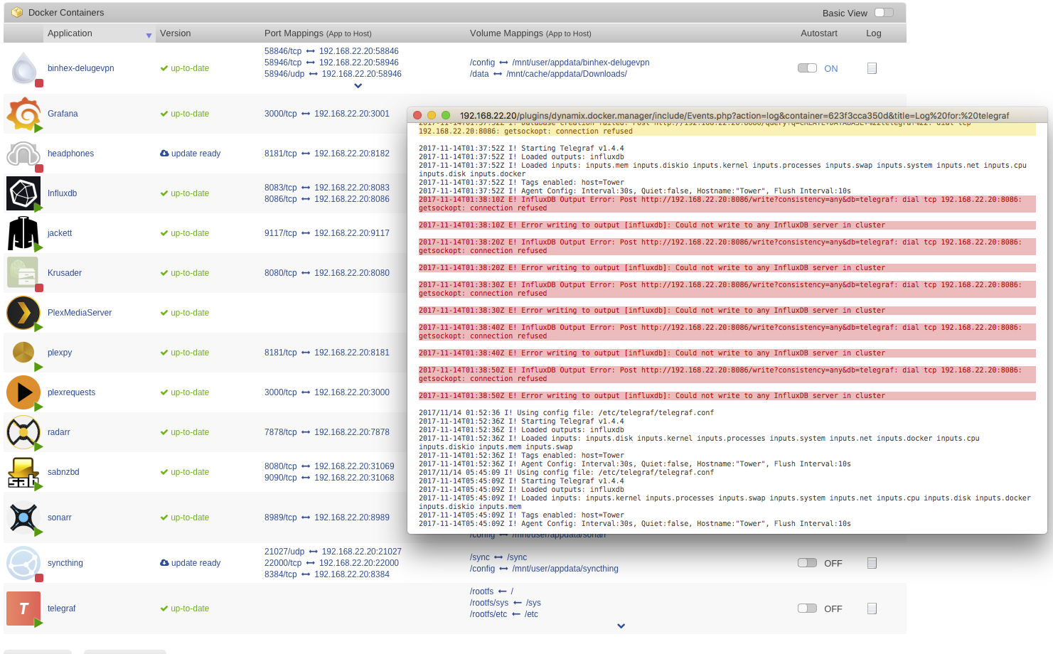

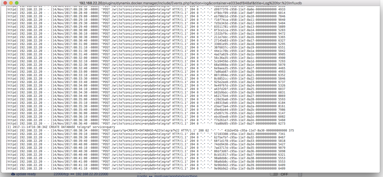

Not sure what that means.  Log files for Grafana, influxdb and telegraf all seem to be pumping data.  I've attached some screenshots.  I do see an error with influxdb in the telegraf logs, but googling it has found nothing that I can make heads or tails of.

never mind... blew everything away, re-did all settings and noticed I missed the port by one number... 8006 =/ 8086

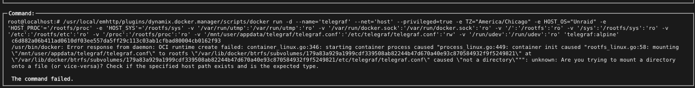

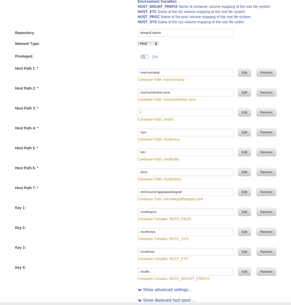

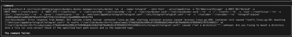

I tried to follow your tutorial and I am stuck trying to install telegraph. I am currently running unraid 6.8.2 . I have tried everything changing the network type , editing the host file.change the console shell command and also changing the paths to a folder inside appdata. no matter what I do it still gives me the same error on the picture below.
1980957140_ScreenShot2020-12-10at3_03_32PM.thumb.png.c74ae2490317e3c31e7c7edec4ab0565.png873235879_ScreenShot2020-12-10at3_01_55PM.thumb.png.5719a2071653abb956fbff214dbefc6b.png

17 minutes ago, pfckiko said:
on a side note i found this docker testdasi/grafana-unraid-stack:stable-amd64 has any used it before?
Yes, I am using it as are many others.  It makes setup of the three containers a piece of cake and also includes Promtail and Loki pre-installed/configured.
I personally found this MUCH easier than trying to configure all of them separately.  This should not be intended as a knock on any other containers or solutions.  It is just my personal experience.

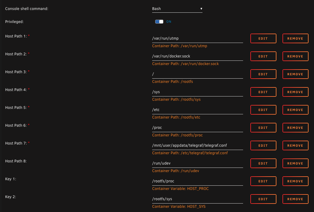

Were you ever able to solve this?  I am stuck at the exact same point
The top of the config page:
This version of telegraf requires you to manually place a config file at /mnt/user/appdata/telegraf/telegraf.conf The container will not start without it.
