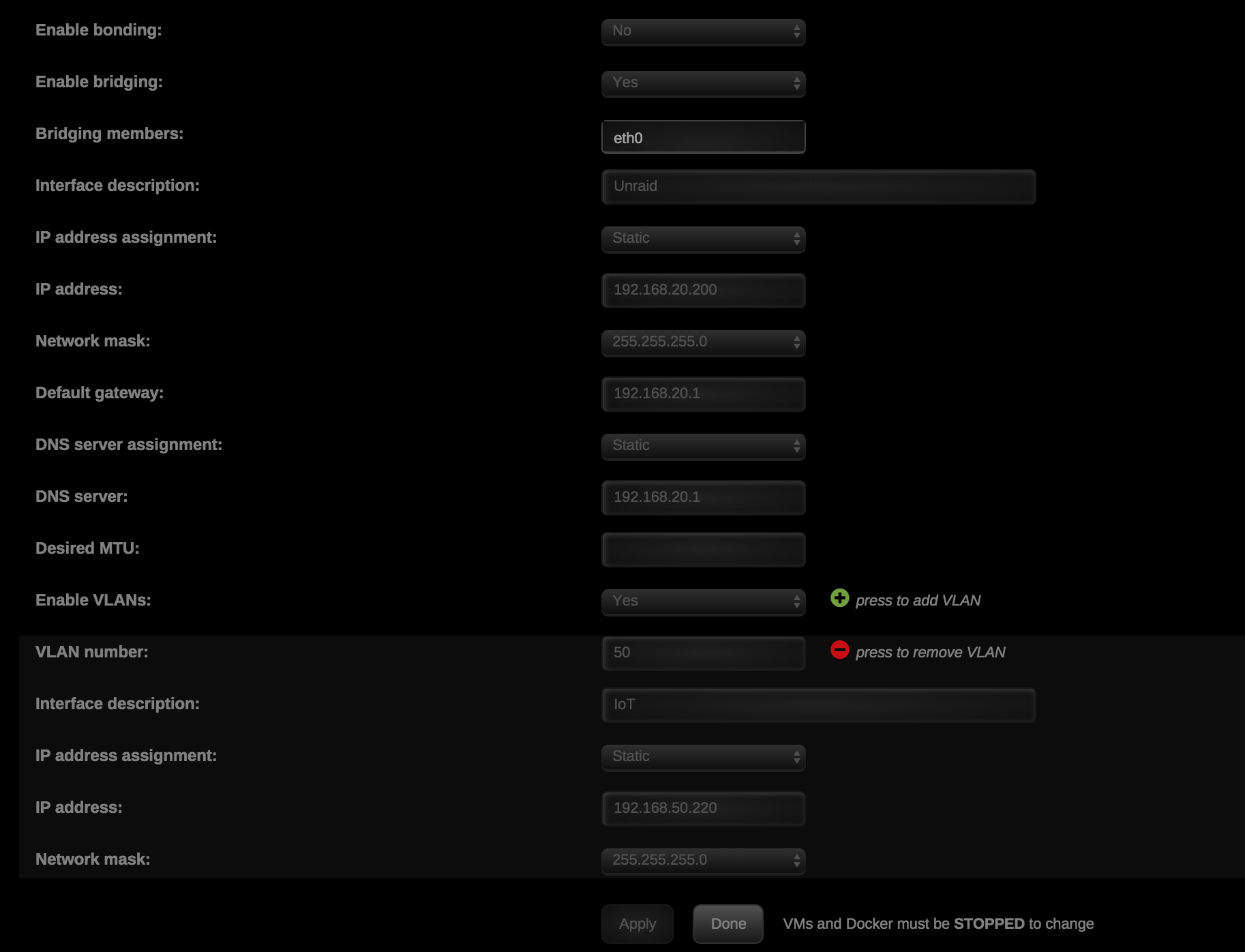

Here is what I have, I'm still having issues. I have one interface but have the second vlan. I have the vlan connected to the vlan and it gets a correct ip (128.168.50.x) BUT when I'm connected to that same vlan I can get to unraid via that ip and it causes when I try to access the VM. If I'm on a different vlan (20) I can access the vm just fine. Not sure if it's an unraid issue or vlan issue, or both.
let me get this straight.
you have 2 vlans 20 and 50
unraid is plugged into vlan 20 (default untagged) and have vlan 50 (tagged)
you have bridging so your VM should be connected to br0.50 network
you can access unRAID @ 192.168.50.220 while on vlan 50
you can access unRAID @ 192.168.50.220 while on vlan 20
you can access unRAID @ 192.168.20.200 while on vlan 20
you can access unRAID @ 192.168.20.220 while on vlan 50
you can access the VM (ie 192.168.50.100) while on vlan 20
but you can't access the VM @ 192.168.50.100 while on vlan 50?
Yes
you can access unRAID @ 192.168.50.220 while on vlan 50  Yes
you can access unRAID @ 192.168.50.220 while on vlan 20  Yes
you can access unRAID @ 192.168.20.200 while on vlan 20  Yes
you can access unRAID @ 192.168.20.220 while on vlan 50  Yes
you can access the VM (ie 192.168.50.100) while on vlan 20  Maybe this is my problem, the VM IP is 192.168.20.220.

Wait the VM IP is 192.168.20.220 (matches unRAID IP) on VLAN 50. that's a whole bunch of wrong...
in any case if there is no L3 router between the two VLANs, you can't access VLAN 20 stuff from VLAN 50 and vice versa.
you could have made the VM have two vNICs and connect each to a VLAN - no real need to pass through or adding NICs for the matter.

Yeah, they both had the same ip.  :$  pfsense had a static mapping for that mac address so that explains why I was having issues accessing it.
I changed the mapping to another ip and what do you know, it appears to be working as expected! The VM got the new VLAN 50 ip and I can connect to it as expected (only from vlan 50).
Wow, that has caused me hours of headaches thinking it's everything form pfsense to the vlan switch. classic PEBKAC error. :-/
