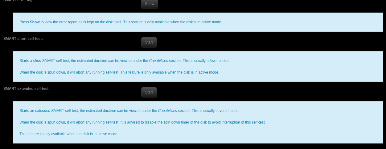

ok YOU have been such a great help. I have the update done but for some reason now this is showing.. all these blue info boxes. Any idea how to turn them off?
Turn the help off.
