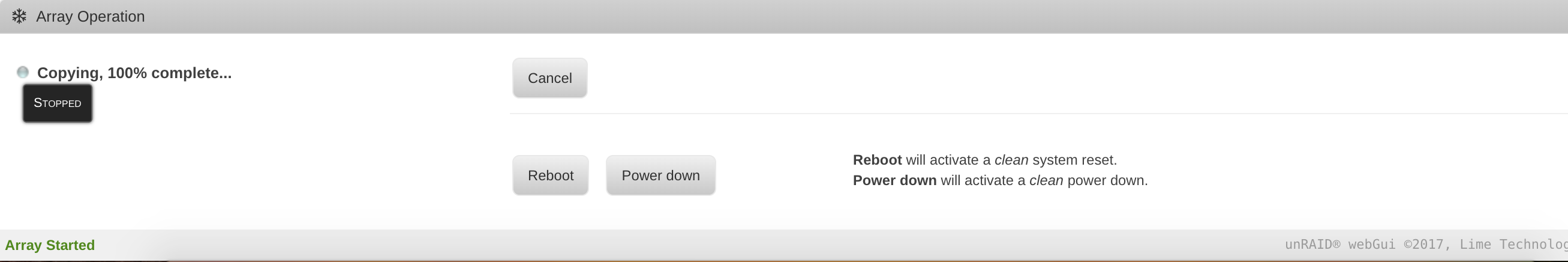

Ok, i followed the process.   Now, I’m at a Copying 100% since a while.... (1 hour on the 100%), hoving over the 100% say that it is not running.  I have a “cancel” button.
the disk do not anymore display a blue icon and I haven’t regain control to be able to start the rebuild.
Also, the array is displayed as « off-line » at the top , but the status bar mention « array started » in green and drive (the old parity that is now in the bad disk location) still says that the content is emulated...
so, do I have to Click on « cancel » then start the array to star the rebuild even if it still say it is copying?
the new parity 1 is a 5TB and old was a 5TB, maybe the 100% complete was the first 5TB and now doing something with the remaining 1TB?
please advise what I should do now?

After the copy is done it will zero the rest of the new parity disk, the array will stop when it's done.
How long it could take ?  If the whole copy took 13 hours for a 5TB,  Should I calculate 1/5 of 13 hours for the 1TB of free space?
I checked and it stil show "Copying, 100% completed" since 12h15pm (about 5 hours ago).  Since there is no progress on this part, is there a way to check how long it will take ?  I suspect it shouldn't be that long to just zeroed 1TB...

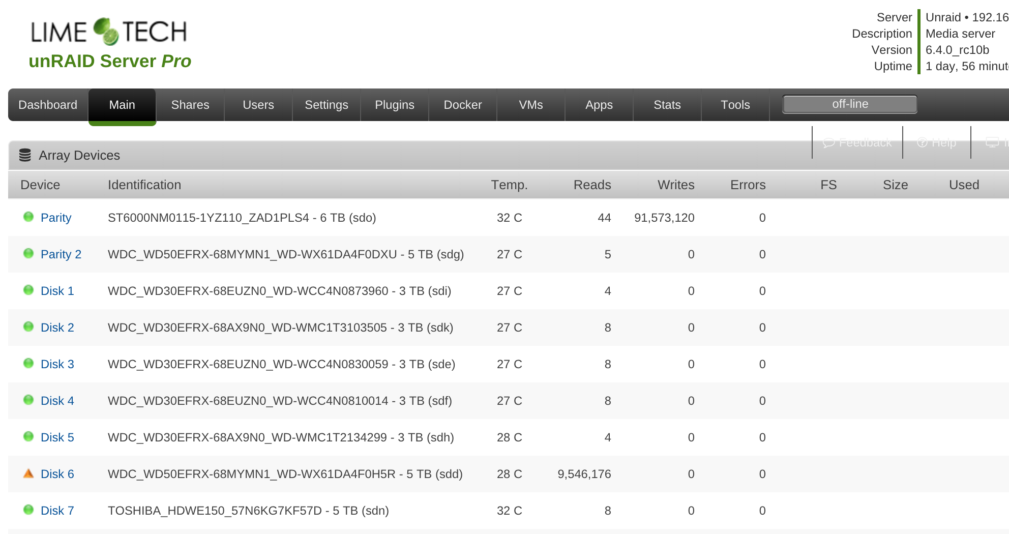

I tried the "Cancel" and it did nothing.  At this point, I don't know what I can do!  I need the array online before 7pm when it will be needed!
@johnnie.black, any instructions for me ? You seem like the pro of those kind of processes...
I added pictures of what I can see.

Post your diagnostics, grab them on the console by typing diagnostics

I found it strange that the previous attempt was so long stuck at 100% so did some testing and there is a bug on the newer rcs with the parity swap procedure if using a cleared disk as the new parity, so it will get stuck again, I recommend you cancel the procedure, downgrade to v6.3.5 and start over.

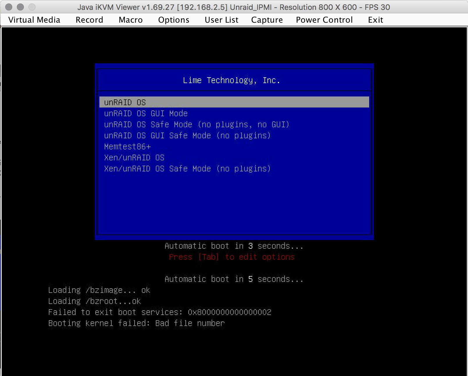

Ok, I tried to downgrade to 6.3.5.  Now, the server doesn't boot at all !!
Here is the screenshot :
Finally, I had to remove the EFI folder from the flash drive, so it is now back on 6.3.5.   I started for the 3rd time the parity swap procedure.  I HOPE to get up tomorrow and be greated by the Stopped Array ready to start the rebuild of the failed drive on the ex-parity drive :)
