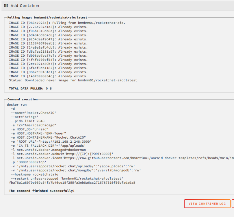

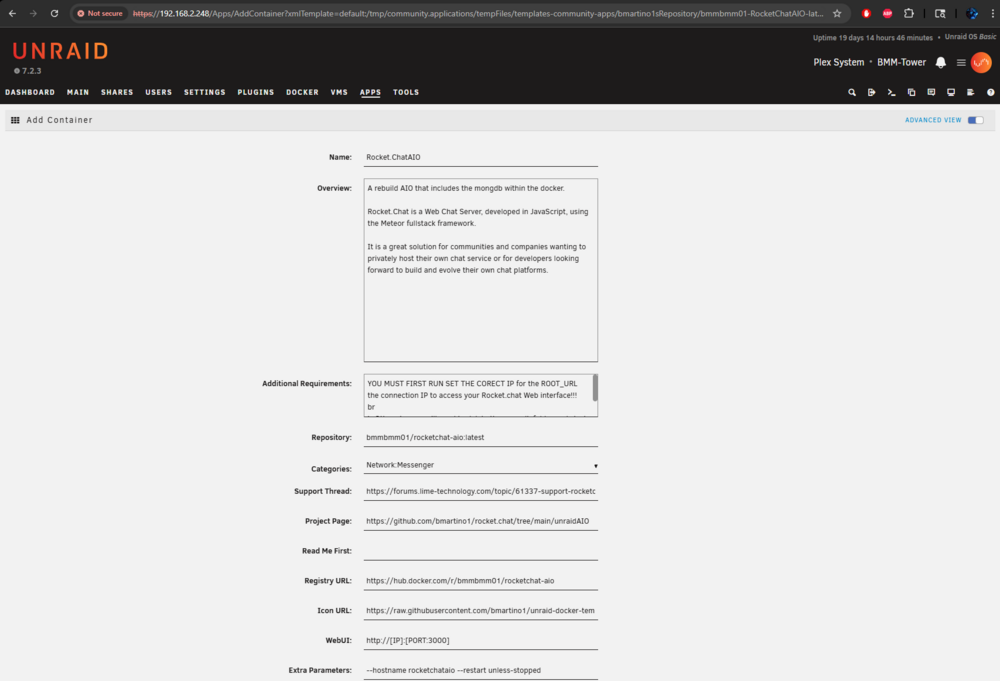

I just finished adding / fixing this to unriad v7 due to some concerns to run a discord like chat...

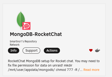

I just updated and added the Maintainers official dockers to the Unraid CA.
and
I decided to go host for database, as that is my norm when running database on unraid...
I decided to go custom ipvlan/macvlan for rocket chat.
or you can go with rocket.chat docker compose...
with the docker compose plugin...
https://docs.rocket.chat/docs/deploy-with-docker-docker-compose
Please install the MongoDB-Rocketchat as this will install v6 of mongo that is compatabile with latest server version per their github./docs..

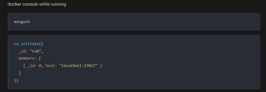

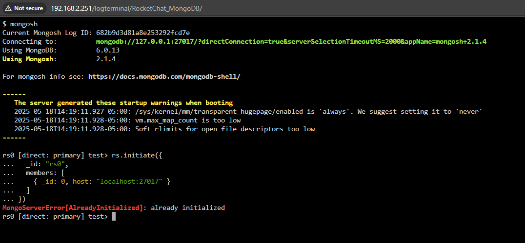

rare as mong can silety fial check docker logs... May need mong comand run to make sure its inatlized...
docker console while running
mongosh
rs.initiate({
  _id: "rs0",
  members: [
    { _id: 0, host: "localhost:27017" }
to fix any initialization issues...

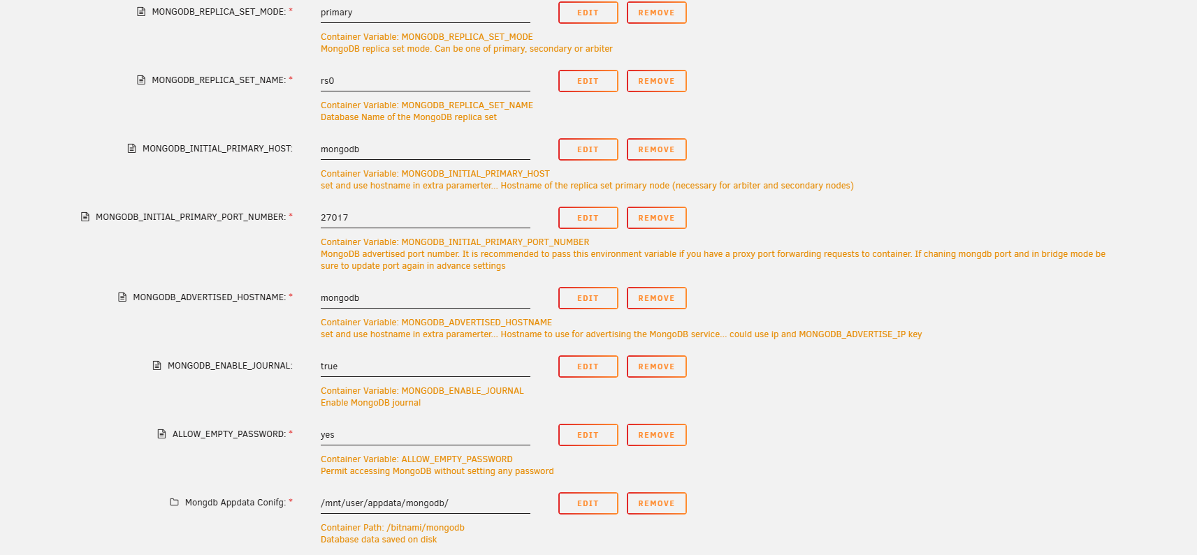

if you want a passwrod protected mongdb then you will need to add 2 key variables
so at bottom of template add:
MONGODB_ROOT_PASSWORD
and
MONGODB_REPLICA_SET_KEY
and updating your 2 keys in the rocketcaht docker to conect to the mongodb

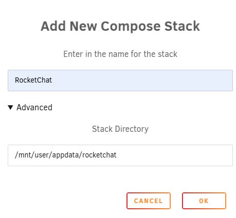

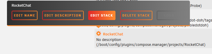

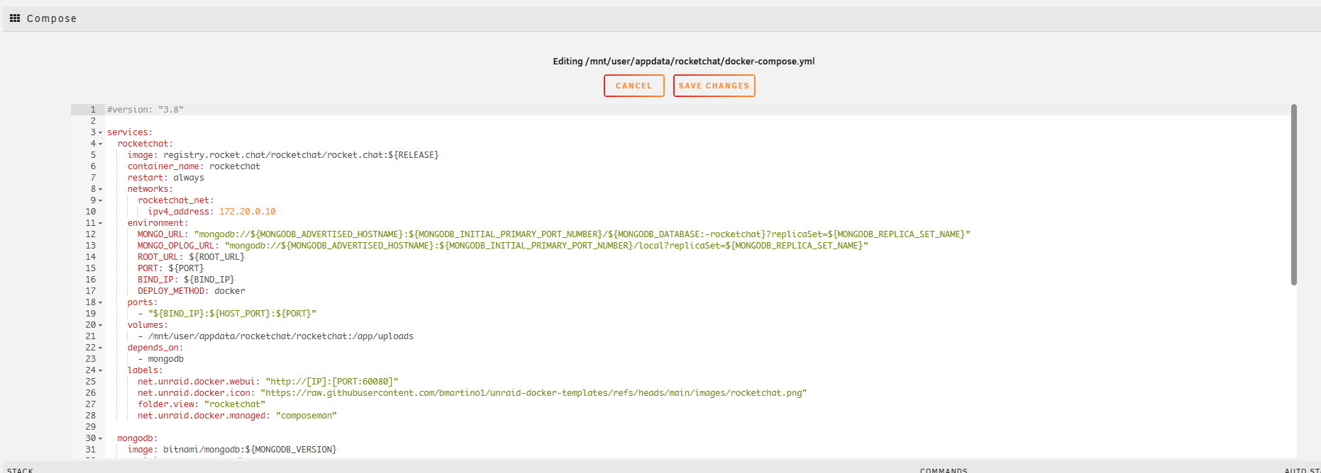

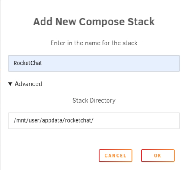

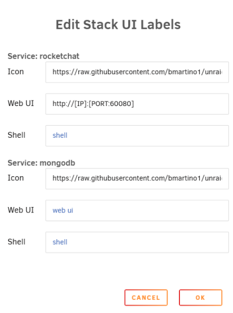

step 2 make a new stack.
set a name and chose /mnt/user/appdata/rocketchat as the location for the env / docker compose file to exist.

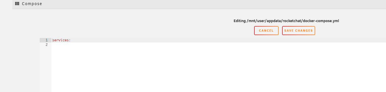

step 3 edit the stack
*This will use a env file and a copose file...
Compose file:
Foling the rocket.chat maintainers.. https://docs.rocket.chat/docs/deploy-with-docker-docker-compose
new forum made it harder to do iline past of code... code link auto braek yaml syntaxing....
-As unraid has some small edits and feature that are nice in a compose for unraid... web ui, pictures at top, autofill icons adn web ui.... etc...
save the compose and hit ok
-Note with the unraid updated compose edits, the data is already filled in for you...
This compose will auto make a new docker network bridge I've set the port to be unraid ip at port 60080 to no cause conflicts with other existing dockers...
<inline code of compose file (may now be an attachment moving forward as I don't get the box before hand anymore>

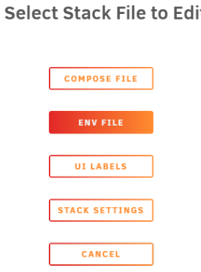

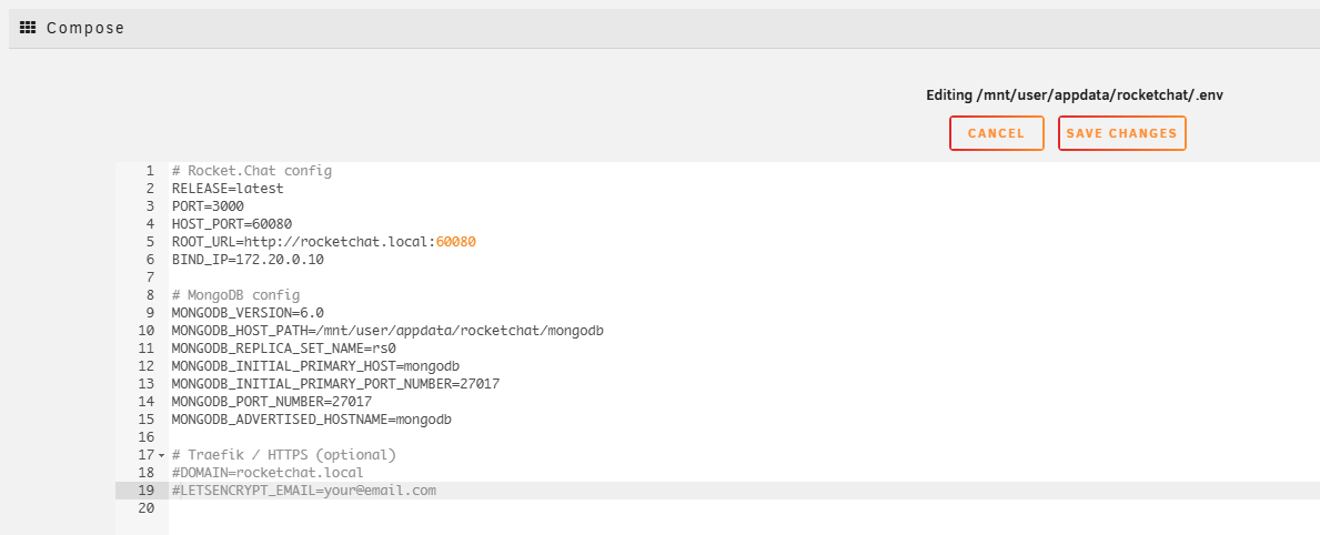

We also have a ENV file we need to use... not the comose is calling info and not actually filled in.... the env file has that data...
so edit stack env file...
Here is where we can change and set data such as the ports hostname and compose environment variables called in the docker compose file...
<inline code of ".env" file (may now be an attachment moving forward as I don't get the box before hand anymore>

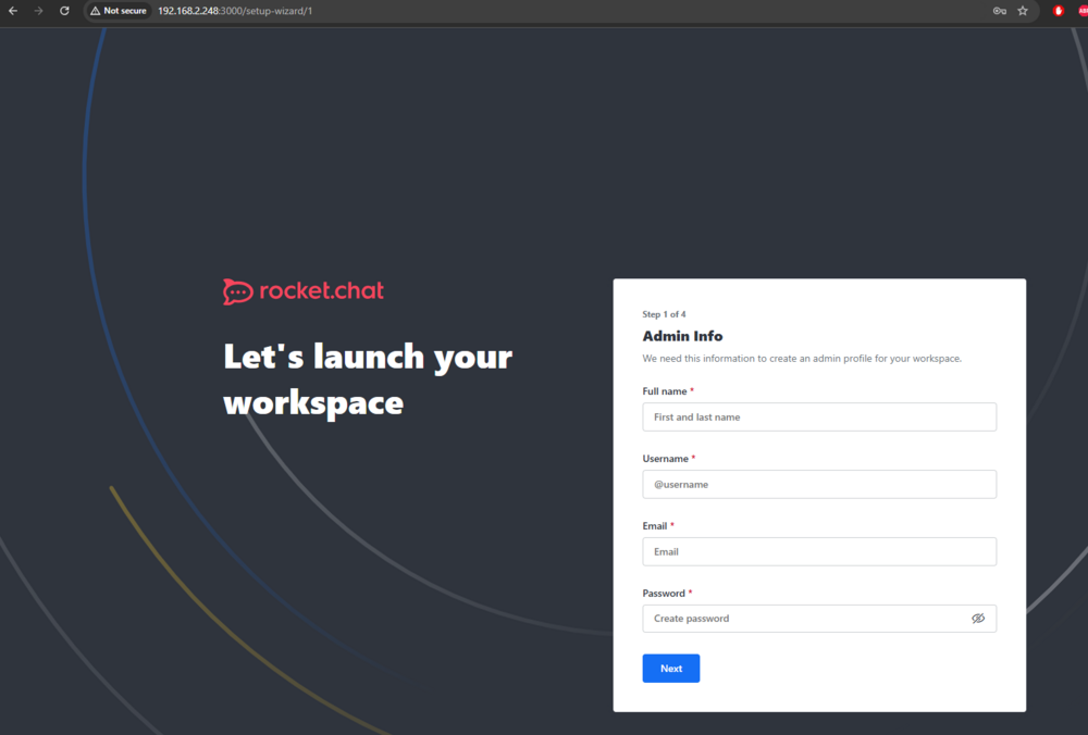

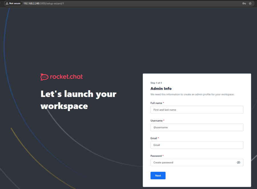

with that saved... we are now ready to compose up and start the docker...

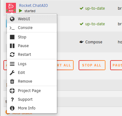

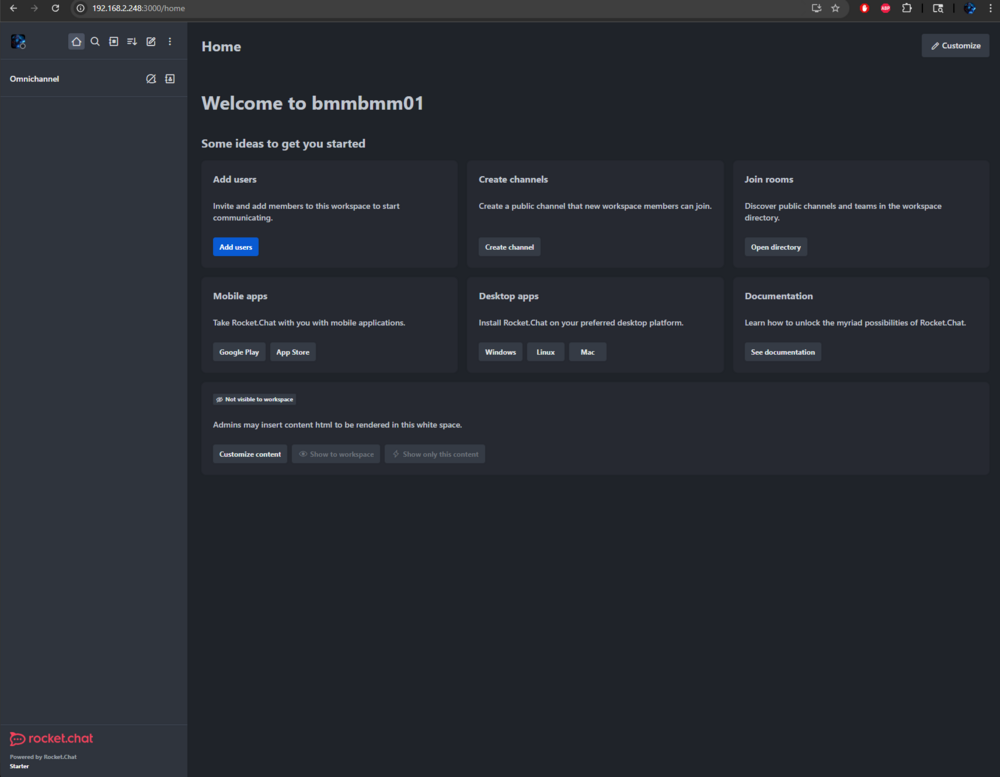

you will now see 2 docker at the top in the docker tab of the web ui...

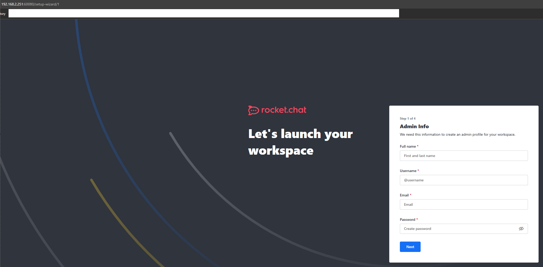

go to the web ui and complete your first time configurations...

env file
# Rocket.Chat config
RELEASE=latest
PORT=3000 # Port inside container
HOST_PORT=60080 # Port exposed on Unraid host
BIND_IP=0.0.0.0 # Bind to all interfaces (or Unraid host IP if preferred)
ROOT_URL=http://rocketchat.local:60080
# MongoDB config
MONGODB_VERSION=6.0
MONGODB_HOST_PATH=/mnt/user/appdata/rocketchat/mongodb
MONGODB_REPLICA_SET_NAME=rs0
MONGODB_INITIAL_PRIMARY_HOST=mongodb
MONGODB_INITIAL_PRIMARY_PORT_NUMBER=27017
MONGODB_PORT_NUMBER=27017
MONGODB_ADVERTISED_HOSTNAME=mongodb
# Traefik (optional)
#DOMAIN=rocketchat.local
#[email protected]

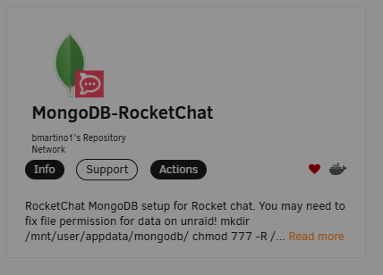

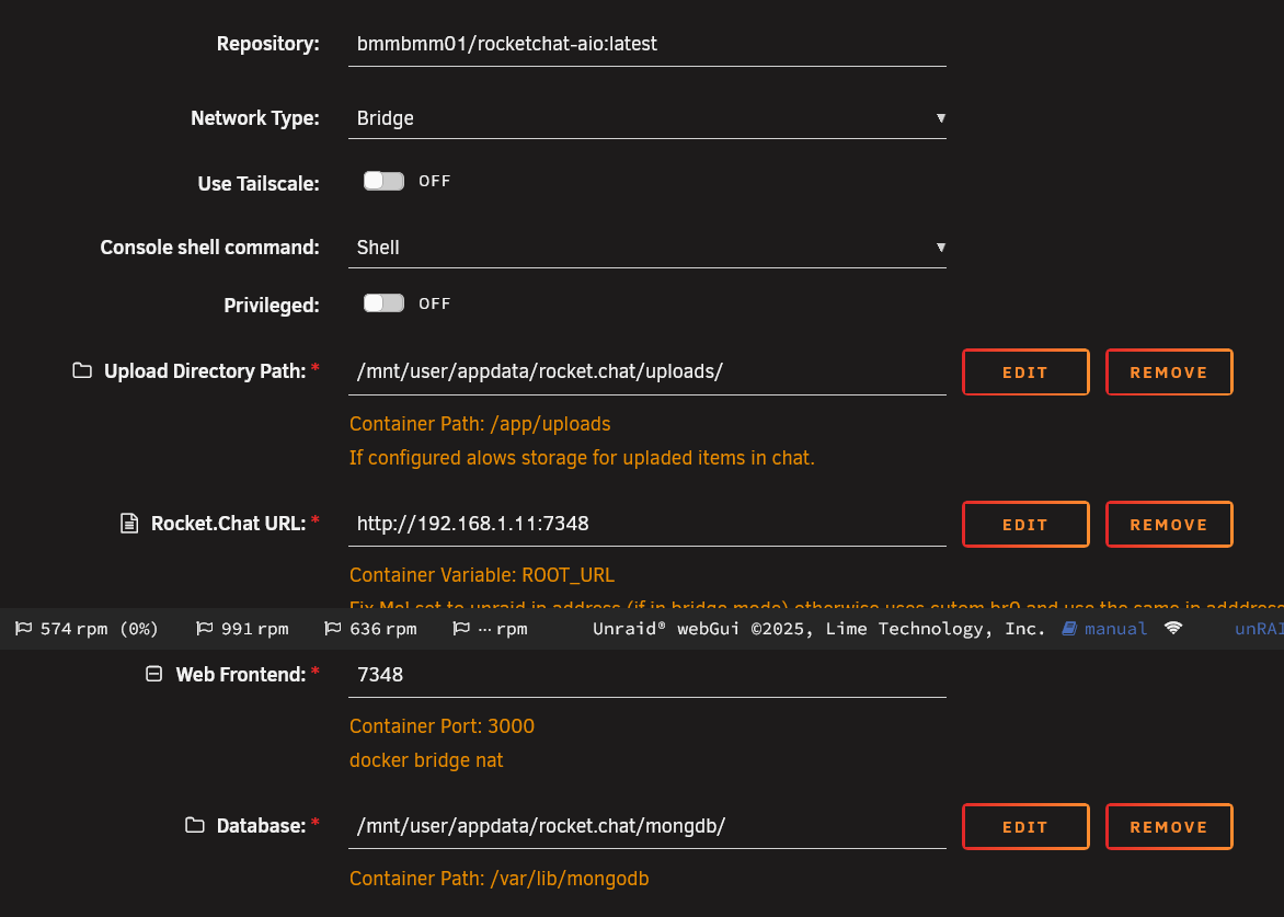

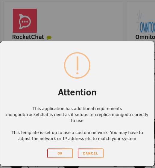

so in order to use the CA over the docker compose. as mentioned above.
step 1
go to the unraid CA and install the mongdb maintainers docker image...
note the requirement!
as there are some small hiccups to make a template for all following the CA best practices guide.
I chose to use docker network host... as seen in the compose able that used docker bridge... You can use bridge, custom ip with the macvlan/ipvlan ip etc...
Just not this may change ip/hostname needed latter that is needed to make the rocket.chat dockers mongo database connection...
I went with host to guarantee a ip for documentation as i will use unraids IP in my case my unraid is static set to 192.168.2.251
this means this docker when installed will be at 192.168.2.251 at its database port the container is running by default mongodb uses port 27017 this port can be changed with docker variables as other docker stack may already have a MongoDB running for other..
So I have to make large assumptions when making CA apps to make one click install and it works for others... This may also go against the best security practices as usually you would set a root mongdb password which would change the mongdb line need to connect to the mongdb with in the rocket.chat database...

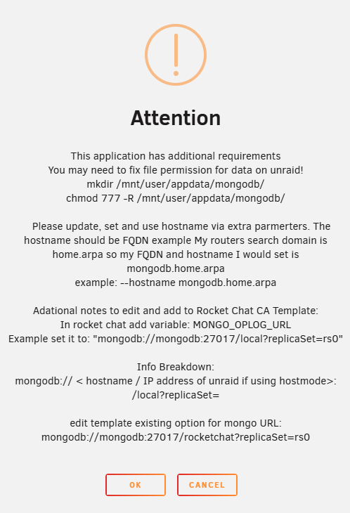

PLEASE READ! and follow the guide or not at all Your mongdb connection have been outlined for a quick overview, not how you should connect to it between dockers! You have been warned!!!
As explained above its best to add additional docker variables and turn off passwordless connection to MongoDB. due to guide write ease of 1 click, I will not go over that... go ask ai if you need help construing your network and MongoDB connection... It's explained in rocket chat docs and noted in the additional requirement breakdown!
Now that the acknowledgement and warning is out of the way...

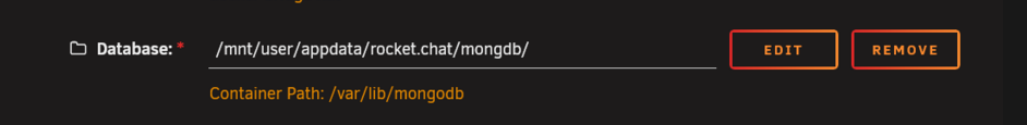

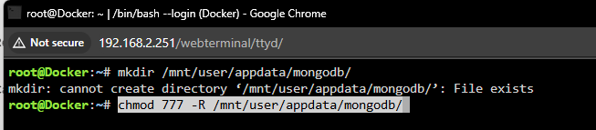

There is a semi know issue with creating a mongdb. Assuming unraid default data path /mnt/user/appdata<docekrname>
Their is a appdata path in the template, and we need to make and fix file permission otherwise the docker log will error permission error
mkdir /mnt/user/appdata/mongodb/
chmod 777 -R /mnt/user/appdata/mongodb/
so we need to open the web terminal inside the docker following the additional requirements!
this will fix the permission issue setting the unriad docker default permission

the hostname should be a FQDN in my case my FQDN would be mongodb.home.arpa
due to tailscale some docker may require additional internet dns to connect and access resources. so I added the hostname and dns options to the extra parm
They are optional as in the end I prefer static IP and to know that If i go this ip i reach this docker/services...
Note the template is set to use this as the default hostname for other variables...
we are using bitnami mongdb docker image
https://github.com/bitnami/containers/tree/main/bitnami/mongodb
Additional docker variable to set mongdb setting exist. as the other mongdb dockers have issue making the database need for rocket.chat to run...
the unraid CA template ships with a passwordless setup... As I'm just converting the working docker compose into a Docker run CLI and using the unraid docker template to construct the docker cli to make the docker and function...

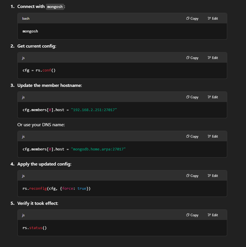

NOTE the extra parm hostname IF that is changes (AND IT SHOULD!) you need to update the hostname in the template options...
so I would set initial primary host and advertised hostname to mongodb.home.arpa my FQDN for my network ... some default would be generated by your router and could be .local, .localdomain, .lan....

as mentioned earlier in the forum sometimes even with these setting you will get a error database not initialized. Yellow text will keep spamming the log...
so you will need to force a initialization
with the database initialized... green /white text log not being spammed and stops... the docker is full functional and ready to connect...

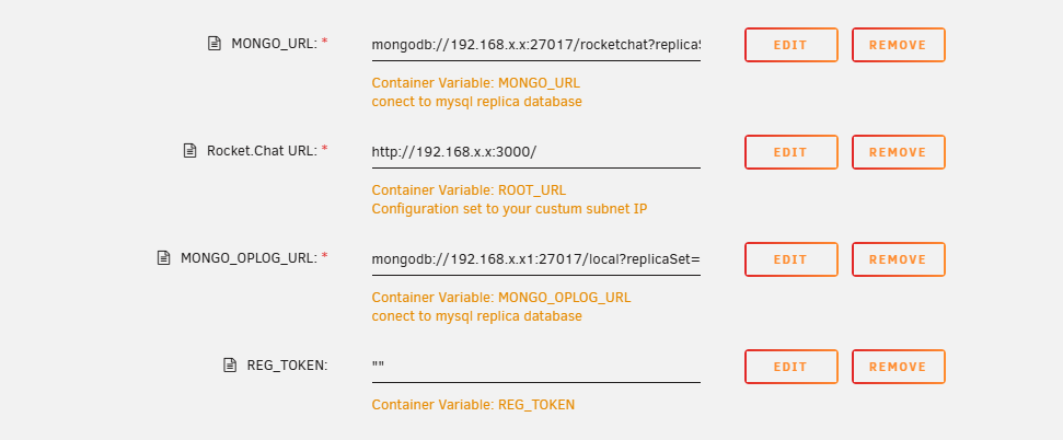

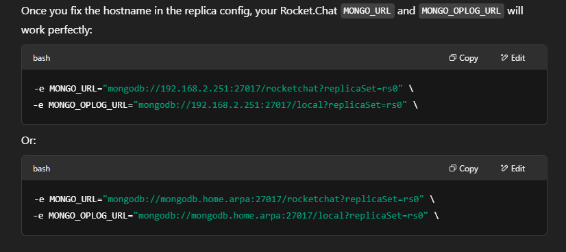

we have 2 mongodb url that need constructed for rocket chat..
MONGO_OPLOG_URL with no template changes would result in a connection line of mongodb://mongodb:27017/local?replicaSet=rs0
and
mongo URL with no template changes would result in a connection line of mongodb://mongodb:27017/rocketchat?replicaSet=rs0
Info Breakdown example:
mongodb:// hostname / IP address of unraid if using hostmode: /local?replicaSet=
so my connection line is
mongodb://192.168.2.251:27017/rocketchat?replicaSet=rs0
as its all about getting this mongdb and how you can conect to the MongoDB within rocetchat!
so now that you have a running instance of mongdb setup and running, lets look at the rocket chat CA
with advance togle note the extra parm... These are optional but are needed for use with tailscale and helps with root URL
I decided to go custom br0 so I set lan idenity this mean rocekt chat will be at 192.168.2.240 so I can port forward, tailscale, and easily port forward rocket chat for public use if needed... also helps set lan identity for reverse proxies such as nginx proxy manger...
you will note 192.168.x.x
THIS IS ON PURPOSE!
As you need to fill in the necessary data...
so mongo for me is my unraid ip 192.168.2.251
rocket chat url will become 192.168.2.240
red token if you went paid for other features... first startup with making admin account will also go over other setting and configurations..
its all on how you setup your docker networks to have dockers talk...
review the post i made on the different docker networks:
https://forums.unraid.net/topic/188695-docker-network-issue/#findComment-1541042
review the rocket.chat doc...
https://docs.rocket.chat/docs/mongodb-configuration
and to watch the github and rocket.chat upgrade cycle
https://docs.rocket.chat/docs/supported-mongodb-versions
Currently, rocket chat v7.3 is compatible with mongdb v6
I can't make it any simpler it all on how you setup your docker networks and build your mongdb connection line...
Please read the DOCs: https://docs.rocket.chat/docs/mongodb-uri-authentication
so mongdb may need some console commands to get working...
first initalize the mongdb
while runnign console into the mong db docker:
mongosh
rs.initiate({
  _id: "rs0",
  members: [

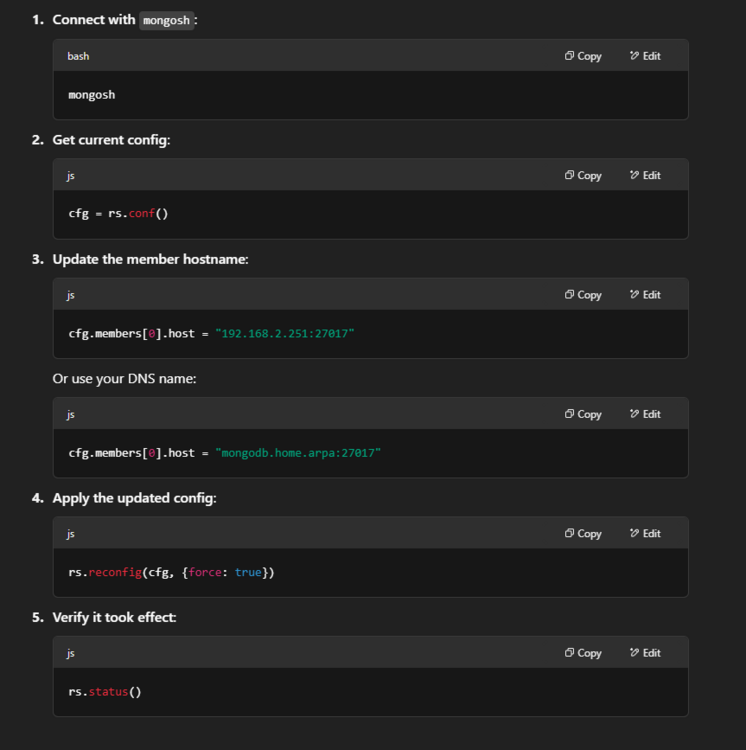

then giving that i'm going hostname/ip we may need to tell the database to use the ip and/or hostname...
IN my example I'm using a docker custom bridge ip so i'm static set rocket.chat to 192.168.2.240
I need to allow the mongdb to connect via the ip
this makes the URL and oplogURL to this
so lets fix the mondb and edit the config...
docker console comands set to your ip!
mongosh
cfg = rs.conf()
cfg.members[0].host = "192.168.2.251:27017"
rs.reconfig(cfg, {force: true})
rs.status()
then update your temapte rocket.chat mongo URL lines
MONGO_URL
MONGO_OPLOG_URL
mongodb://192.168.2.251:27017/local?replicaSet=rs0

its easier to use a compose for this....
Volume bind mount needs folder to exist first.
mkdir -p /mnt/user/appdata/rocketchat/mongodb
Compose file
#version: "3.9"
services:
  rocketchat:
    image: ${IMAGE:-registry.rocket.chat/rocketchat/rocket.chat}:${RELEASE:-latest}
    restart: always
    depends_on:
      - mongodb
    environment:
      ROOT_URL: ${ROOT_URL:-http://localhost}
      PORT: ${PORT:-3000}
      DEPLOY_METHOD: docker
      DEPLOY_PLATFORM: compose
      # REG_TOKEN is optional for Cloud registration; leave blank if not using
      REG_TOKEN: ${REG_TOKEN:-}
      # Required: MongoDB RS connection string
      MONGO_URL: ${MONGO_URL:-mongodb://mongodb:27017/rocketchat?replicaSet=rs0}
      # No TRANSPORTER set => monolith mode (no NATS)
    ports:
      - "${BIND_IP:-0.0.0.0}:${HOST_PORT:-3000}:${PORT:-3000}"
    labels:
      net.unraid.docker.webui: "http://[IP]:[PORT:3000]"
      net.unraid.docker.icon: "https://raw.githubusercontent.com/bmartino1/unraid-docker-templates/refs/heads/main/images/rocketchat.png"
      folder.view: "rocketchat"
      net.unraid.docker.managed: "composeman"
      #"com.centurylinklabs.watchtower.enable=true"
    networks:
      - rocketchat
  mongodb:
    image: docker.io/bitnami/mongodb:${MONGODB_VERSION:-6.0}
    restart: always
    environment:
      # Single-node replica set so Rocket.Chat can start
      MONGODB_REPLICA_SET_MODE: ${MONGODB_REPLICA_SET_MODE:-primary}
      MONGODB_REPLICA_SET_NAME: ${MONGODB_REPLICA_SET_NAME:-rs0}
      MONGODB_PORT_NUMBER: ${MONGODB_PORT_NUMBER:-27017}
      MONGODB_INITIAL_PRIMARY_HOST: ${MONGODB_INITIAL_PRIMARY_HOST:-mongodb}
      MONGODB_INITIAL_PRIMARY_PORT_NUMBER: ${MONGODB_INITIAL_PRIMARY_PORT_NUMBER:-27017}
      MONGODB_ADVERTISED_HOSTNAME: ${MONGODB_ADVERTISED_HOSTNAME:-mongodb}
      MONGODB_ENABLE_JOURNAL: ${MONGODB_ENABLE_JOURNAL:-true}
      # For quick start; replace with proper root/password secrets later
      ALLOW_EMPTY_PASSWORD: ${ALLOW_EMPTY_PASSWORD:-yes}
    volumes:
      - mongodb_data:/bitnami/mongodb:rw
    ports:
      - "${MONGODB_BIND_IP:-127.0.0.1}:${MONGODB_PORT_NUMBER:-27017}:${MONGODB_PORT_NUMBER:-27017}"
    labels:
      net.unraid.docker.icon: "https://raw.githubusercontent.com/bmartino1/unraid-docker-templates/refs/heads/main/images/rocketchatmongo.png"
    networks:
      - rocketchat
networks:
  rocketchat:
volumes:
  # Unraid bind mount into appdata
  mongodb_data:
    driver: local
    driver_opts:
      type: none
      device: /mnt/user/appdata/rocketchat/mongodb
      o: bind
env file:
# Web
#ROOT_URL=http://localhost
ROOT_URL=http://192.168.1.254:3000 #set me to unirad ip address
HOST_PORT=3000
PORT=3000
BIND_IP=0.0.0.0
# Rocket.Chat image
IMAGE=registry.rocket.chat/rocketchat/rocket.chat
RELEASE=latest
REG_TOKEN=
# Mongo connection (single-node RS)
MONGO_URL=mongodb://mongodb:27017/rocketchat?replicaSet=rs0
# MongoDB (bitnami) basics
MONGODB_VERSION=6.0
MONGODB_BIND_IP=127.0.0.1
MONGODB_REPLICA_SET_MODE=primary
MONGODB_ENABLE_JOURNAL=true
ALLOW_EMPTY_PASSWORD=yes
for a quick bare min off and running
and
You will need to wait and make sure mongdb is full initialized.
It is best to add a replica key and or add a mongdb root password.
(my template ships with a password less) enviroment variables on in the overview and additional requirements!
it more getting the mongdb connection line in rocket chat...
mongosh
rs.initiate({
  _id: "rs0",
  members: [
and
Tying to make it as close to a one click install and workig out of the box as possible
as the other mongdb ca required other stuff to make it function with rocket chat now.

10 hours ago, bmartino1 said:
I've just updated the templates and some work to make a rocket.chat and mongdb AIO all in one tempate for unraid for easy 1 click run and install
this is due to issues with setting up the mongdb database that is needed for rocket.chat.
I would still recoend running your own mongdb and the rocket.chat docker.
https://github.com/bmartino1/rocket.chat/tree/main/unraidAIO
Im having issues getting this running. I have attached my install settings. When I try to open up the logs it just opens and closes right away. Here is the logs when I access them via SSH. I also noticed that the mongo folder has nothing it in (Appdata).
root@Klauss:~# docker logs Rocket.ChatAIO
[AIO] Starting MongoDB...
about to fork child process, waiting until server is ready for connections.
forked process: 15
ERROR: child process failed, exited with 1
To see additional information in this output, start without the "--fork" option.
forked process: 13
forked process: 14
forked process: 14
forked process: 14
forked process: 14
forked process: 14
forked process: 14
forked process: 13
forked process: 14
forked process: 13
forked process: 14
forked process: 14
forked process: 14

Here are my container settings.
read the adational notes. you ran somting inteh continer. this works out of the box...
you dind't set teh corect chat url at first run anda fo bared the mongo db you MUST DELTE THE FOLDER and let the AIO mange Mongdb...
YOU MUST FIRST RUN SET THE CORECT IP for the ROOT_URL the connection IP to access your Rocket.chat Web interface!!!
Otherwise you will need to delete the mongdb folder and start again!
using bridge: image.png i use my unraid ip: image.png
so you messede up as it writes the root url for guarantee connections...
I prefer to manualy make my directory before hand know where the data is stored...
root@BMM-Tower:/mnt/user/appdata# mkdir -p /mnt/user/appdata/rocket.chat/mongdb/
root@BMM-Tower:/mnt/user/appdata# ls /mnt/user/appdata/rocket.chat/mongdb/

thats it finish the wizard and setup for rocket chat...
I can't make it any easier... Iv'be seen no other mongdb issues and a problem after wizzard setup to use the platform... full features require paid support form rocket.chat...
so i can only asume you have fubared your database:
so you must deelte this folder and start again...
I can manually reproduced due to contains restart and how mongdb loads slower then rocket.chat I am implementing a fix to the docker image atm.

Example of a working AIO instance after final testing and data pushed:
Docker log example:

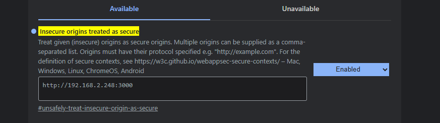

chrome://flags/#unsafely-treat-insecure-origin-as-secure
I highly recommend deleting the mongdb folder and try again with the latest pushed docker tag image. Future updates / Release should not require the mongdb to be deleted.
Edited by bmartino1
tests where with google chrome the setup wizard and registration worked flawlessly...
once you use the docker webui option and sucesfuly register your workspace

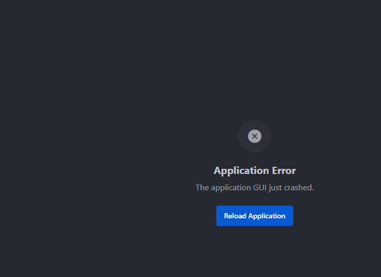

this is a https crypto issue due to changes in the rocket.chat code.
otherwise use in conjunction with a reverse proxy and update your Root_URL!
Edited by bmartino1

so here is a all in one unraid ready comopse file pulling rocket.chats copsoe files.
Directory Layout (Recommended)
rocketchat-unraid/
├── compose.yml
└── .env
Unraid Compose Manager works best when everything is flat.
docker-compose.yml (Unraid-ready)
version: "3.8"
services:# =====================================================# NATS# =====================================================nats:
    image: docker.io/nats:${NATS_VERSION:-2.11-alpine}
    container_name: rocketchat-nats
    restart: unless-stopped
    command: --http_port 8222
    ports:
      - "${NATS_BIND_IP:-127.0.0.1}:${NATS_PORT_NUMBER:-4222}:4222"
    labels:
      net.unraid.docker.webui: ""
      net.unraid.docker.icon: "${UNRAID_ICON}"
  # =====================================================# MongoDB (Replica Set – auto-initialized)# =====================================================mongodb:
    image: docker.io/bitnamilegacy/mongodb:${MONGODB_VERSION:-6.0}
    container_name: rocketchat-mongodb
    volumes:
      - /mnt/user/appdata/rocketchat/mongodb:/bitnami/mongodb
    environment:
      MONGODB_REPLICA_SET_MODE: primary
      MONGODB_REPLICA_SET_NAME: rs0
      MONGODB_PORT_NUMBER: 27017
      MONGODB_INITIAL_PRIMARY_HOST: mongodb
      MONGODB_INITIAL_PRIMARY_PORT_NUMBER: 27017
      MONGODB_ADVERTISED_HOSTNAME: mongodb
      MONGODB_ENABLE_JOURNAL: "true"
      ALLOW_EMPTY_PASSWORD: "yes"
    ports:
      - "${MONGODB_BIND_IP:-127.0.0.1}:27017:27017"
    labels:
  # =====================================================# Rocket.Chat# =====================================================rocketchat:
    depends_on:
      - mongodb
      - nats
    environment:
      ROOT_URL: ${ROOT_URL:-http://192.168.2.42:3000}
      PORT: ${PORT:-3000}
      # Mongo
      MONGO_URL: mongodb://mongodb:27017/rocketchat?replicaSet=rs0
      MONGO_OPLOG_URL: mongodb://mongodb:27017/local?replicaSet=rs0
      # NATS
      TRANSPORTER: "nats://nats:4222"
      # Metrics (optional, harmless if unused)
      LICENSE_DEBUG: "true"
      OVERWRITE_SETTING_Prometheus_Enabled: "true"
      OVERWRITE_SETTING_Prometheus_Port: "${METRICS_PORT:-9458}"
    ports:
      - "${BIND_IP:-0.0.0.0}:${HOST_PORT:-3000}:3000"
      - "${BIND_IP:-0.0.0.0}:${METRICS_PORT:-9458}:${METRICS_PORT:-9458}"
    volumes:
      - /mnt/user/appdata/rocketchat/uploads:/app/uploads
    labels:
      net.unraid.docker.webui: "http://192.168.2.42:${HOST_PORT:-3000}"
Minimal .env (Recommended)
# Rocket.Chat
RELEASE=latest
ROOT_URL=http://192.168.2.42:3000
HOST_PORT=3000
PORT=3000
BIND_IP=0.0.0.0
REG_TOKEN=
# MongoDB
MONGODB_VERSION=6.0
# NATS
NATS_VERSION=2.11-alpine
NATS_PORT_NUMBER=4222
NATS_BIND_IP=127.0.0.1
# Metrics (optional)
METRICS_PORT=9458
# Unraid
UNRAID_ICON=https://raw.githubusercontent.com/RocketChat/Rocket.Chat.Artwork/master/Logos/icon.svg
Edited by bmartino1

https://github.com/bmartino1/unraid-rocket.chat
To install and use rocket.chat per the mainteiners... (as I'm at teh will of what they will allow and support!)
git clone https://github.com/bmartino1/unraid-rocket.chat.git \
    /mnt/user/appdata/unraid-rocket.chat
cd /mnt/user/appdata/unraid-rocket.chat
chmod +x setup.sh
./setup.sh
as again I don't have a good way to expalin and edit nor share a good turn key solution to docker stacks that require more then 1 docker and setup instance..
when it is easer to maintin and beter used per teh mainterners recomendation...
so...
