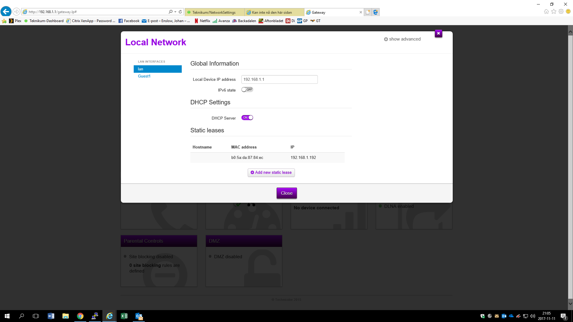

This is my router.

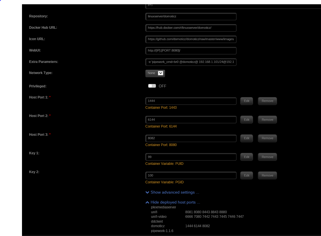

2 hours ago, jofri said:
When i will run https: it will ports conflicts with other containers.
Not if you change the port. Change it to something else than 1443 and you are good to go.
This is the reason you have a host and container port. You keep the container port as is and can change the host port, the one easily edited in the template, to a port not used in another container.
Edited by saarg
A strange thing is that when I change Host port to 1444 i get redirect to unother container:

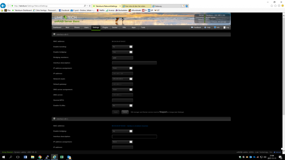

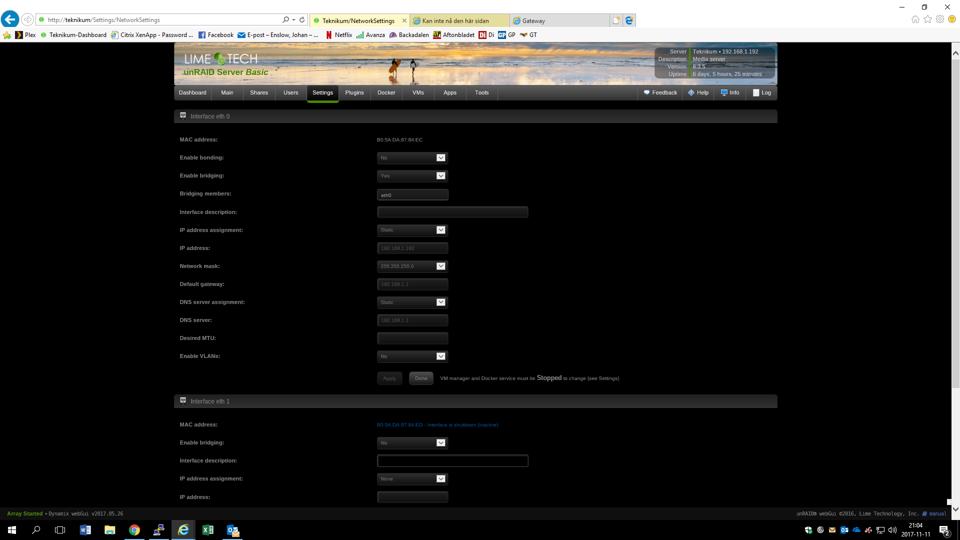

In some guides its says use: 'br0' but my networksetting says eth0.
Which should I choose?

Do you have the pipework Docker installed?  The br0 bridge can be enabled in the Network Settings page in the GUI - set the 'Enable Bridging' to Yes and set the 'Bridging Members' to the interface you intend to use (eth0 as example).  The 'Homenet' thing sounds like part of the manual macvlan method, and if going with pipework, yes remove it.  Install the pipework Docker if not already.  Start it and view the log for it and check the last line of the log has 'started' in it.  Sometimes it will not start and so you stop then start again until the last line shows pipework start.  Pipework should be the running before starting any other Dockers that use it.  PIpework itself requires no configuration.
For each Docker you want to assign an IP for, view the Docker config page and change "Network Type' to 'None'.  In the 'Extra Parameters' box, add the line below, but change the IP addresses for those you are using on your network.  It is set up as [IP of Docker]/24@[gateway address].  The '@CONTAINER_NAME@' needs to be exactly that, do not change it to match the Docker name.  In the example below, the IP of the Docker will be '192.168.1.110' with a Gateway of '192.168.1.1'.

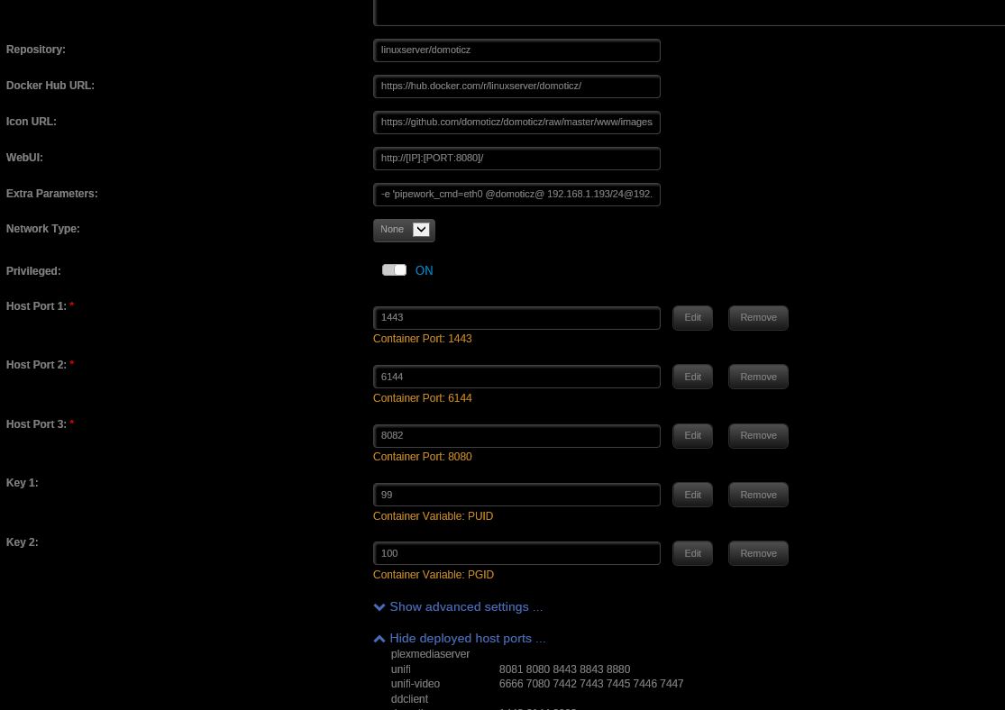

Hi again,
I have now removed the docker network homenet
I have allready installed pipework and its has been started accouring to the logs.
I guess that the dockername should be "domoticz" or nothing else?

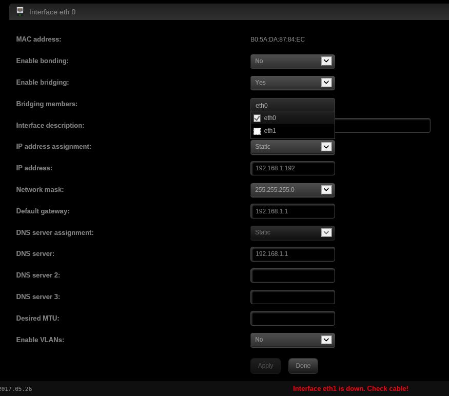

I set the network - set the 'Enable Bridging' to Yes and set the 'Bridging Members' to the interface you intend to use eth0.
The strang this is that when i type in a ip adress like 192.168.1.93 for example. see picture.
 When I start up the domoticz its open my other app unifi controller on ip adress: https://192.168.1.192:8443
Could it be something with the Host port and contaioner port?

6 minutes ago, jofri said:
Hi again,
The '@CONTAINER_NAME@' needs to be exactly that, do not change it to match the Docker name:
-e 'pipework_cmd=br0 @CONTAINER_NAME@ 192.168.1.193/[email protected]'
Whats the different?
/ johan

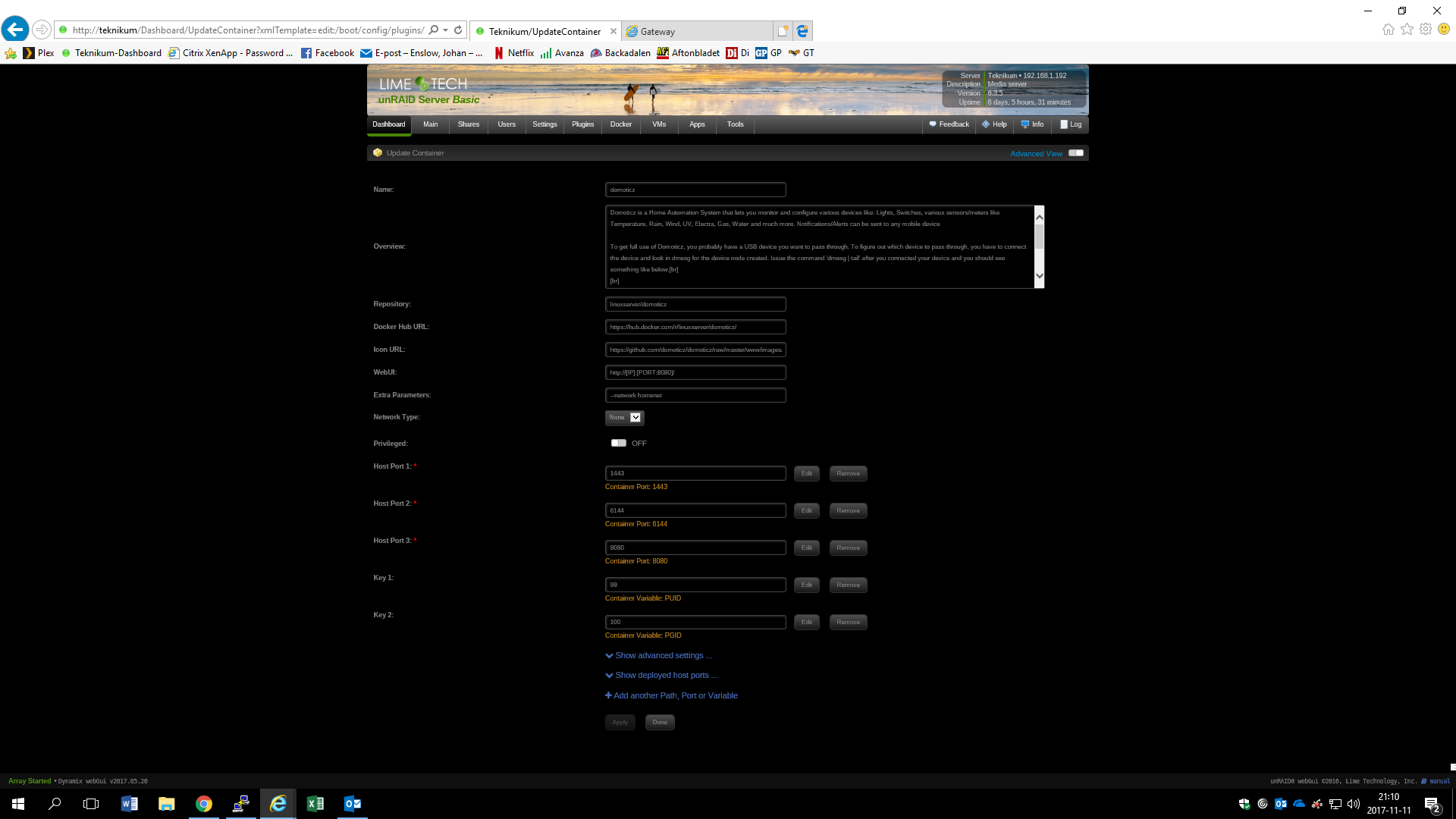

After you correct the container_name variable above, you would then use the port you have configured in the Docker config.  I don't see '8443' in the pic you posted.

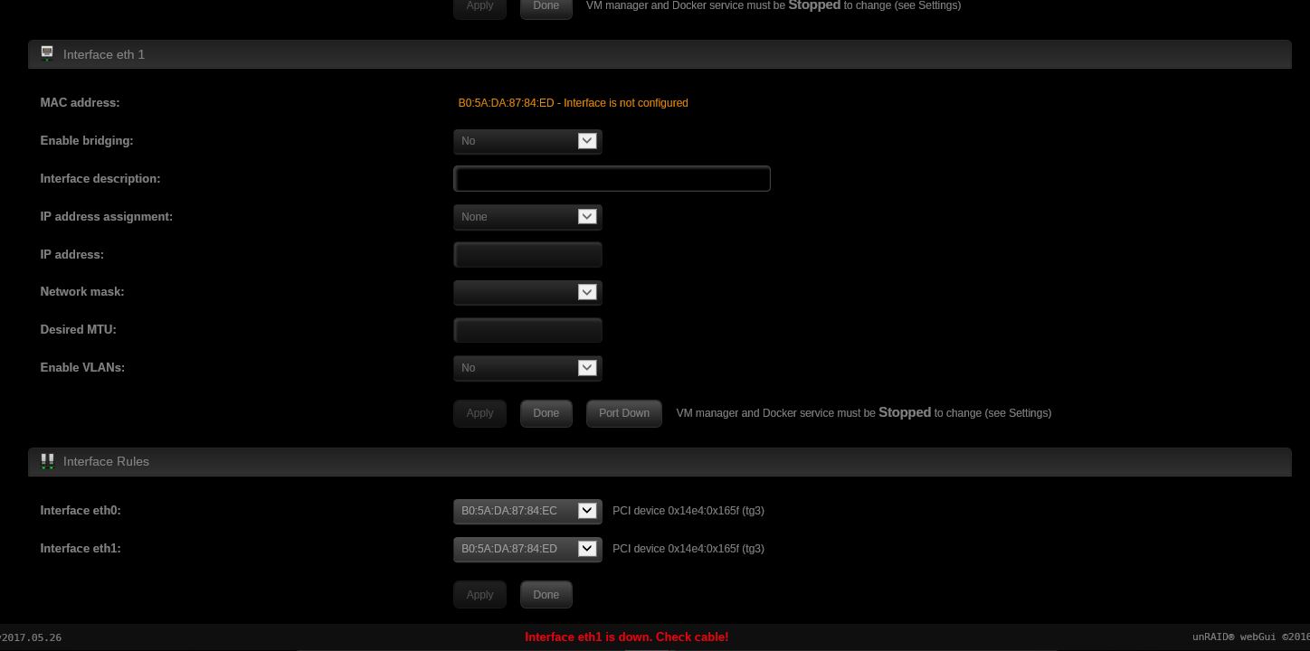

Something is configured for eth1 or bridge br0 has eth1 included.

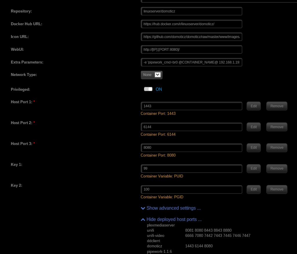

But should i type br0 or eth0 ?
Im bit confused here.
Please check the picture of my network settings.
then i type: -e 'pipework_cmd=eth0 @CONTAINER_NAME@ 192.168.1.193/[email protected]'
its open my container https://192.168.1.192:8443/
i dont see any settings the eth1 or br0 ?

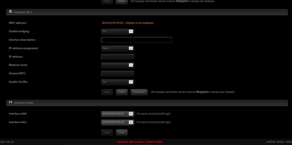

Logs for pipworks keeping saying:
Device "eth1" does not exist.
event_line=2017-11-15T20:08:58.618946004+01:00 container start a279f8091eb1da176d490e67adfd502b05bd680ea09c542c7acfa82d7da3ab5e (build_version=Linuxserver.io version:- 71 Build-date:- November-10-2017-23:52:39-UTC, image=linuxserver/domoticz, name=domoticz)
event_line=2017-11-15T20:09:56.573557841+01:00 container die a279f8091eb1da176d490e67adfd502b05bd680ea09c542c7acfa82d7da3ab5e (build_version=Linuxserver.io version:- 71 Build-date:- November-10-2017-23:52:39-UTC, exitCode=0, image=linuxserver/domoticz, name=domoticz)
event_line=2017-11-15T20:09:57.287172915+01:00 container start 45a527fe69fe6708fa739558d1a1011adfde902381aa5c40e4f856c73725d257 (build_version=Linuxserver.io version:- 71 Build-date:- November-10-2017-23:52:39-UTC, image=linuxserver/domoticz, name=domoticz)
event_line=2017-11-15T20:13:53.618663394+01:00 container start 79d0195f1f0273356437c46fa5dd2627c2df290a82161104c03f2e0c7e09a747 (image=dreamcat4/pipework, name=pipework-1.1.6)
event_line=2017-11-15T20:13:53.969464043+01:00 container start fda4b30fa2b1d9713de4526fdb437c7f172dec9ac8bfbd5e14f3778db8103705 (image=mace/ddclient, name=DDclient)
event_line=2017-11-15T20:13:54.309723499+01:00 container start ef4d2d6468620f65850786c97152a44f0d3e7d4c208abe288a63ff4c1f4d0546 (image=limetech/plex, name=PlexMediaServer)
event_line=2017-11-15T20:13:54.640568879+01:00 container start d5ed16b92c6a8a69c5dafe127465ed59c28baeb19267ef77ff289db39a375964 (image=pducharme/unifi, name=UniFi)
event_line=2017-11-15T20:13:55.251236510+01:00 container start a05dd46e3449304a018e8f8a63fe1b411aa8c750720aea0eb7fc07a8ef6b410d (image=pducharme/unifi-video-controller, name=UniFi-Video)
event_line=2017-11-15T20:15:25.874054663+01:00 container start ae55574896fc626e8dccf739521125645a754e037c82d906f0e197652206d15e (build_version=Linuxserver.io version:- 71 Build-date:- November-10-2017-23:52:39-UTC, image=linuxserver/domoticz, name=domoticz)
last picture that says that eth1 is not used...
First pic you show eth0 with a bridge only including eth0, which is correct.  Show a pic of the eth1 configuration.  Your unRAID server is on x.x.x.192, you have the Domoticz Docker on x.x.x.193 - looks fine.  Set to br0, not eth0:
The Docker hub page for this Docker shows three port maps, a 1443, 6144, and 8080.  Edit: According to the instructions 8080 is the port you use to access the application web interface.
Your Plex, Unifi, and DDclient containers, can you post a pic of those config pages?  Looks like they are running, but want to be sure you have unique IP addresses for those.  If they do, this looks like a Docker config issue or remnants of the manual macvlan still on your system.
You are overcomplicating this. I see absolutely no reason for you to give your containers their own IP. If you have a conflicting port, you simply change it in the template of the container.
Edited by saarg
All my other containers running on the same ip adress with different ports.
I just want to change the ip adress for the Domoticz
I have no pipeworks settings for the other containers.
They are up and running as well.
Dont understand way this is so hard to set a static ip adress on a container.
Is there some way to set an ip adress via the console SLI ?
i change the the command to br0 and now its works, i just ping 192.168.1.193 and I got a respone.
They I tried to start the weblink via WebUI it takes the old ip adress but If i type the ip adress and port 8080 it works.
Is there any way to change this?
