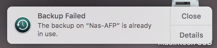

Im backing up a single Mac to my time machine share, and 9 times out of 10, it fails with the error:
Occasionally, time machine will back up OK, but 9 times out of 10, i have too reboot the server.

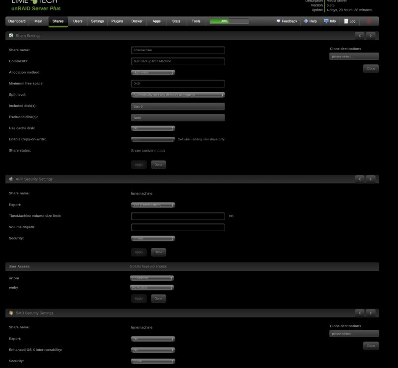

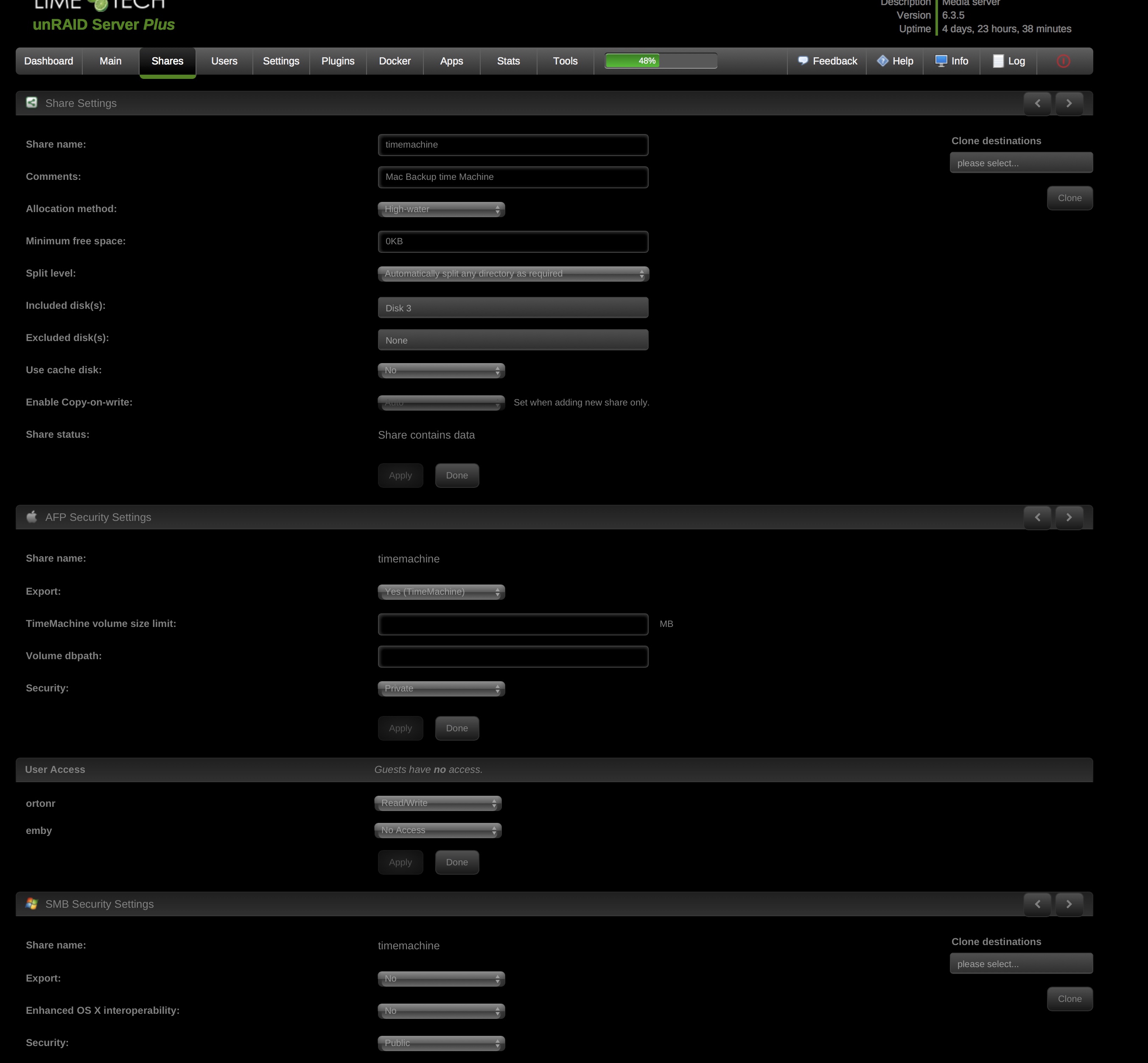

This is the only afp share on my unraid system, and here are my settings below - any ideas as its a real pain in the rear5a087212d4edb_UnRaidTimeMachineConfigPage.thumb.jpeg.6dbf5b538fe667ef57977abc5db479c6.jpeg
