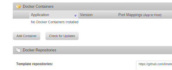

Under dockers I only see the template for limetech..... Not sure what to do here?
Forget the "Add Container Button" ever exists.  Forget the "Docker Repositories" section in the docker tab ever exists.  Forget the Plugins - Install Plugin section ever exists.
Install this:  https://forums.lime-technology.com/topic/38582-plug-in-community-applications/  (ok, you'll have to use the Plugins -Install Plugin section this one time :D )
Edited by Squid

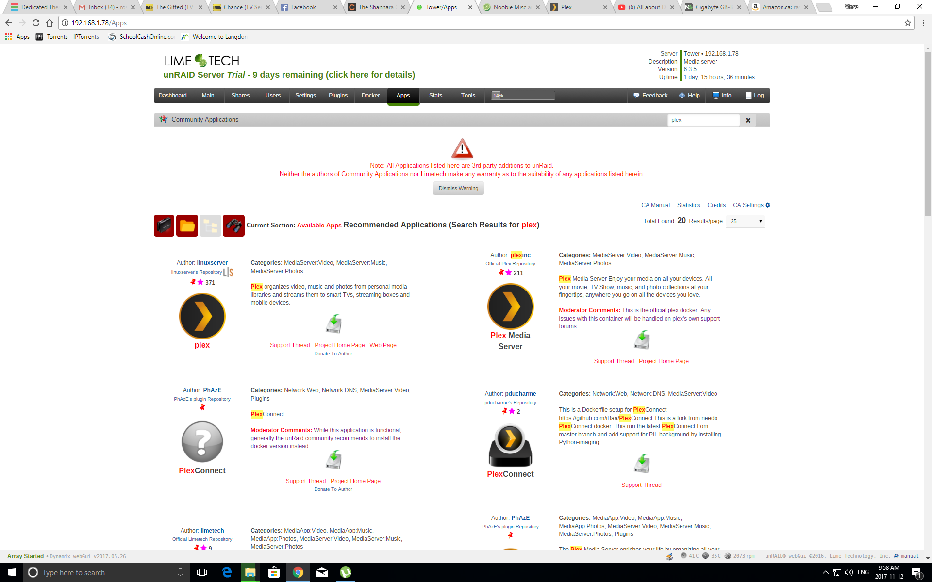

Hey Squid thanks
I do have the communities app installed  that that is where I seen all the plex stuff when I searched..... what to do from here....
7 minutes ago, Squid said:
Clicking the harddisk with the arrow on it will install.  (Press Help in the top right)
Wouldn't be a bad idea to watch Gridrunner's videos https://forums.lime-technology.com/topic/52998-guides-and-videos/  (specifically this https://forums.lime-technology.com/topic/54834-video-guideall-about-docker-in-unraid-docker-principles-and-setup/ , but the screens will look a little different)
Hi Squid,
yup I get the arrow on drive to install thing but am more concerned/curious on the point that there are three different ones to choose from and uncertain which to choose
Thank for the links, I have watched the video once before and actually had it cued for another viewing this morning :)
Major differences in the Plex containers
  • Limetech  -  Created primarily for marketing reasons.  Does not auto update - Must wait for LT to release an update for Plex whenever they deem fit.  Support Level: B-
  • Binhex - Does not autoupdate.  Must wait for Binhex to release an update to it whenever he seems fit.  Support Level: A+
  • LSIO - Autoupdates with every start / restart of the app.  Support Level A+
  • Plex Inc.  Based on LSIO's.  Autoupdates with every start / restart of the app.  Support Level: F (probably A across the board, but definitely an F for unRaid itself)
Many other under the hood differences between those 4, but unless you're an uber-geek it really doesn't matter what baseOS the container is using etc.
Go with either LSIO or Binhex and you'll be happy.

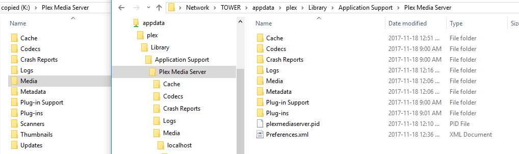

Ok so back to previous issue..... really want to get my original setup into unraid plex (lots of custom sorting)
@ashman70 can you explain the mover and getting the files from my original server (windows) to the unraid path
I wasn't able to copy directly via windows due to permissions

Below Left is structure from windows machine.... Right is in unRaid

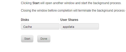

Under "Tools", you should have "Docker Safe New Permissions" that I think you can run at any time. Double check the docs before you run it, though. It's been ages since I've had any permissions issues, so I'm not sure.
1 hour ago, Waterboy77 said:
how to be able to transfer files to the plex media server folder as I don't have permissions
Docker Safe New Permissions won't work as it will not allow you to change the permissions on appdata, hence the "Docker Safe"
You could run the Tools - New Permissions tool against the appdata share, or alternatively from the command line:
newperms /mnt/user/appdata/plex
which will only run the tool against plex's appdata
Hi Squid,
I'm trying to understand the Tools - New permissions
Does running the below configuration set the permissions for all that is "behind" appdata?
Which only happens to be plex at the moment....
Edit do I need to turn off the app and docker before doing this?
Sorry....when saying run at command line I'm assuming that means with a monitor and keyboard connected to the server.... or is there another way (headless)?
Edited by Waterboy77
OH YA...... its worked.... I got all my watched history, sort configuration, etc....
Thanks @Squid I found where to go for command line entries and entered the command you posted.
That gave me the access to the folder structure I needed.
Then I copied ALL the files (except cache) from the tree I posted earlier onto the unraid appdata structure.
THANK YOU EVERYBODY!!!!
