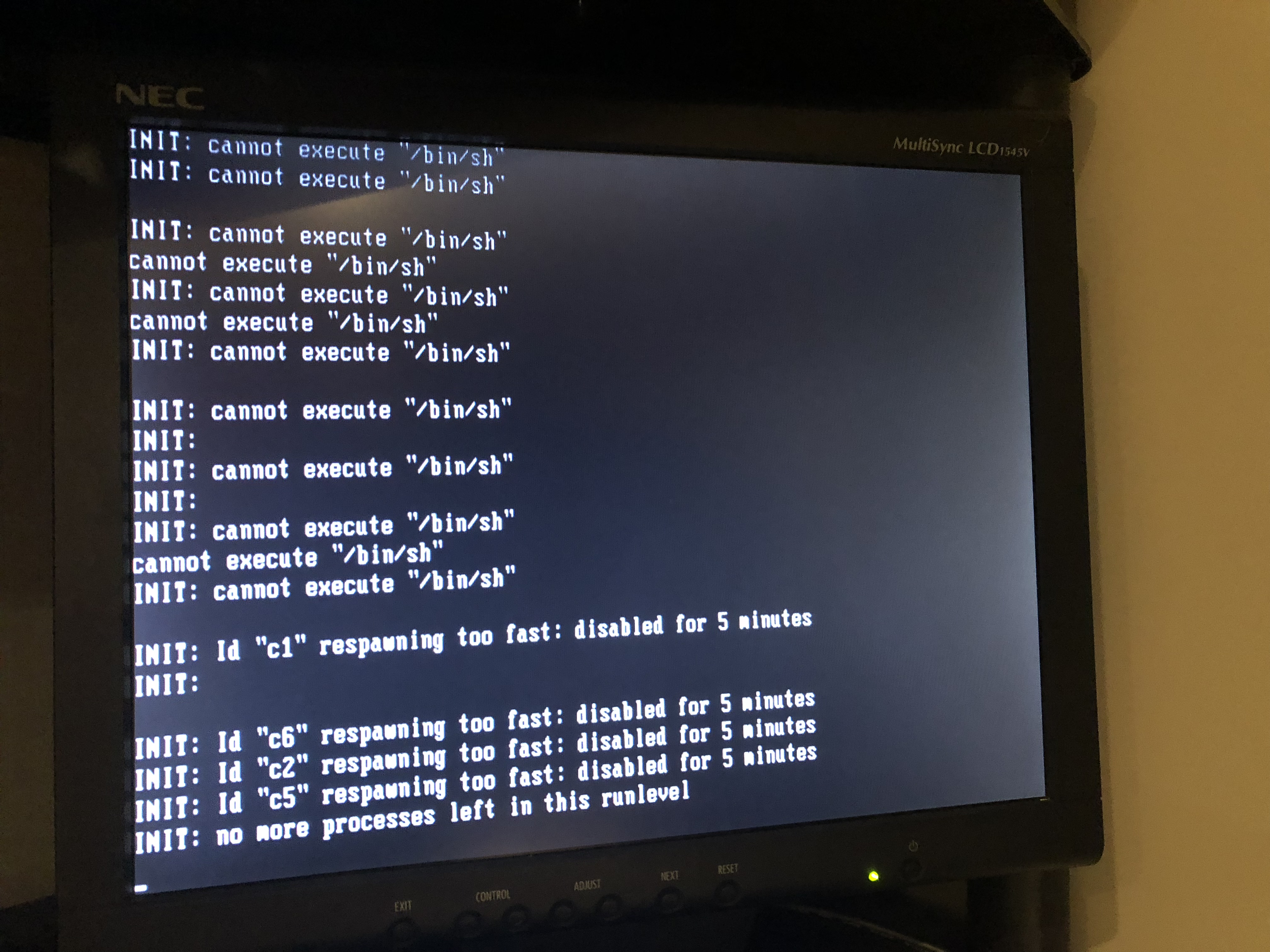

Upgraded to RC10b from 6.3.5, can't boot or ssh.
This is what I'm getting. Any idea?
~ $ ssh [email protected]
[email protected]'s password:
Last login: Sun Nov 12 20:34:41 2017 from 10.0.0.193
Linux 4.13.10-unRAID.
/bin/bash: No such file or directory
Connection to 10.0.0.4 closed.

And this is what I see on the local console.
Assuming typing diagnostics at the console doesn’t do anything? Can you pull a dish from the GUI and post? Looks from the pic like some C states were activating. Care to tell us some specs too? Big one get diags

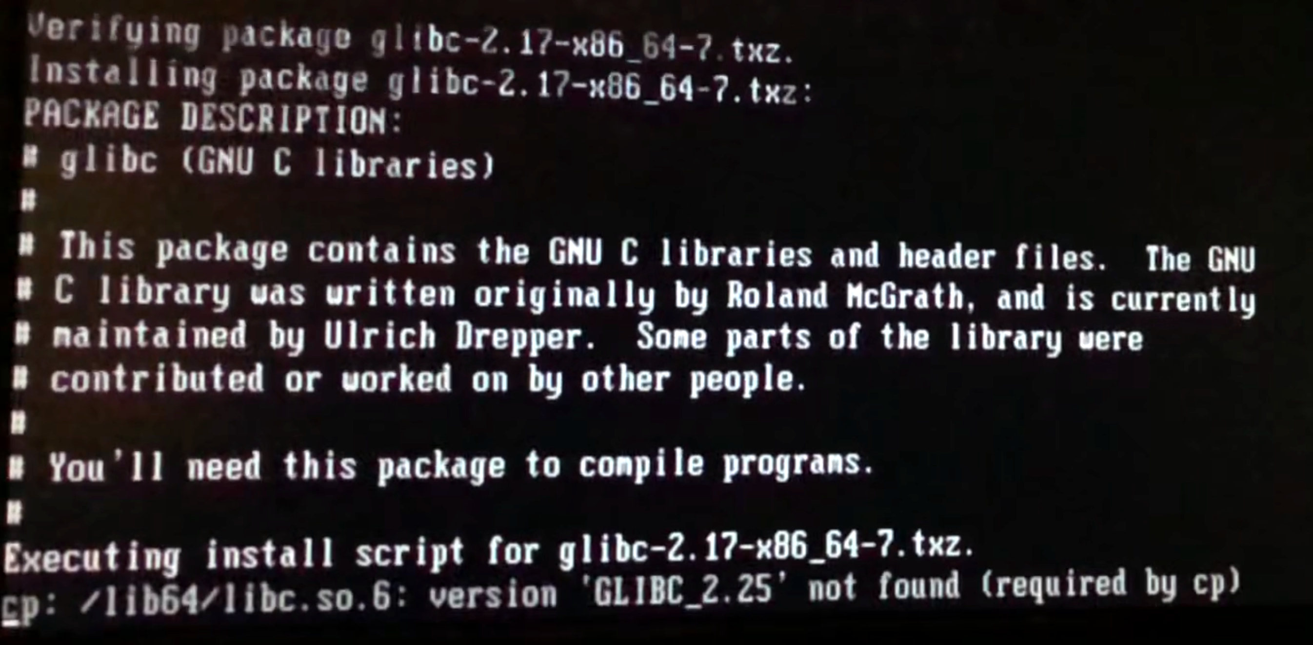

The system boots fine in Safe Mode (without plugins), so I decided to remove everything in /boot/config/plugins and reboot normally, but it didn't work.
I decided to film the console at 240fps because everything was scrolling so fast. Here's what I was able to capture. Something is complaining about GLIBC_2.25 not being present. I can't figure out what tries to install glibc-2.17-x86_67-7.txz

Yes! This worked. I didn't know about the /extra directory. Thanks so much!
