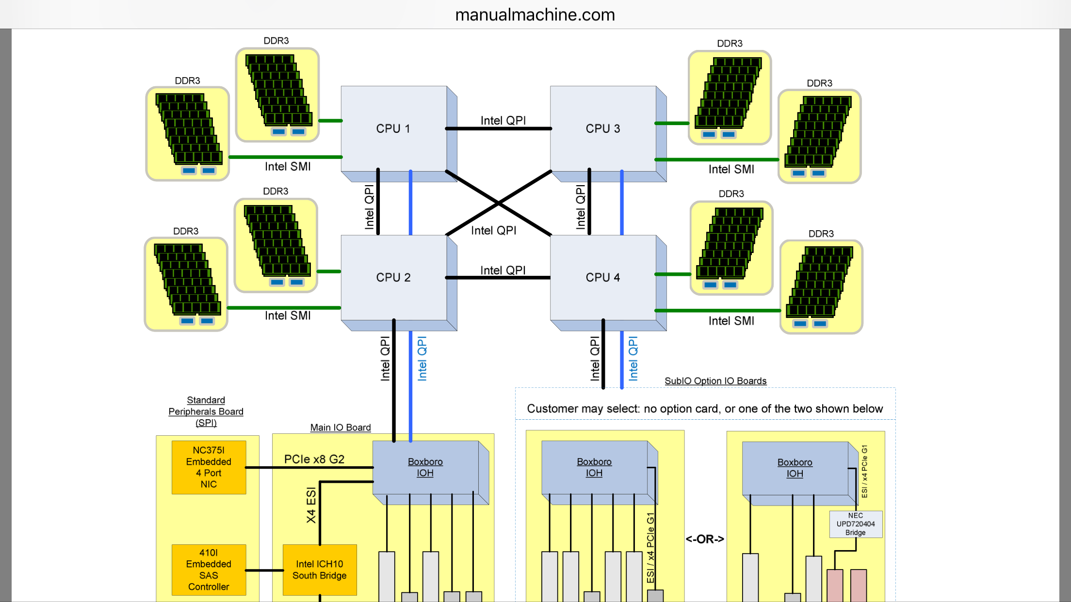

Thank you, most appreciated. Will make sure to remember that when I get around to finishing my dual cpu server...
I've isolated all my cpu's going to vms, and mapped to the pci slots that i think they go to ... is there a map of pci slots to cpu sockets for the 580 g7 ? what mapping did you use - so far I;ve got unraid mapped to cpu 2 along w/ the nvme's .... cpu core 1 and its hyperthread for each cpu to unraid ( which im hoping to help with pci-pt ) ... using gtx 1060 with 14 cores ( using 4 in dx11 testing ) with about 100-130 fps @ 1080p ultra settings 4x aa and high tes on that unigne test
On my 2 processor server dl580 g7, I’m using an expansion board which requires a processor in socket 3 (cpu 2) to manage pci devices on it. I put my raid cards and melanox 10gbe card on the primary board an moved the gpu to the expansion board. The vm is only using the second cpu exclusively.
On my 4 processor dl, I run all the cores on a single vm for 4k video cruncching(it’s the only thing it runs, 80 threads) so pci lanes don’t matter as much since it all goes the same place.
I don’t have a lane map but will look to see if I can find one.
