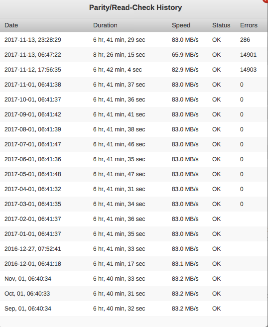

Yesterday, after a power failure I got 14,000+ sync errors, then I ran second parity check (with parity correction this time). The second parity check did "correct" all but couple of errors.

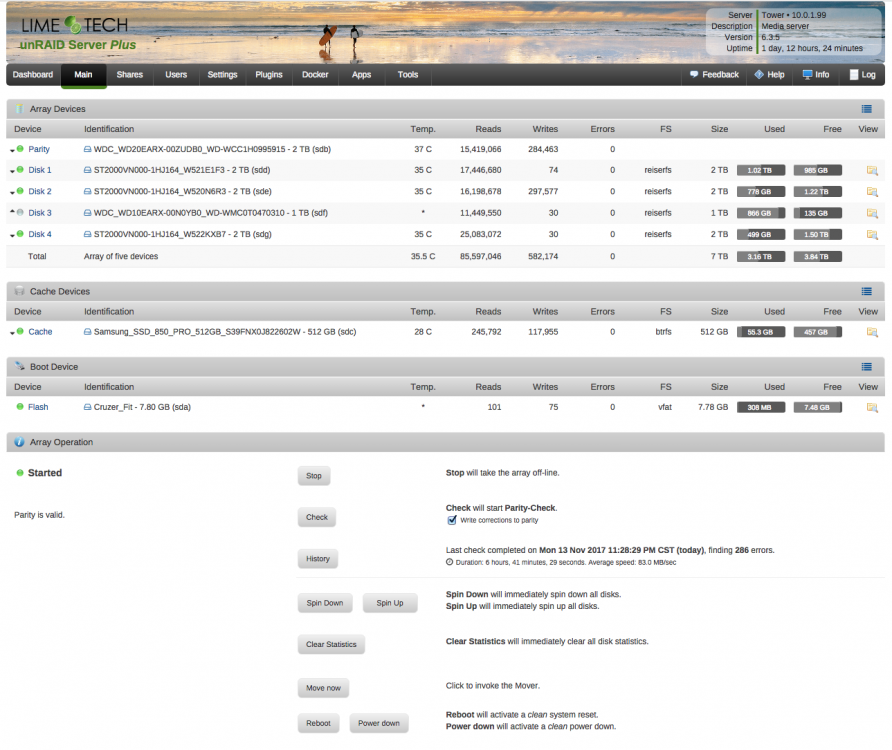

Today, I ran the third parity check (hoping I would get 0 errors). However, I ended up with 286 errors, please see the attachment.
Could someone please take a look at my diagnostics and let me know what is causing all these errors?
Start by running memtest.
P.S.: SATA ports 5 and 6 are set to IDE, enter your bios and change them to AHCI/SATA.

You'll need to start testing with different hardware to try and find the problem, after the RAM, the board would be my prime suspect.
Edited by johnnie.black
Do you thinking, adding a cache drive recently could have anything to do it the sync errors?
Not directly, cache has nothing to do with parity in the array, but if there's a hardware issue the new device could make it worse.
