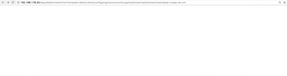

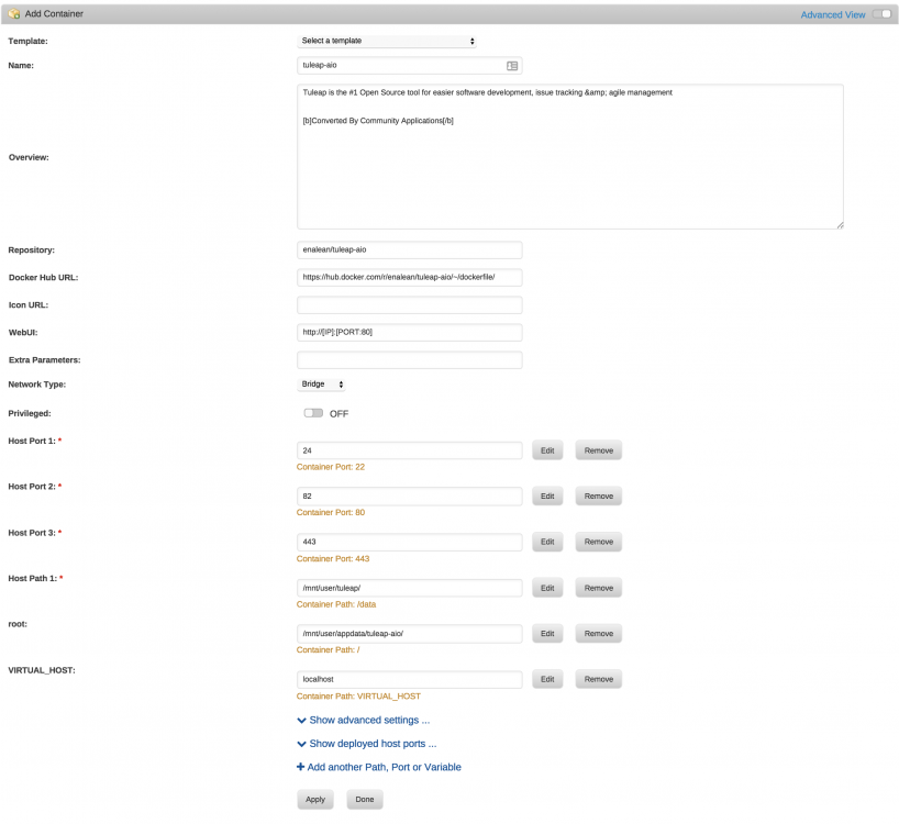

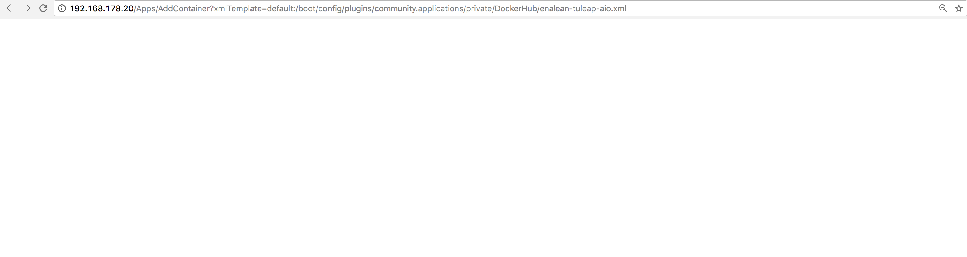

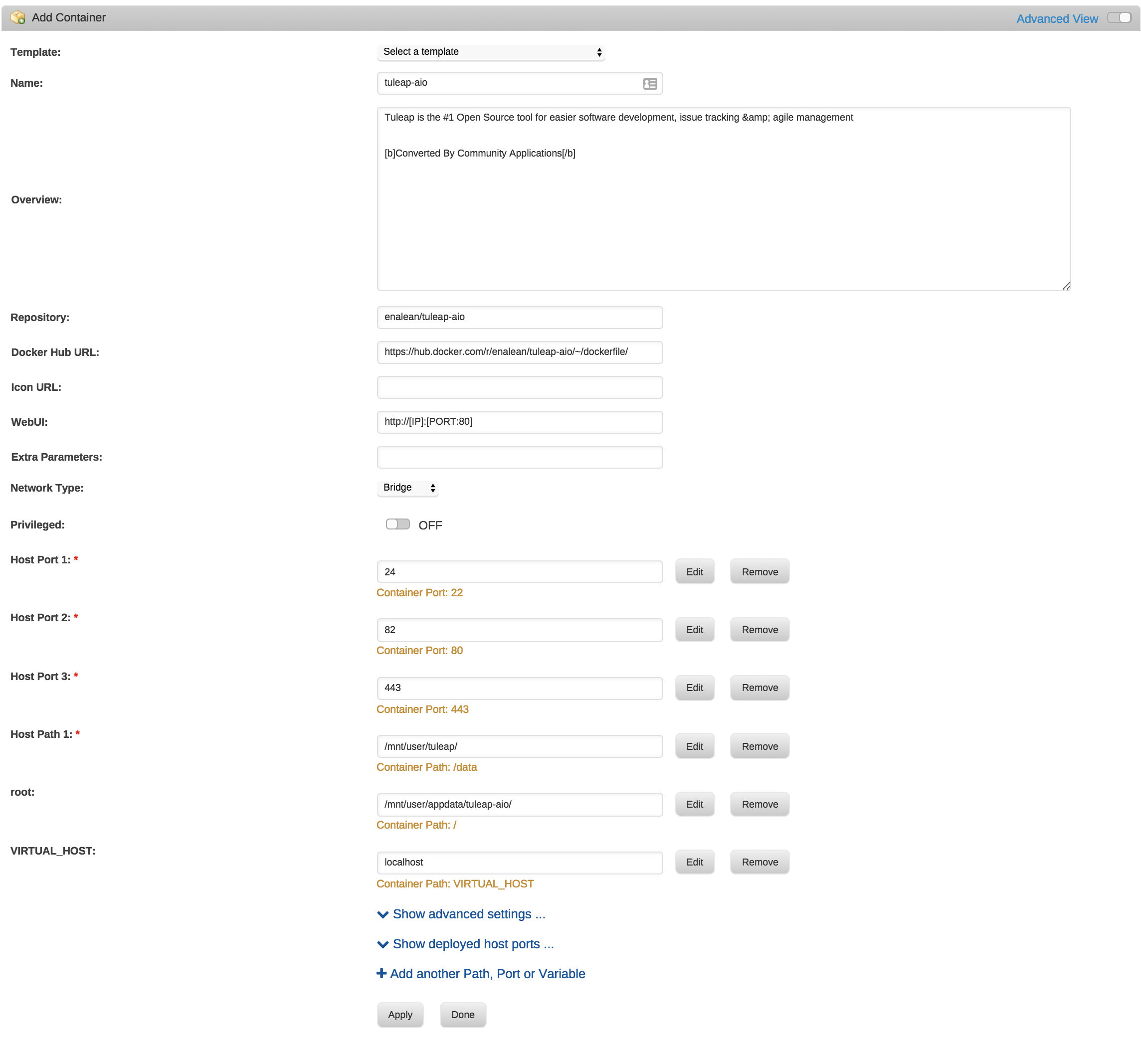

still trying to get this to work.
Thanks for the tips and links, they heleped a lot with understanding how this all should work.
My problem now is, that if i try to set everything up manually and click apply, i get a completely blank page... There is nothing on it it does not load nor anything...
What am i doing wrong? Why does it not download the docker and install as expected?
I have included screenshots and here is a link to the docker hub i tried: https://hub.docker.com/r/enalean/tuleap-aio/
thanks for your help

Im AFK but try getting rid of the ampersand in the description and see if it makes any difference
