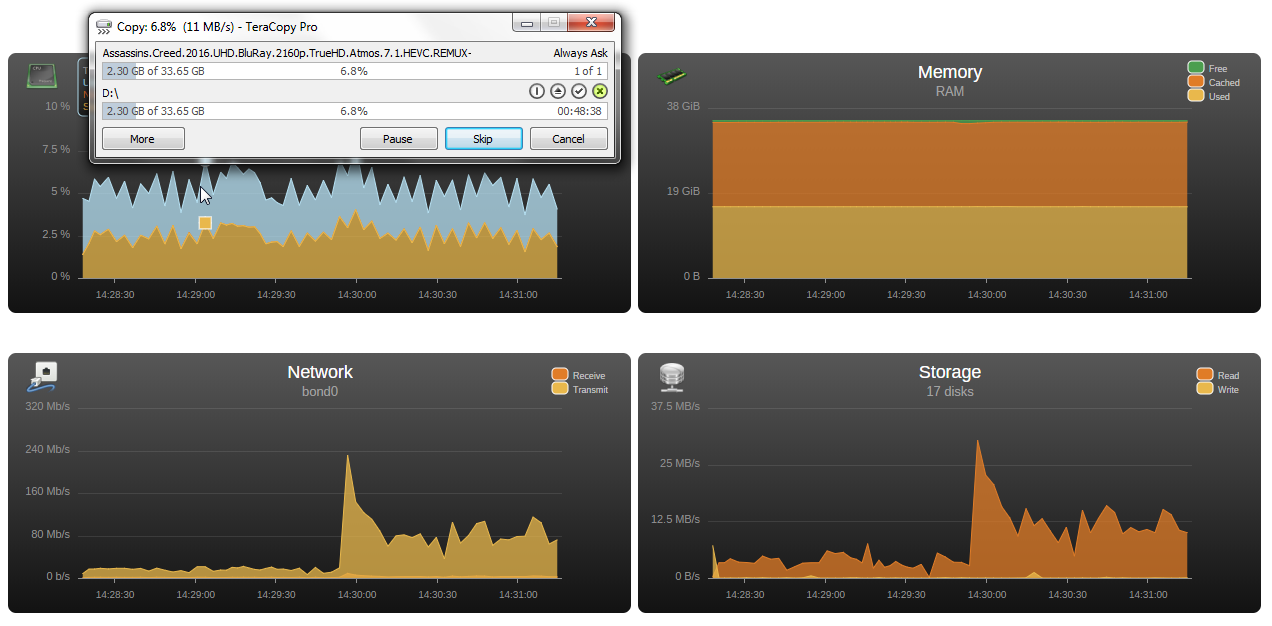

Using 10gbps I was able to transfer 300-400MB/s from server(SSD-cache) to my pc(SSD). Then I tried copying direct from the server(array) to pc(SSD) and the speed was around <26MB/s. Then I switched back to my 1gbps, the speed was reaching around 50MB/s sometimes but was more stable around 30+MB/s.
Lastly I tried streaming 4K content again with plex, and was able to watch a movie for an hour then the movie started freezing. I checked unraid and the disk usage was <15MB/s.
Is it possible to reach around 90-100MB/s transfer speed with the array?
