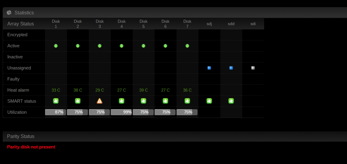

 pretty new to unRAID but loving it so far but had a problem on my setup this weekend and lost 2 hard drivers and 1 ssd in the process... all 3 units have no power upon shutting down and moving the machine from one room to the other... maybe on Y of the connections is bad... i really dont know and the SSD was 1Tb so... kinda want to forget about it!
But one off my other disk's got a few smart errors so i was wondering if anyone in this great community could help me on keeping this HD for now (since it has data) or it is better to load up krusader or even via another machine and just dump all of the data to a new disk, stop the array and pop the new disk in.
More than a 1000 pending sectors, I would consider that more than a few, and a very sick disk.
yeah... later on i'll stop the array, stop the data transfer and make a "clone" off the data on this one to a new one while i still have access to the data on the original machine.

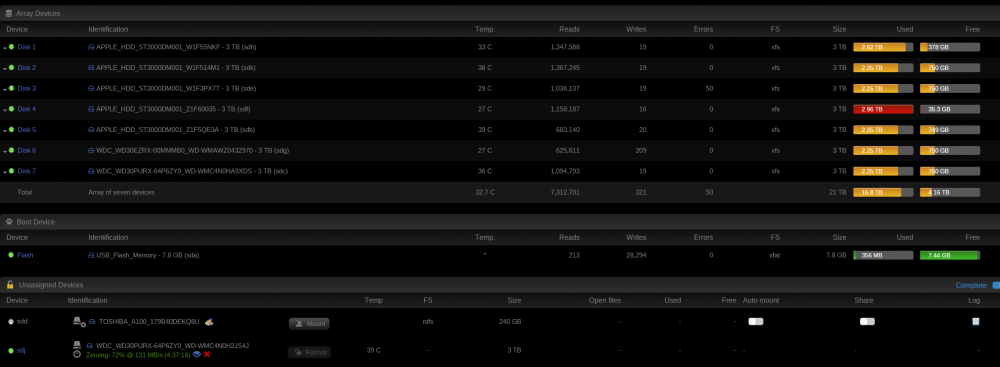

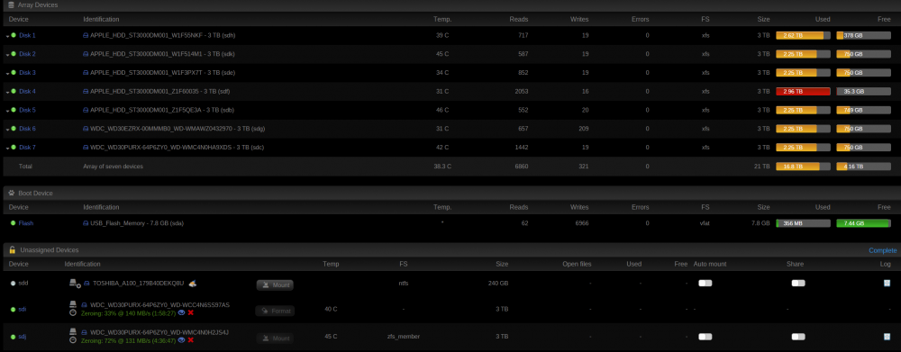

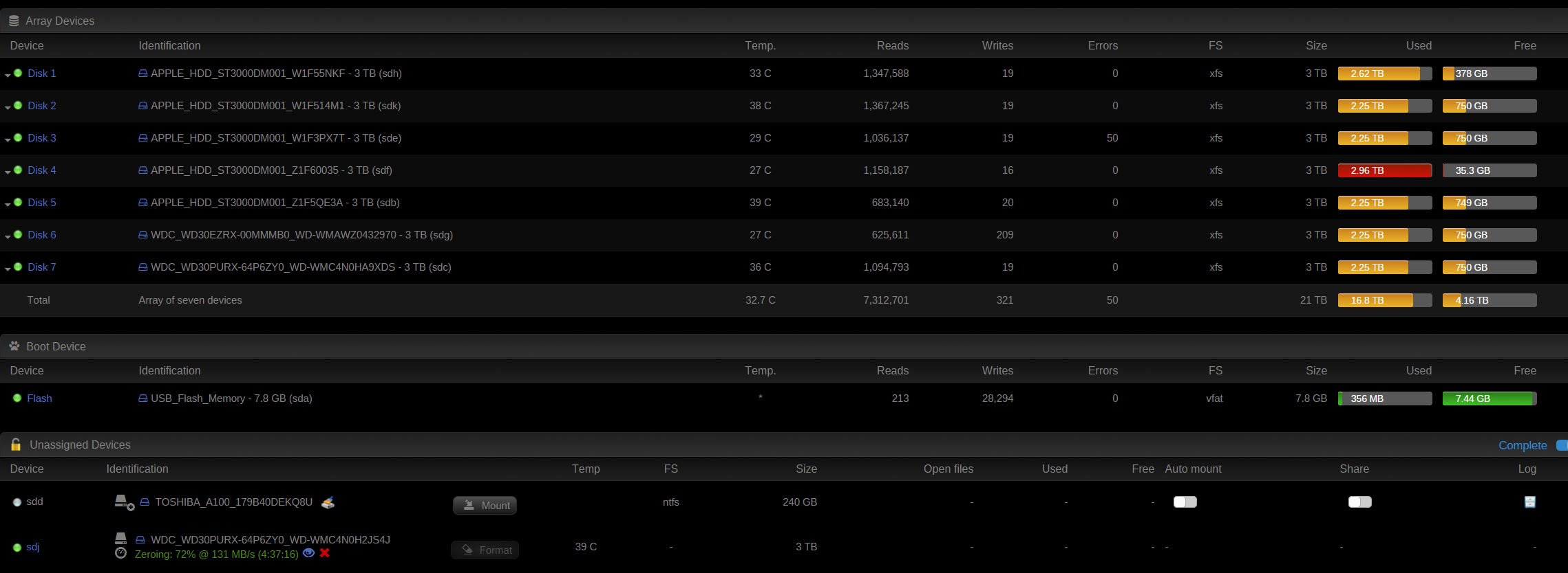

This morning i had the report asking if i wanted to send the data report but i cant find the disk (and the one is missing is the new one) since this older one also has some smart errors but i will let the preclear finish..
i've clicked the refresh disk's on the unassigned devices but no luck..
I'm doing something wrong since it is on the dashboard..
Thanks in advance for any input

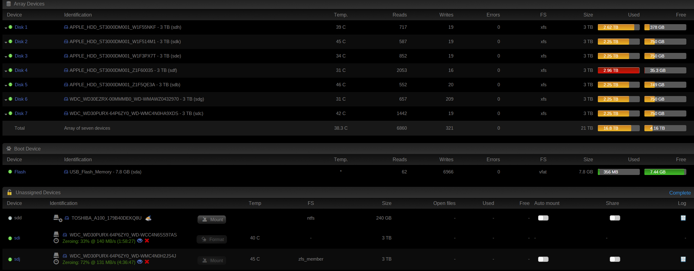

it seems i've got an error on the new disk..
I meant the unRAID diagnostics, not the preclear log.

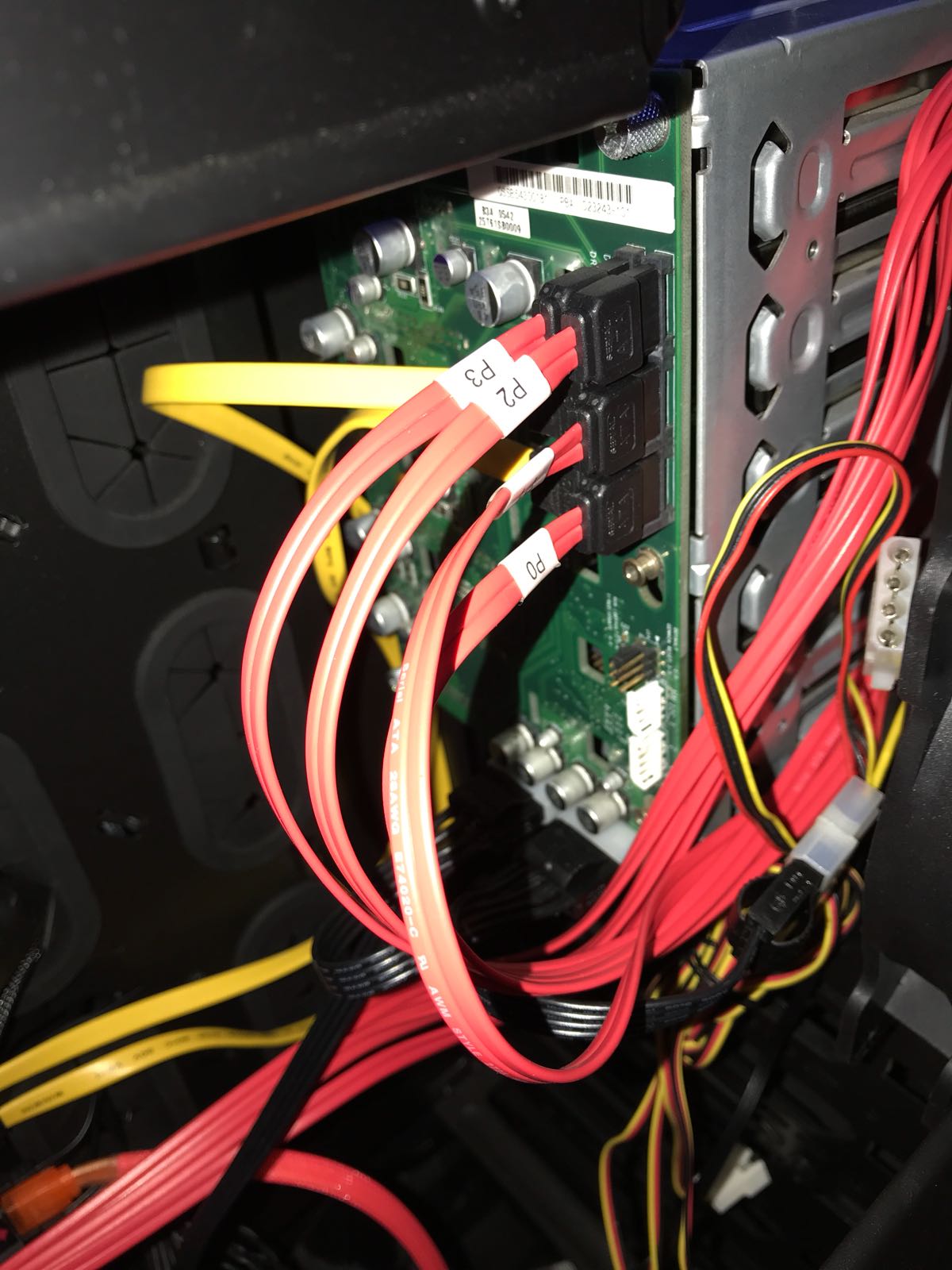

Disk keeps dropping offline so there's no SMART report, power down, check cables, power back up and get new diags.
that is strange since this new disk went on this "case" so they are all powered the same way.. (cable management is not done since all the data and disk's are not on the case yet)
i'll power down as soon as this other disk finish's preclear session.
Thanks again for the quick assistance @johnnie.black , i will report back as soon as i power it off and double check it.
