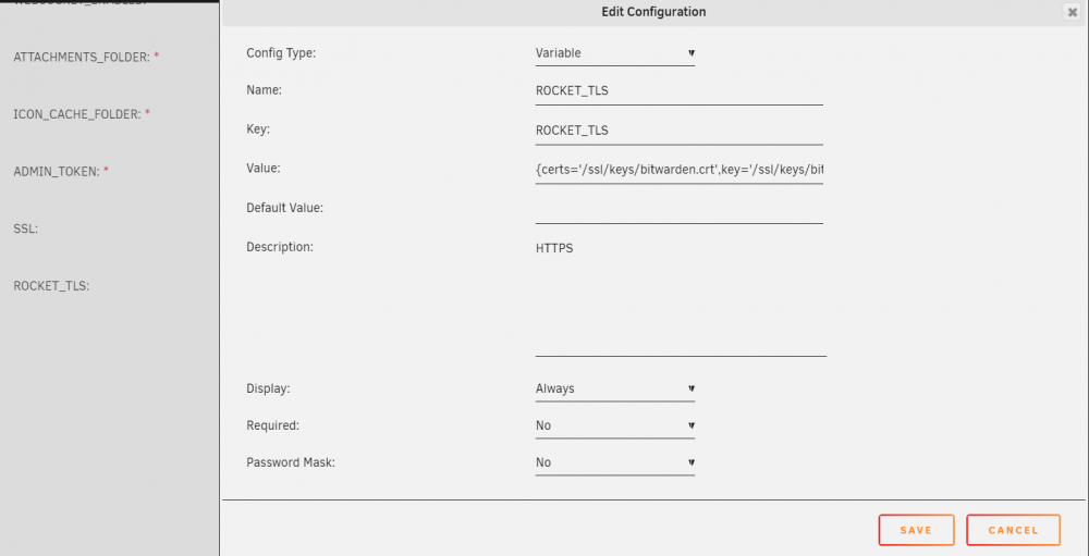

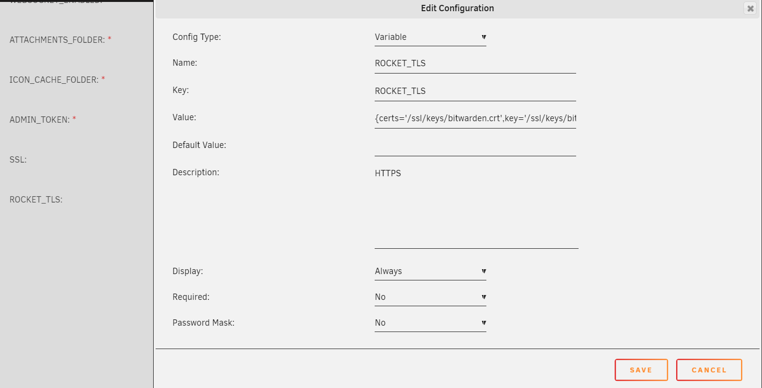

Also can someone help me set up SSL using these instructions? https://github.com/dani-garcia/bitwarden_rs/wiki/Enabling-HTTPS
I would like to use my own CERTS for Bitwarden but am a little confused how to do so using the Bitwarden Docker in Unraid, there is no option for "environment" under the advanced tab when I try to edit the existing Docker configuration for Bitwarden.
Thanks!
On 1/9/2020 at 7:25 AM, goombaunraid said:
Wondering the same thing.
Thanks!
It also took me a long time until I managed to include my own certificate.
That's how it worked for me. Had to enter the command directly in the unraid terminal because the GUI didn't accept the {}.
Problem is that the docker can't be updated via the GUI anymore.
The command has to be adapted to the own environment.
Maybe someone can report this to Github Project Tracker.
command:
docker run -d --name='bitwardenrs' --net='bridge' -e TZ="Europe/Berlin" -e HOST_OS="Unraid" -e 'SIGNUPS_ALLOWED'='true' -e 'INVITATIONS_ALLOWED'='true' -e 'SERVER_ADMIN_EMAIL'='YOUREMAIL' -e 'WEBSOCKET_ENABLED'='true' -e 'ATTACHMENTS_FOLDER'='/attachments' -e 'ICON_CACHE_FOLDER'='/icon_cache' -e 'ADMIN_TOKEN'='YOURTOKEN' -p '8080:80/tcp' -v '/mnt/user/Bitwarden/':'/data':'rw' -v '/mnt/user/Bitwarden/ssl/':'/ssl':'rw' -e 'ROCKET_TLS'='{certs="/ssl/keys/bitwarden.crt",key="/ssl/keys/bitwarden.key"}' 'bitwardenrs/server:alpine'
