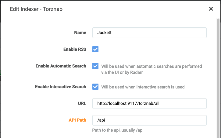

Second attempt at clarifying what I'm after haha.
So, with the changes to the binhex VPN dockers I wanted to verify if I was utilizing Jackett properly. Sonarr and Radarr are currently configured to tunnel through the VPN and have been updated with the proper host setting: 'localhost'. Now, within Jackett these buttons are still using 192.168.1.x causing Sonarr and Radarr to error while grabbing indexers.
To fix this, within Sonarr/Radarr I edited what the "Copy Torznab Feed" gives me and replaced 192.168.1.x with 'localhost'. With this, both dockers pass while checking the indexers!
Is this the correct way to update these settings? Can I set something up within Jackett so I do not have to manually change the ip address when adding a new indexer?
Thanks again for your help and time. I'm learning quite a bit!

This doesn't answer your question directly, but in Sonarr/Radarr you can also set them up to use all your configured indexers in jacket, see example from Radarr below. That way you only have to set up one indexer, once, in sonarr/radarr. If you add new indexers to jackett, they will be automatically included by the other apps.
Doesn't work if you need different indexers for the different apps though...
