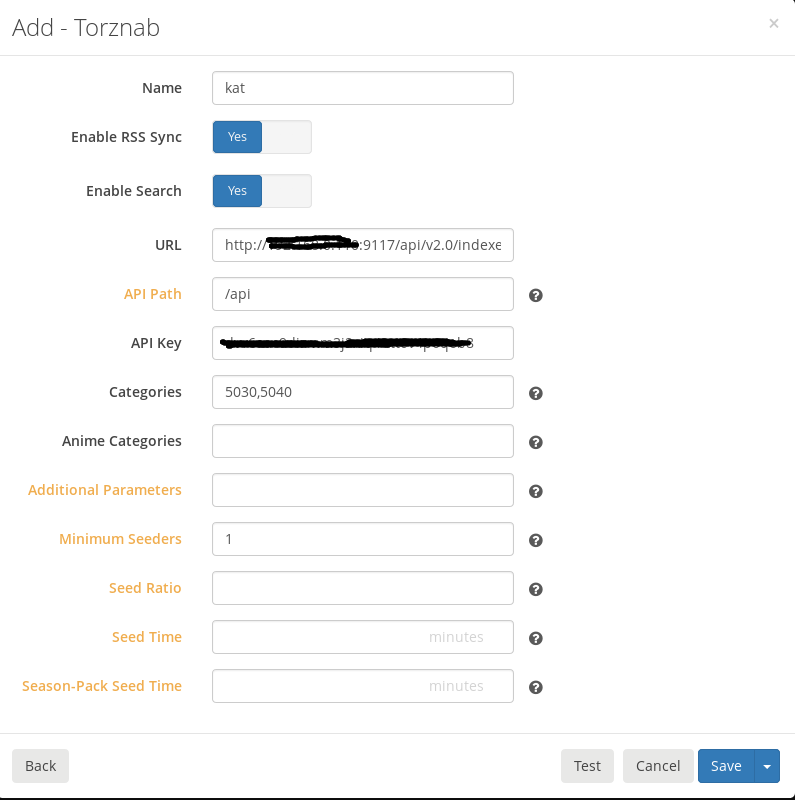

yes here
I have both Sonarr and Radarr. I use a site where I need to use Jackett to pull back results.
Radarr works great through Jackett. However Sonarr will not find anything no matter what series I add.
I've gone into Jackett and manually searched for a series... it brings back results no problem.
Into Sonarr and go to an episode and manual search... nothing is found.
In Sonarr if I go to Jackett and these are the settings I have... I've used * in some cases to maintain privacy.
RSS and search ENABLED:
URL: http://192.*.1.1**:9117/api/v2.0/indexers/ipto******/results/torznab/
API PATH: /api
API KEY: I've entered the same key Jackett gives me.
Categories: All relevant TV categories number.
If I press TEST. It will give me a success message.
Is there an issue with using Jackett within Sonarr ?
Can anyone please suggest what might be causing this?
Thank you.

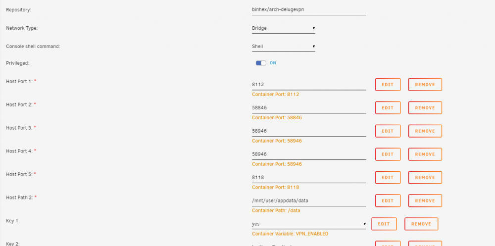

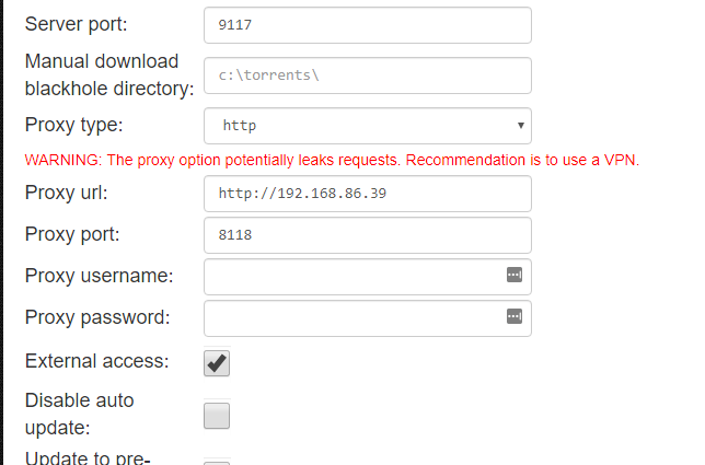

I tried to use your deluge VPN as a proxy, but no dice, so i cleared out the proxy field and it still didn't work :/
Well now I rebooted the system and it seems like it's working again. But as soon as I add the deluge/vpn container as the proxy it fails?
http://internalurl:8118/
^That's the proxy URL I am using, and I used default config for the deluge/vpn container. Am I doing something wrong?

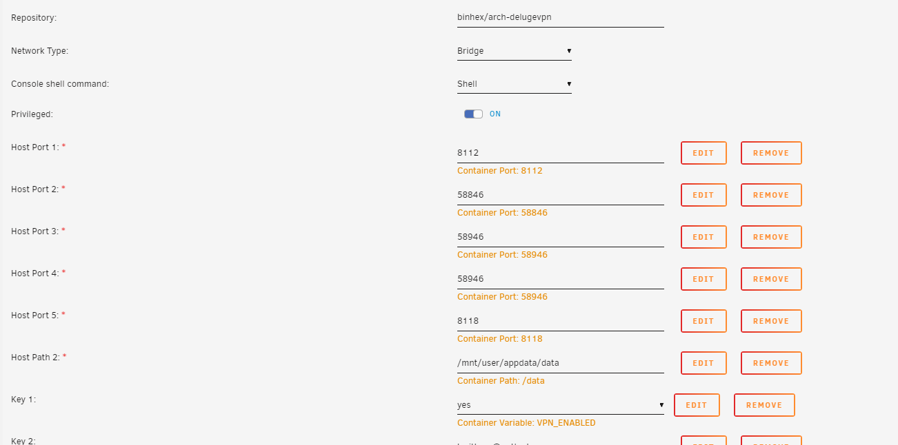

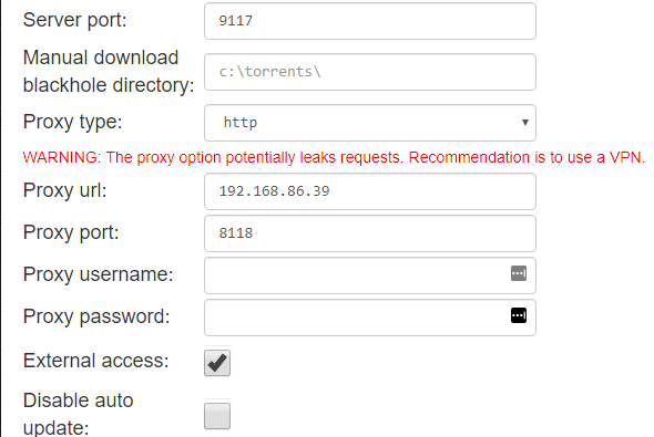

ok fair enough, so just to confirm you should be selecting in jackett a  'proxy type'  of 'http' then in the 'Proxy url' section put the IP address only, no http(s), JUST the ip, and then in the port specify the port the container is running on on the host side (default 8118 but it could be something else).
Updated, restarted container, still no worky :'(
