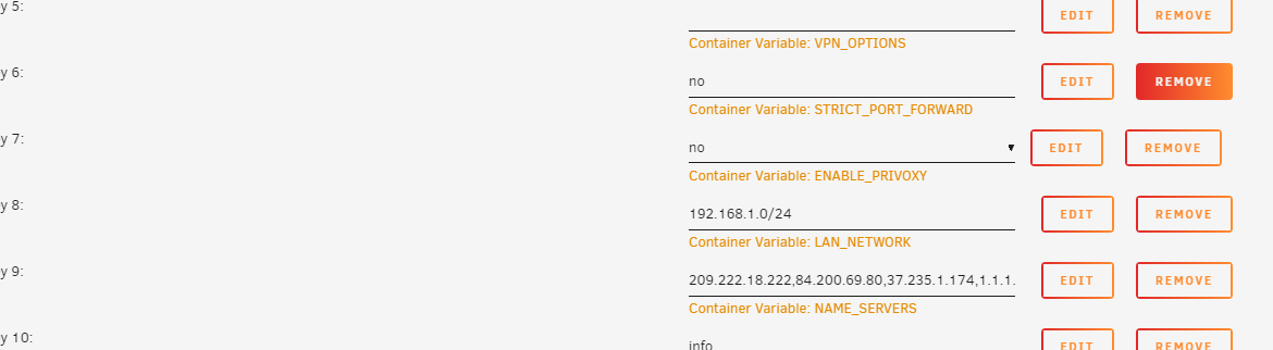

26 minutes ago, LumberJackGeek said:
Updated, restarted container, still no worky :'(
what is your LAN_NETWORK defined as for delugevpn?

Just now, LumberJackGeek said:
yes its wrong, 192.168.1.0/24 is not your lan network, change this to 192.168.86.0/24 and then restart delugevpn, then test jackett

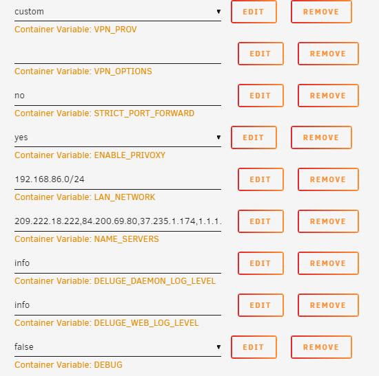

Still not working, restarted both delugevpn and jackett. Should I have privoxy on?
lol, err yeah 🙂
Rebooted DelugeVPN, still nothing :'(

So here are my updated settings:
Alright well I didn't change anything, but it just suddenly started working?? :)
