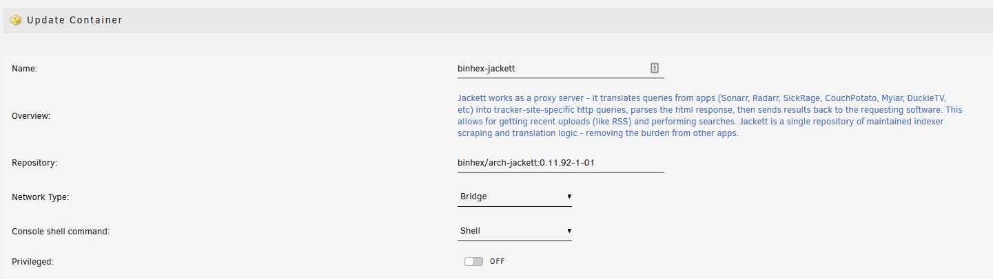

Hi guys,
I changed my version quite a while ago as Jackett was not connecting to IPTorrents for me. It is now asking me to update but i cant remember what i need to change in the Repository field - is it just latest?
EDIT - Fixed it. Just change it to 'binhex/arch-jackett'

On 11/12/2019 at 3:10 AM, showstopper said:
Hi guys,
I tried this and I still can't add IPTorrents. Can someone help me out?
