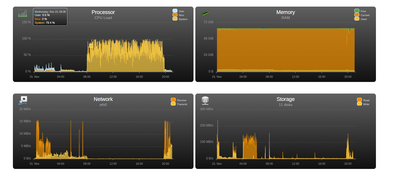

Hey guys, I've had some issues where my system starts to lag for long periods of time. I can typically ping my server when it happens and it seems fine but when i try to go to the home page or go to any of the dockers, it's basically unresponsive/very slow. I can eventually get there though so it doesn't seem as if has crashed.  I opened up Stats for the last day and clearly something extreme is happening during this time. The issue has resolved itself and Can someone help me diagnose what the issue is?

9 hours ago, johnnie.black said:
You're getting constant page allocation stalls, some of them lasting over 80 seconds, this usually helps:

Thanks for your response. I think your link is dead but I found the page and your comment. I will try and change the values to 5 and 10 acordingly.

Got it. I tried reading this page (https://lonesysadmin.net/2013/12/22/better-linux-disk-caching-performance-vm-dirty_ratio/) and it's still unclear to me exactly what is happening. By putting it to 1 and 2, it will just flush more often, correct? I'm assuming this I/O issue usually occurs because my downloaders are often running a lot thus my cache is full of data (but some of it gets stored in RAM?) and once the mover moves, something is happening so it gets bogged? Excuse my ignorance, just trying to put it together.

Yes, it will start flushing when it hits 1% free RAM, instead of the default 10%, and won't use more than 2% RAM, instead of the default 20%.
The problem appears to occur after some time when the RAM gets fragmented resulting in allocations stalls or worse OOM errors, keeping the cached RAM as low as possible seems to fix, or at least considerably help with this problem.
