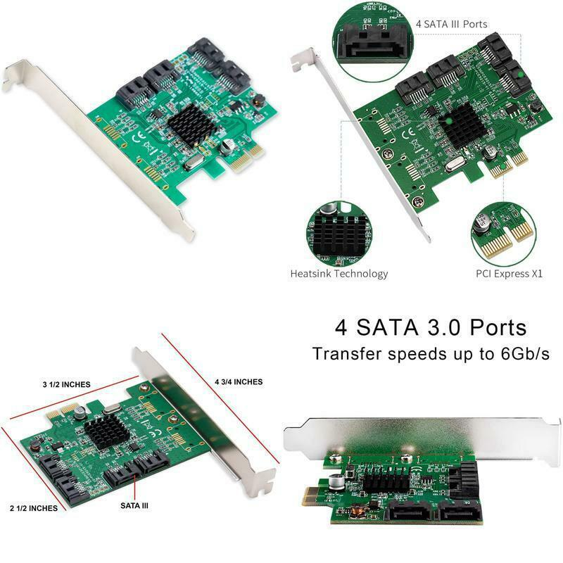

Wasn't sure whether to start a new thread but came here from google...I've got a disabled drive and multiple errors, not sure how to proceed. Attached my diagnostics file.
I've got an SSD in my array, been meaning to get rid of it for ages, it was a test thing I was trying yonks ago, just been too lazy to move it out, I don't THINK its related to this issue though, it doesn't appear to be one of the affected drives.
I say drives becaue although Drive 8 is the only one thats coming up as disabled, fix common problems is saying I've also got problems with drives 5, 6 and 7 with the same error:
If the disk has not been disabled, then unRaid has successfully rewritten the contents of the offending sectors back to the hard drive. It would be a good idea to look at the S.M.A.R.T.
I'm waaaaay out of my depth here, any help would be much appreciated...
babs-diagnostics-20210211-1821.zip
Always best to start a new one, but since we're here, the problem was the controller:
Feb 11 06:55:01 Babs kernel: ahci 0000:01:00.0: AHCI controller unavailable!
All connected disks become unavailable, Unraid disables the first one to error on write (with single parity), the other will have read errors.
That is a Marvell controller, and we don't recommend those, though not necessarily related to the current issue, try re-seating the controller, power back on and post new diags, note that the disable disk will remain disable.
Sorry still over my head I'm afraid, whats the controller? something on the MB?
OH is it the PCI-E Sata card? thats been in there for yonks
Edited by zapp8rannigan
An ad-don controller in one of the PCie slots that looks like this:
