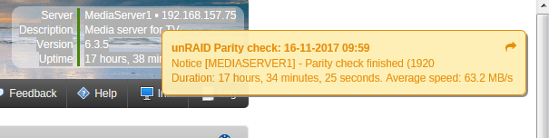

The small bug is a display bug in the popup notification. It says:
Parity check finished (1920
Should it not say something like?:
Parity check finished (1920 sync errors corrected)
Just a minor problem...
I assume you are on unRAID 6.1.9 as per your sig. This was corrected in a later release (can't remember which one).
It happens because there is a LF character in the text, which is filtered in the later releases.
If you have chosen to keep notifications on flash then a manual action is required to delete the offending LF character in older notifications. Or just live with it :)

Nope, I'm on 6.3.5 (look at the screencapture, shows version).
If it's fixed in the 6.4 rc's, then it's good for me.
