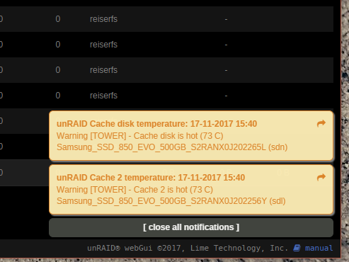

    Whatever you did to mitigate the other red herring SSD reading the wrong temp has borked the ones that already worked. Immediately on first reboot login, I get notifications that my cache pool is on fire. ;)
    tower-diagnostics-20171117-1547.zip
    Edited by interwebtech
    added diags
    Maybe christmas will come early this year :)
    Whatever you did to mitigate the other red herring SSD reading the wrong temp has borked the ones that already worked. Immediately on first reboot login, I get notifications that my cache pool is on fire. [emoji6]
    This is why i suggested that they change it to a user selectable option. As there are too many scenarios now.
    UnRaid Admins should be able to select a non-default SMART attribute per drive
    Thanks for posting your diags.  In looking at the SMART data returned by your Samsung EVO SSD we see:

    As you can see, it reports temperature using attribute ID 190 (ID 194 is not present).  From this wikipedia article we read:
    190
    0xBE
    Temperature Difference or Airflow Temperature Varies   Value is equal to (100-temp. °C), allowing manufacturer to set a minimum threshold which corresponds to a maximum temperature. This also follows the convention of 100 being a best-case value and lower values being undesirable. However, some older drives may instead report raw Temperature (identical to 0xC2) or Temperature minus 50 here.
    This unRAID release is doing the above, subtracting ID 190 RAW VALUE from 100.
    But, looking up documentation from Samsung we read:
    190  Airflow Temperature  The current temperature of the area surrounding the NAND chips inside of the SSD
    This is an intolerable situation.

    What we can do is this:
    • If both ID 190 and 194 is present, use 194
    • If only 190 is present use 190 unmodified
    That might do it.
    Anyone reading this: please take a look at /var/emhttp/local/smart and look for your SSD device identifier as a file name (I think this only affects SSD/NVMEe) and let me know if above rule would work in your case.
    EDIT: in looking again at the SMART output, maybe it's correct: meaning your SSD is indeed at 72C - I say this because look at your "VALUE" column.  Kinda makes sense.
    My Samsung 850 Pro SSD has SMART #190 (with current value of 31) but not SMART #194. I agree that in this case the reading from #190 should be shown unmodified as the drive temp.

    Ok but if you look at that PDF doc from Samsung, at the end is a screenshot labled "<Magician ver 1.0 for 845 DC PRO/EVO>" and there is shows "raw value" as 33 and "normalized value" as 67.  That seems to imply the true temperature is 67 right?
    18 minutes ago, ljm42 said:
    My Samsung 850 Pro SSD has SMART #190 (with value of 31) but not SMART #194. I agree that in this case the value of #190 should be shown unmodified as the drive temp.
    If you're willing, maybe turn off your case fans, or hit it with a hair dryer for a few seconds and see if the temp goes up or down.
    Not going to do that.  Something as simple as reading the Temperature should not have to involve user intervention, that's ridiculous.
    That might do it.
    I think this is a bit short-sighted, as there will be drives out there which only support attribute 231, or inverted 190 only, or worse 190 and 194, but 194 reports a bad/invalid value.
    It would be great to be able to select it as an override and resolve a lot of the temp reporting errors.

    I lasered the outermost SSD and got a temp @84F which leads me to believe the inner temp could likely be 82.4F which lines up with the raw value of 28C.
    Good idea!
    This was the starting point:
    ID# ATTRIBUTE_NAME          FLAG     VALUE WORST THRESH TYPE      UPDATED  WHEN_FAILED RAW_VALUE
    190 Airflow_Temperature_Cel 0x0032   069   069   050    Pre-fail  Always       -       31
    I hit it with a hair dryer up to this point:
    190 Airflow_Temperature_Cel 0x0032   061   057   000    Old_age   Always       -       39

    lol so the temperature displayed by -rc12a went down when you heated up the device?
    LOL yeah it would have, but I was looking at smartctl directly since it isn't cached. If I had looked at the UI I think it would have dropped from 69 to 61 as the drive heated up.
    Also... it turns out that smart values don't update in a VM very quickly. I was initially doing a smartctl on the vdisk from within the rc12a VM, and couldn't figure out why the temp wasn't changing while it was being blasted from the hair dryer. Then I ran smartctl on the 6.3.5 host and saw that it had jumped 8 degrees :)

    Personally, I think smartctl should handle this discrepancy. In addition to reporting whatever the drive says in #190 or #194, they should create a new line for #TEMP that knows how to interpret what different drives are reporting and give the number everyone is actually looking for. All of the logic would be put into smartctl and everyone would benefit.
    18 minutes ago, miniwalks said:
    You seem to have missed the point where I’m agreeing with you and instead want to argue with me.
    Sorry, not arguing with you, just blowing off steam.  For years SMART has always been a big pain, and there's a famous google study out that says SMART is basically useless as predicting device failure anyway.
    Those guys who support smartctl want to implement "quirks" probably less than I want to.  Probably we'll change code to implement my rule above and see what happens :S
    I have the same issue, Samsung 850 Pro.
    So, just to clarify.... my 850 Pro is probably OK and not actually overheating all of the sudden... it never ran above 45ish prior to this update. Should I attempt to mitigate the error or wait until the update and just assume all is fine until then?
