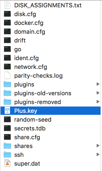

I am in my flash drive and cannot for the life of me find this config/passwd, /smbpasswd, or /shadow files.  I'm using unraid v6.  Where am I going wrong?
What OS are you using.  I checked it just now with both my windows 7 computer and using Krusader (Docker) in unRAID and the files were there.  You might want to check the configuration of your file browser/explorer to make sure that the display of system files is enabled.  I know that in Win7, it blocked by default.  (I believe that most OS's use these same names for these files.)
Ive got it sorted. Managed to scrounge up a monitor and keyboard and did a command line passwd reset. Thanks for the response though!
