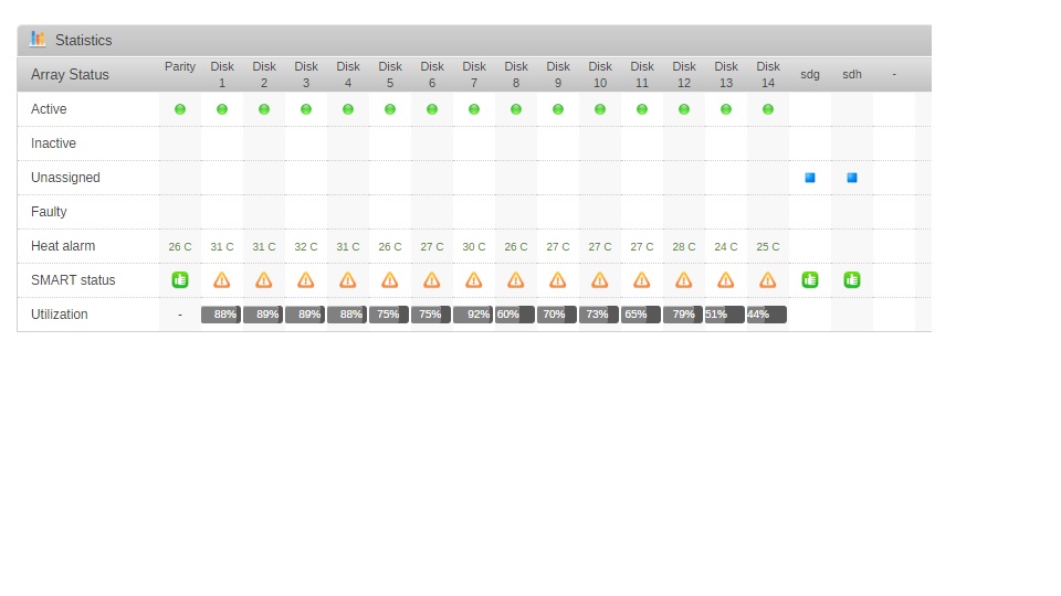

Every disk has CRC errors
Every single one of my data disks has CRC errors.  They are spread across the motherboard controller and two PCIe controllers.  Combination of several brands of SATA cables, including two breakout cables coming off an LSI.
What could be causing this?
Secondarily, and perhaps related, I've noticed that some of my files are corrupt.  While looking through old picture, many only load halfway or not at all, and some home videos don't play anymore.
