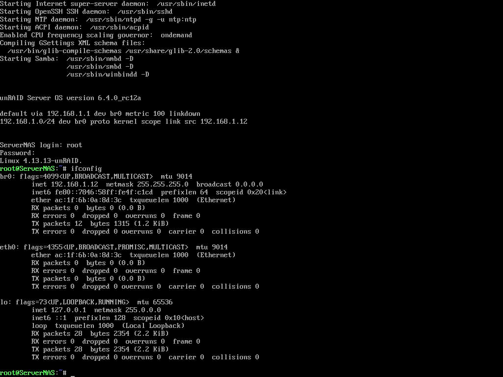

No network access (SOLVED)
I rebooted my server and now I have no network access at all. Not sure what my options are as I have no gui access. Attached is what ifconfig spits out.
I recently had the same issue, it was a phone or something that isn't always on the network took the ip address that my unraid server has statically assigned to it.  Hope it's something simple like this for you.
No go. I dont think I have any communication to unraid. If I run ping tests to local machines or websites they all fail from the console.
Disconnect unRAID by pulling out the lan cable first. Then try to ping the unRAID IP. That'll quickly let you know if anything else is using unRAID IP.
Nothing else comes up on the ping with the server unplugged.
Did you change anything before you rebooted? Why did you reboot?  Have you had jumbo frames enabled long?  Any change to any other part of your network?
Turned out to be an issue with my network switch. Quick reboot of the switch fixed the issue. Uggh...
