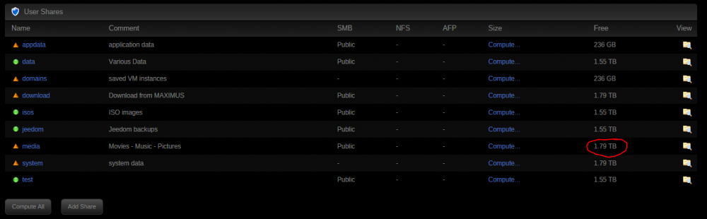

I switched from ubuntu server to unraid last week and I am having a little issue with my shares.
I am running unraid on a server with 5TB drives (4 data drives+1parity drive) and an SSD as cache drive.
My main shared folder is my media folder which doesn't use my cache drive.
However, when we have a look on that screenshot we can see that:
  • Unraid tells me that some of my data are not protected in that share
  • Unraid tells me that the the remaining space available in that share is 1.79TB when there is only 1.55TB available. Those 1.79TB includ the Cache but it shouldn't.
As a comparison, the share named "Data" has the exact same setup as "media" and works well.
Any Idea?
Cheers
The means that a "media" folder exists on cache (with or without files inside it), change the share to cache "yes", run the mover and when done change it back to cache "no".
Hi Johnnie.black
Thanks for your quick reply. That was it indeed. It's now fixed.
However, how is that possible that I had a "media" folder on cache when it's been set to "not use cache"' since the very beginning?
Shares are just top folders, someone or maybe some docker created a media folder on cache.
