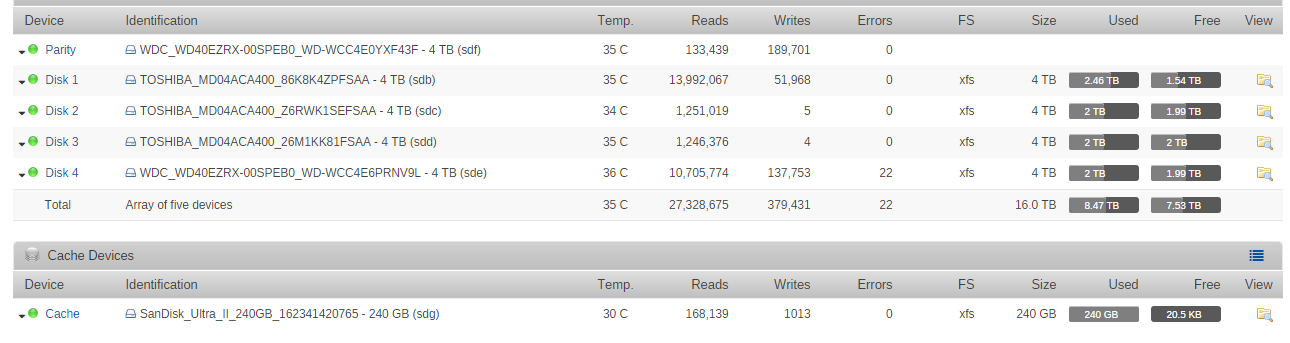

It's my first time to unraid after having seen the benefits of it on linustechtips.  After building my configuration with 5x 7200rpm hard drives and adding a 250gb sandisk ssd as a cache drive, I've noticed that the Cache always appears to be totally full and that it doesn't seem to be releasing back to the main array as shown by the picture here:
Is this what the cache drive is meant to look like or is something broken on my installation? - Thinking that perhaps I may need to have it purge more frequently, I set the replication to occur hourly, but even this doesn't seem to have made a difference.

Without knowing what folders/files are on the SSD at the top level and what your Share settings are corresponding to the folders it is difficult to comment.
Edited by itimpi
Building off of what itimpi said, your shares have an option on them regarding the cache. It can be set to yes/no/only/prefer. If your shares are set to only (and maybe prefer I am not sure) then the mover will not move the files to the array. The setting you are probably looking for is just 'yes'.
Also and in case you didn't noticed there are read errors on disk4.

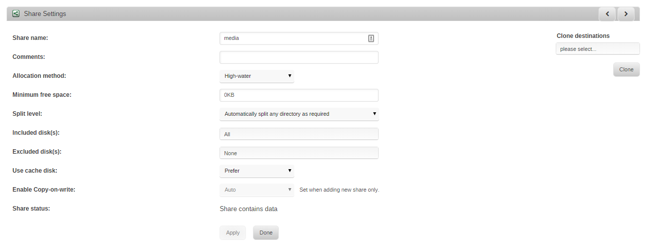

Thanks guys for the feedback.  Here's a screenshot of my share settings:
I might try adjusting this to Yes and see if this makes any difference :) - And yes, I'm aware of the failed drive, something my old NAS didn't pick up before I replaced it.  I've ordered another 2 drives to replace it which should be here tomorrow.
I can confirm after setting to Yes, this worked perfectly and mover is now finally clearing up the SSD.
