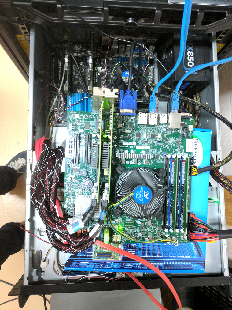

I recently did a full swap of the core components (I've done this once before). I replaced a Gigabyte MB with 3 Supermicro 8 port contollers with a Supermicro MB and 3 LSI contollers, so definitely the port assignments aren't the same :) It all just came right up without issues. I wouldn't make any changes to the drives until after you've moved to the new MB. Once all that is good, then start the process for upgrading the Parity drive(s). Check the docs for doing that. Once you are upgraded to the new parity, then go through the preclear steps for the new data drive(s).
Here's a pic of when I tested it out before doing the actual swap :)
