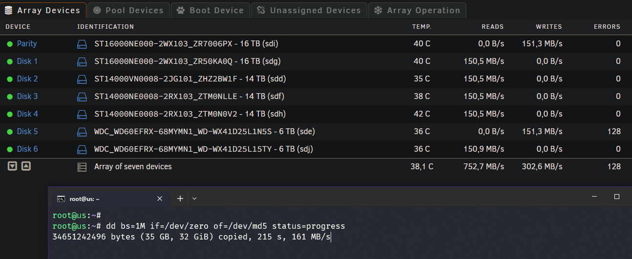

I am also busy with clearing a disk (Disk 5 in the array) for removal without having to rebuild parity.
Disk 5 is being cleared by the dd command, but does it matter that the parity is updated in the meantime? Does it affect clearing speed or something? Or strain the system unnecessary?
The whole point of this technique is to update parity as you go to reflect the fact that sectors on the drive to be removed have been zeroed.  That is why you can later remove the drive without affecting parity as zeroed sectors have no effect on parity ones.

It might be wise have to use nohup or screen because of its long process then won't get stopped when the PC one is logged in from crashes or anything.
I stopped the dd process with Ctrl + C and created a screen session for it just to be sure.
Edited by Ymetro
I agree.   I might issue a pull request to the documentation (it is on GitHub) to add this as a suggestion.  It needs updating anyway to say that starting with the Unraid 6.12 release the partition is now part of the device name (e.g.  /dev/md1p1 instead of just /dev/md1).    I ‘think’ this change has been made as part of a future plans to support ZFS format drives bought across from other systems which have the ZFS partition on a partition other than the first.
