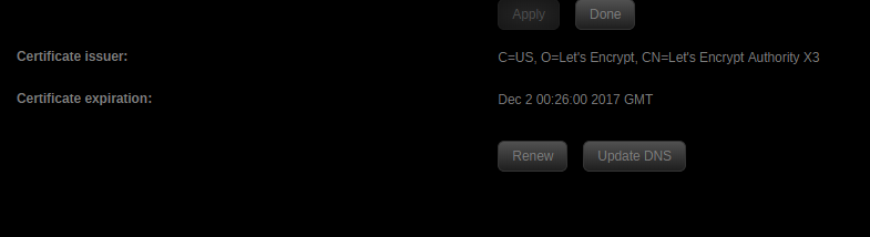

I've been in and out of the server all day. Just now Chrome warns me the SSL cert is expired.
I had the same issue.  Additionally, the Renew button was disabled. I had to look at the code to figure out it will only renew when "Use SSL/TLS" is set to "auto" and not "yes".  Is there a reason you can't renew when it is "yes"?  In my case I set it to auto and left it there.
Edited by ljm42
  • Replies 134
  • Views 18.9k
1 hour ago, interwebtech said:
I've been in and out of the server all day. Just now Chrome warns me the SSL cert is expired. I thought this was automatic?
It would appear there isn't enough padding on the expiration to handle PST time zone. I am going to manually renew.
new expiration: Mar 2 03:42:40 2018 GMT
Maybe this needs to auto renew 24-48 hours prior to expiration?
The Renew button enables if within 30 days of expiration.  At present this is not done automatically, you have to click the button.  We'll be adding an automatic cert expiration check, as well as auto dns update daemon before 6.4.0 'stable' is published.

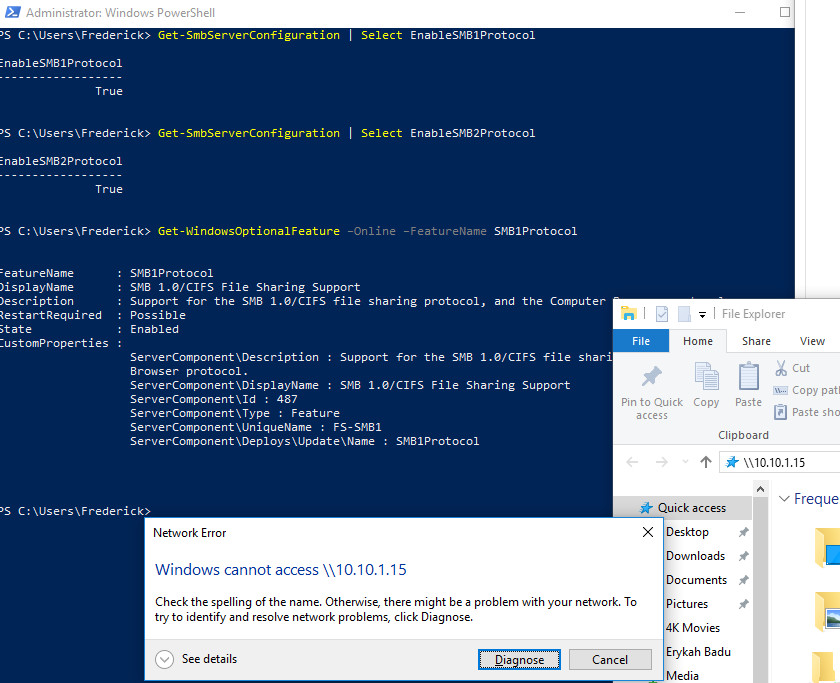

Weird because I can SSH to the server so it seems that port 445 is being blocked? I'm not sure what unRAID uses but I would assume that's what port my computer is trying to connect for SMB.
homesrv01-diagnostics-20171201-1906.zip
So this is weird. It works on my Ubuntu desktop using SMB but will not work from my Windows workstation. Even after a reboot.
Right, these controls might be a bit confusing (still a work in process).  Basically 'Auto' means "Lets Encrypt using SSL cert mode", that is, use SSL if a LE cert has been provisioned.  Renew is only possible with a LE cert.
Have you ever disabled any SMB2/3 related settings in Windows? Latest Samba disables NTLMv1 login by default, check if all your Windows SMB settings are default.
FWIW Windows 10 1709 now denies access to unauthenitcated SMB
Not sure if this is your case tho

I'm not really sure what to do. I've manually ran commands to enable smb v1, 2, and 3. Still can't connect from Windows 10. Here's my diagnostics file again if anyone would like to take a look.
homesrv01-diagnostics-20171203-2022.zip
I have not disabled any SMB versions and I have even ran commands in powershell to manually enable them just to make sure.
about fall creators update on win10 disabling smb1:
https://mspoweruser.com/to-prevent-next-wannacrypt-microsoft-will-remove-smbv1-file-sharing-in-next-version-of-windows-10/?utm_source=feedburner&utm_medium=feed&utm_campaign=Feed%3A+msftnws+(Microsoft+News)
how to re-enable it, from power shell do:
Set-SmbServerConfiguration -EnableSMB1Protocol $true
for more information visit:
https://support.microsoft.com/en-us/help/2696547/how-to-detect-enable-and-disable-smbv1-smbv2-and-smbv3-in-windows-and
Edited by zoggy
1 hour ago, zoggy said:
Like I said in a previous post. I already made sure that SMB1 was enabled.
Edited by FredG89
You don't need SMB1, unRAID defaults to SMB3, try again after starting unRAID in safe mode, if still unable to connect the problem is likely on the Windows side, a new Windows install using default settings should work without issues, try with another computer or borrow a friend's laptop.
i had the same issue with fall creators ...
my network was auto changed to public instead private ... did you check that ? in public mode i also had no access anymore ...
Yes, that is one of the first things I checked.
