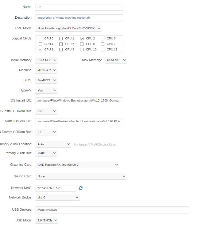

I´ve problem with a unstable Win 10 after installing the GPU drivers (AMD/NVIDIA).
I´ve installed a GTX1050 and a RX460, which works fine in other maschines (no problems with driver or crashes).
so here is the problem:
When Windows 10 is installed, there are no issues with crashing, flickering or shutting down the entire Unraid server.

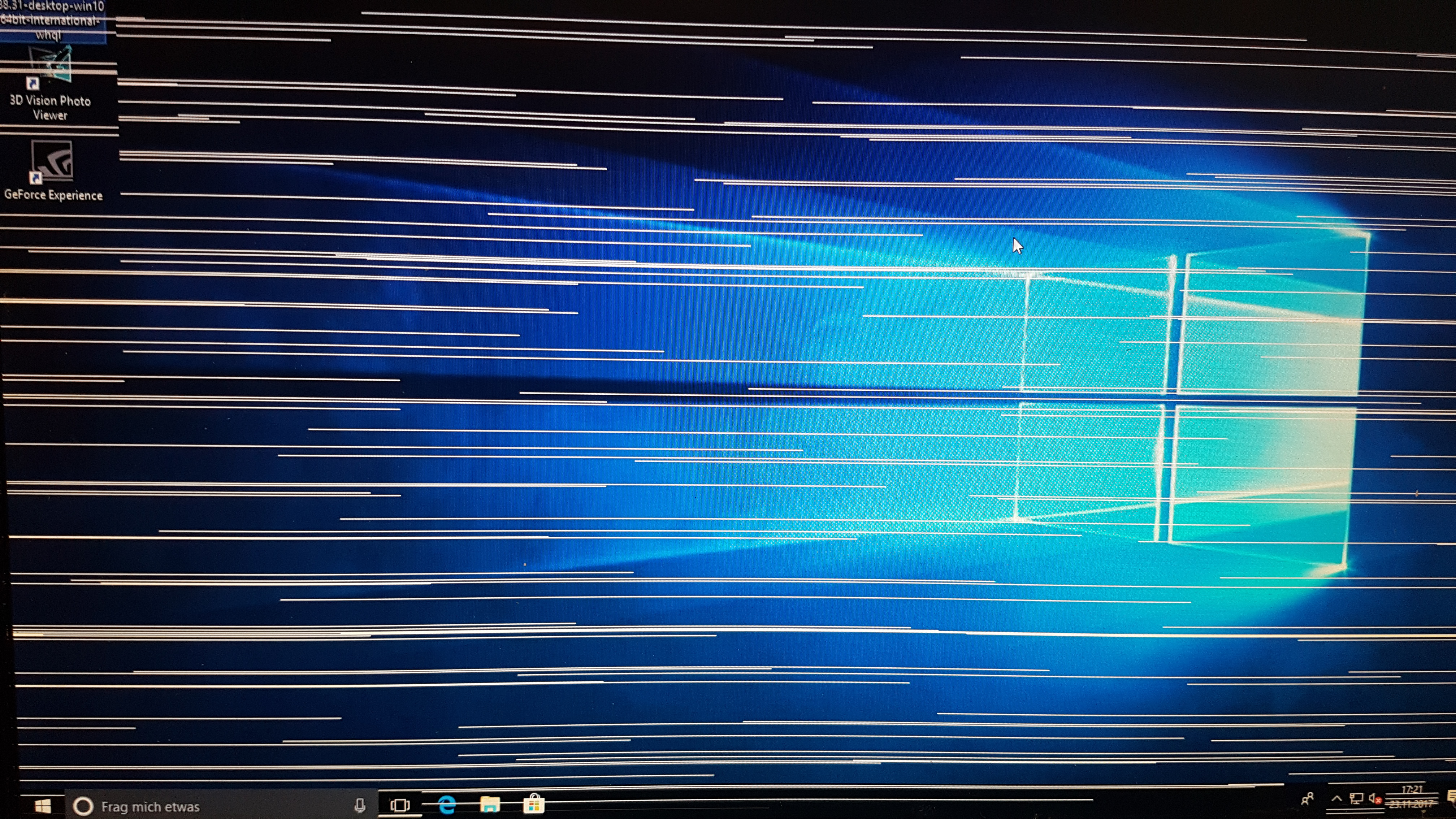

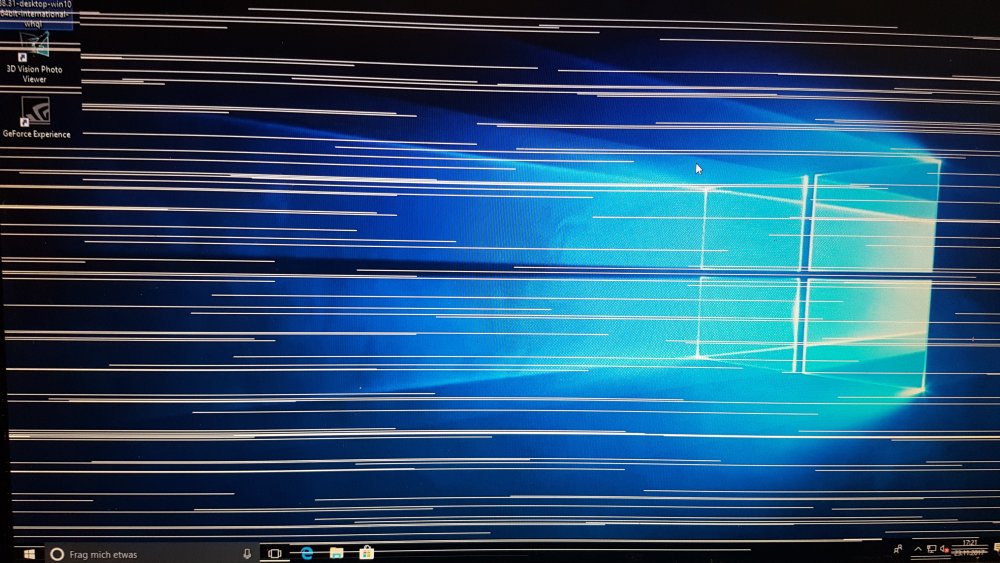

But when i install any driver for the GPU (AMD OR NVIDIA) , i´ve a unstable OS. It crash randomly, sometimes the desktop flicker and when i open a  internet browser i become a black screen and the entire Unraid server stuck and crash (sometimes immediately, sometimes it works 1h).
my VM settings:
Can you help me?
Edited by schecter948
Try passing through the sound part of the GPU as well as just the gpu. These 2 parts should be passed through together as they are part of the graphics card and in the same iommu group so should both be passed through together. Please try and report back.
