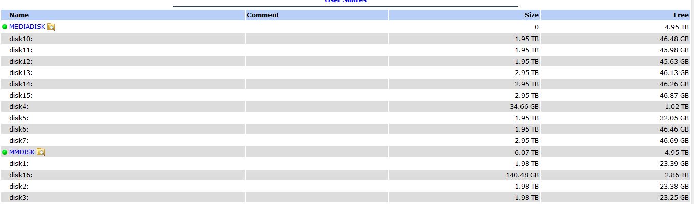

Missing contents on main share

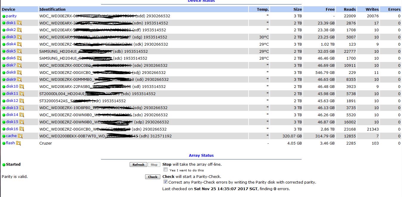

Recently i have one disk failure and i did a replacement and rebuild.
After that rebuild done, another disk showing errors and i shutdown and did another replacement and rebuild.
When all the rebuild done, i realise my main share is showing empty and i create another main share and i got the contents showing.
However, only after sometimes i realize some contents are missing and when i did a folder size compare i realised it is not using all the disks in the main share.

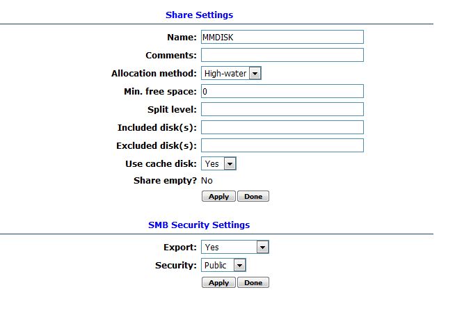

A little on the background.
MEDIADISK was my only main default share.
MMDISK share is newly created because MEDIADISK is showing empty.

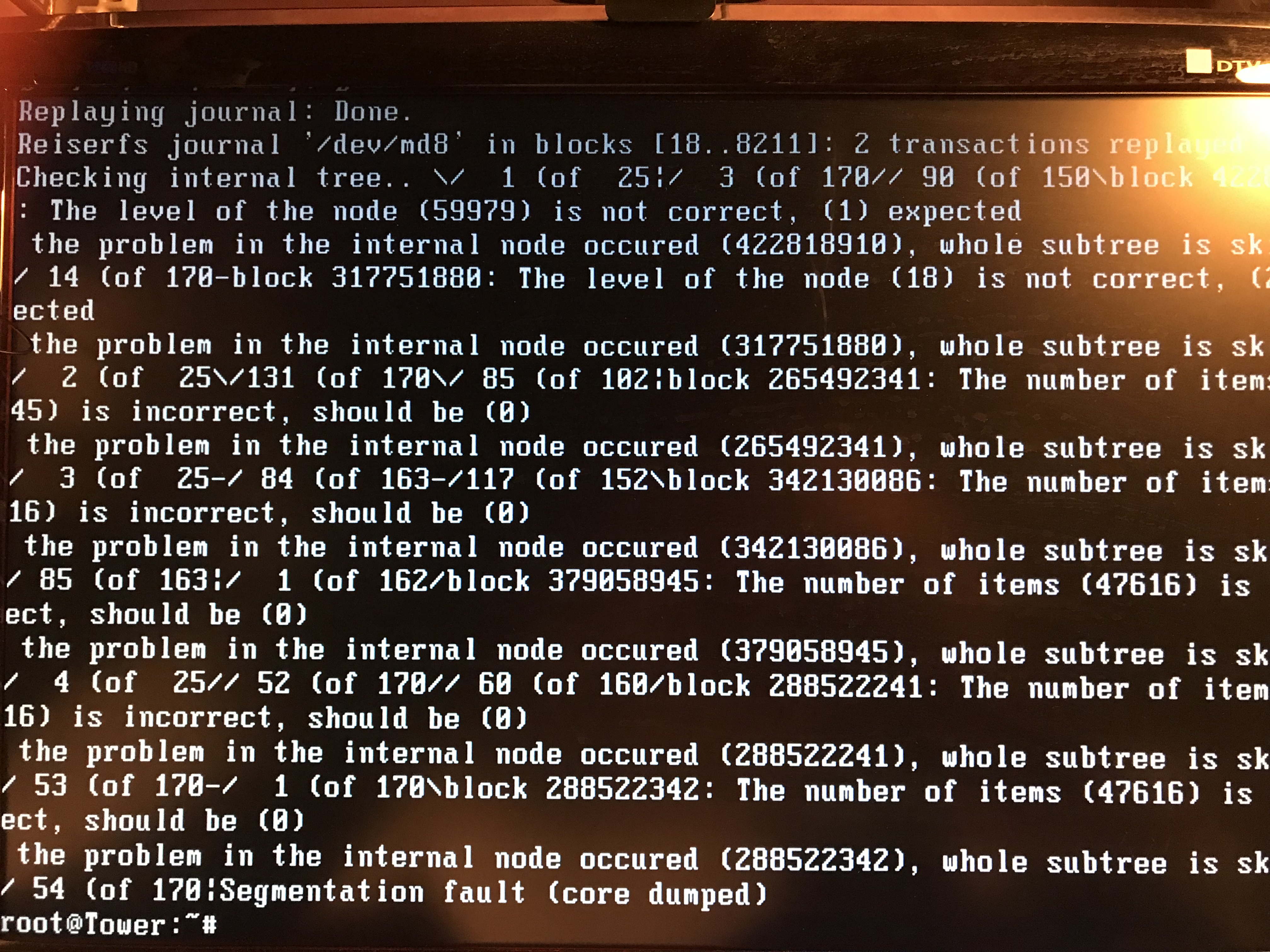

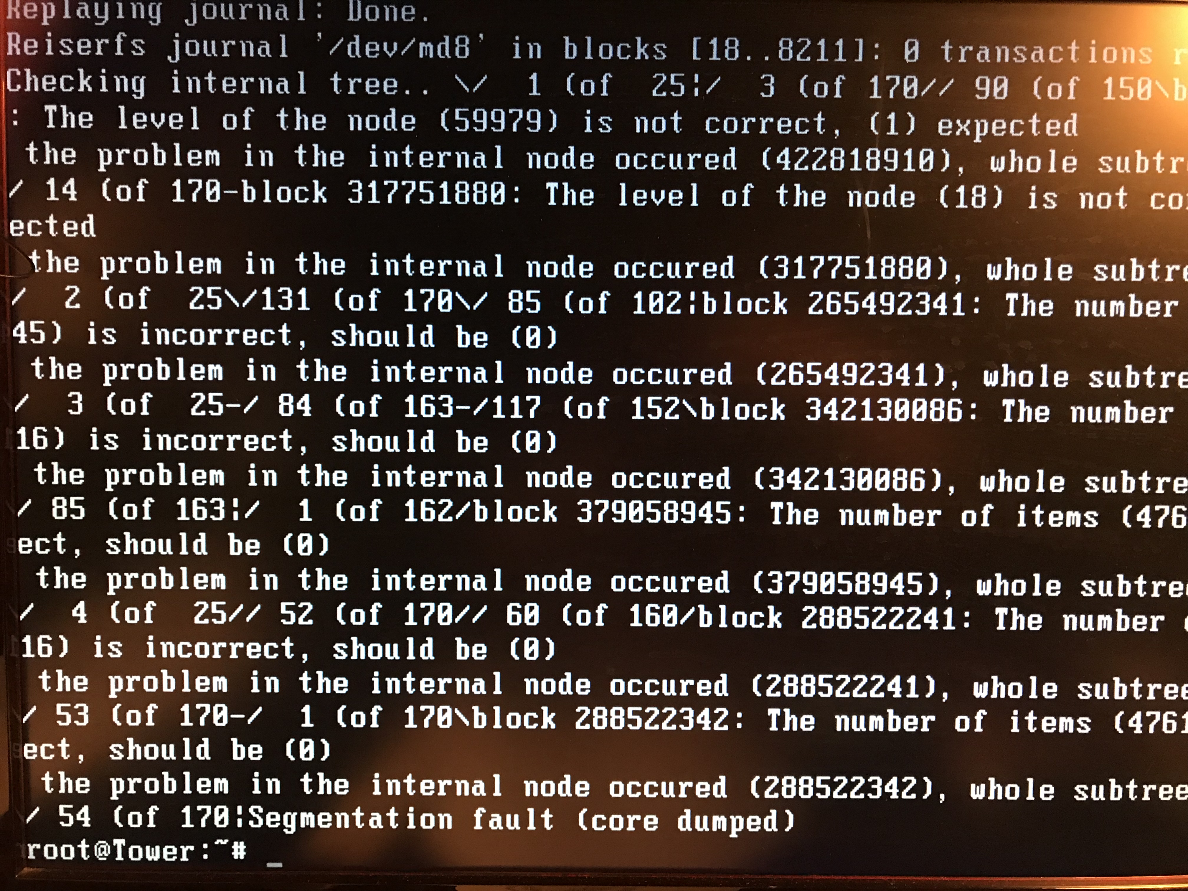

You need to check filesystem on disk8 (md8)
Can advise how do i perform that ?

It's disk8 you need to check:
/dev/md8

Yes, first fix the filesystem.

By the way, why did you say its disk8 ?
Because when i access disk4 using the default share, it is only 32GB used and not same as reported in UNRAID.

Nov 25 14:56:01 Tower kernel: REISERFS warning: reiserfs-5090 is_tree_node: node level 59979 does not match to the expected one 1
Nov 25 14:56:01 Tower kernel: REISERFS error (device md8): vs-5150 search_by_key: invalid format found in block 422818910. Fsck?

i have started the -fix-fixable....
How do i see the progress of this or i have to wait for it to complete and check the log ?
Is there anything like live progress i can see what is going on ?
Just watch the console/SSH.
nothing showing for more than 30 minutes...
Post the output of reiserfsck.
haha i realised the command did not execute previously and after i reenter same, and enter Yes, it started to run... and after sometimes done and back to CLI... does that means it is completed ?
output.
If this is completed... what's next ?
It didn't finish correctly, run --check again.
Ouch, the program didn't end as expected - the last output is a segmentation fault :(
One of the disadvantages with Reiserfs is the lack of support after the inventor got himself sent to jail for murder...
At least try to run the command a second time and see if it gets further or if it fails at the same location again.
Again it stopped at segmentation fault :(
