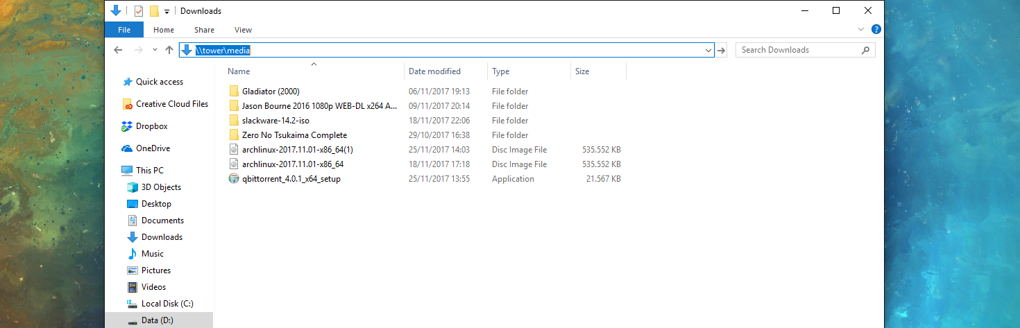

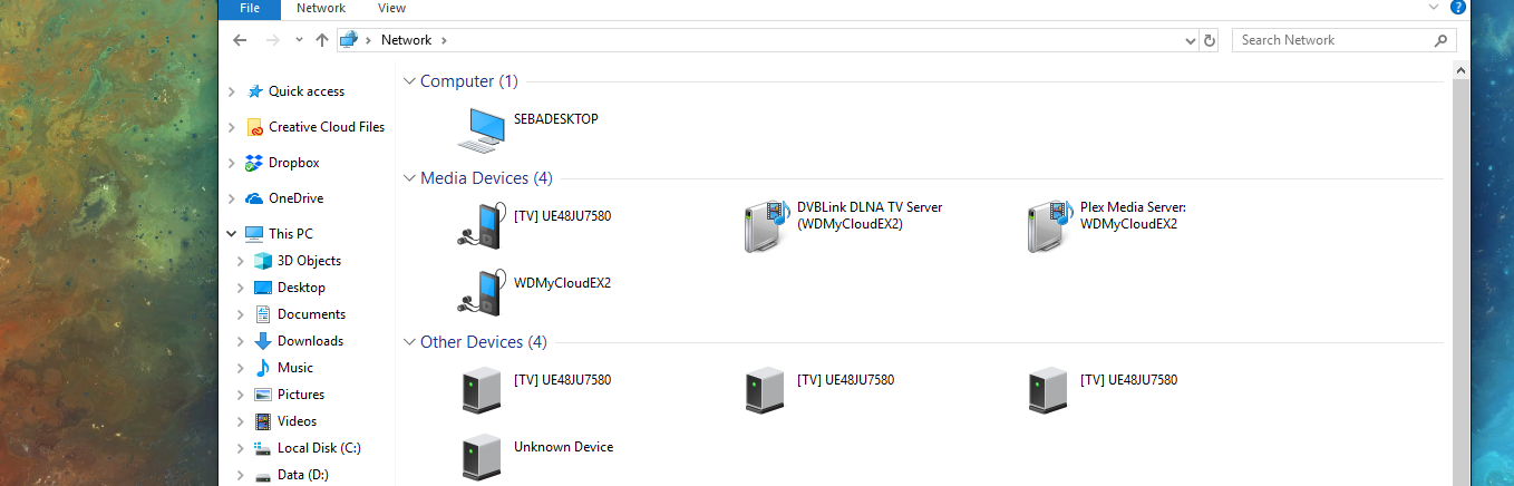

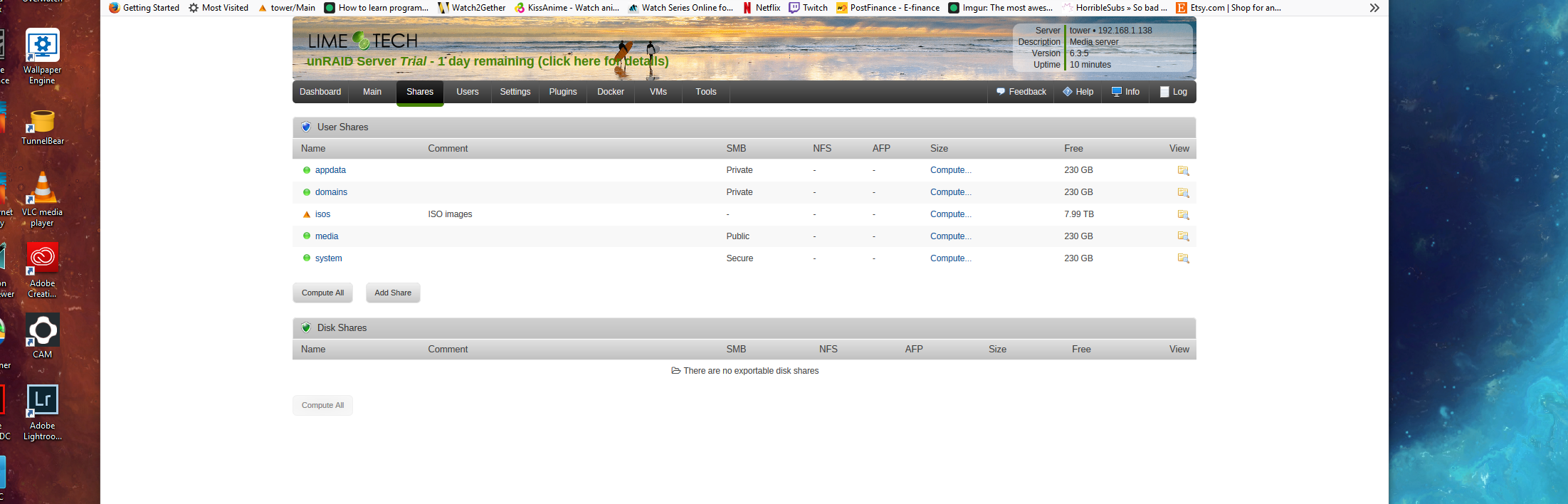

Hi guys, I have finished rebuilding my server and turned it on and I'm having a bit of an issue, I can access the web-GUI without a problem, but I don't see server under mappable drives. So I looked on the forum and saw that I can access the shares also by going to file explorer and typing "\\tower\media" for example. Doing this then prompts me to do the login both of my windows password and my unraid login but then it says windows can't access it. Even though it is a public share!!
I did all the solutions I found here such as changing to "WORKGROUP", checking that server,TCP/IP NetBios helper and SSPD Discovery were active (they were), checking that DIscovery was on and that I was on a private network.
Problem endemic to Windows basically since day 1.  Microsoft problem.  So much easier to just add a quick access shortcut to the server (by using the IP address).
So far as I've been able to gather, the bulk of problems like these result from credential caching within windows.  Clear the stored credentials in Credential manager.  Beyond that, Microsoft's decision a while back to try and force people to use their MSN account to log in to Windows, instead of local accounts has caused no end of problems across the board for access to all NAS's.  I can't help you out because I have never had any problem ever accessing my shares, be they private, secure, or public but I've also never in my life took Microsoft's force feeding me a MSN account.

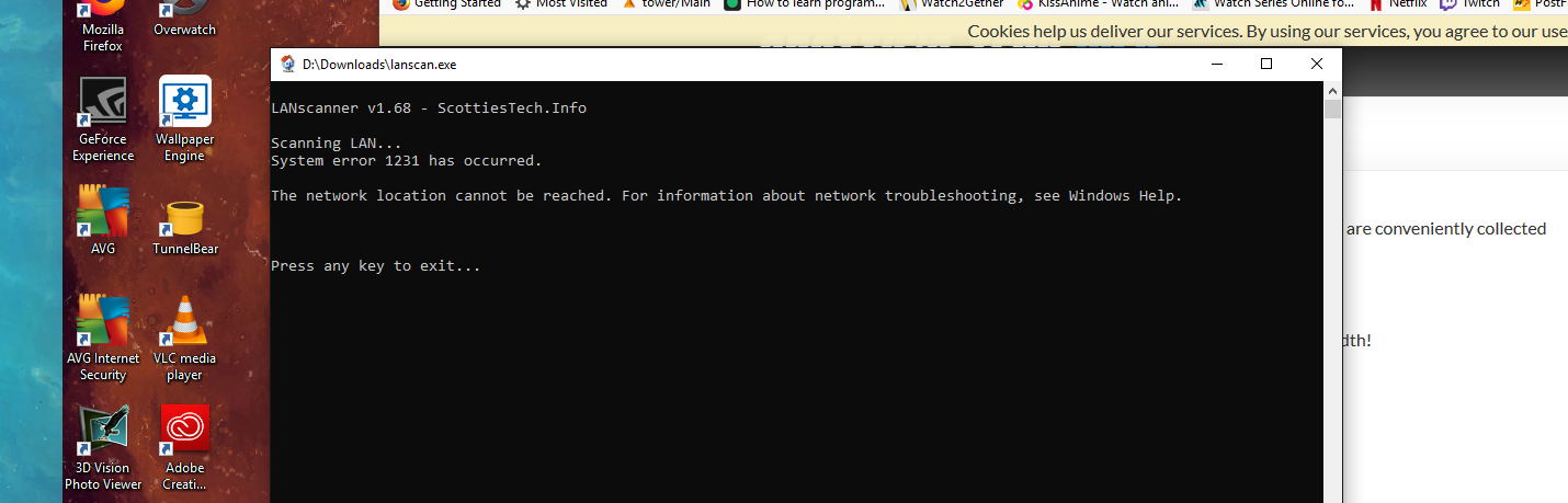

Ok just tried it and this happened (see image). The same happens when i type "net view " in command line. My internet connection is stable and working without issue.  What the hell is going on...

Its a Windows 10 issue - not present at Win 7

I am sorry but I don't run Win10.  You might try googling the Error Message Number from LANscanner to see if that turns up anything.  But I don't hold out much hope.  (Believe it or not, there are a lot of Win10 users who aren't having problems.  One of the big issues is that there are so many varieties of Win10 that even the Gurus who follow MS for a living have a hard time keeping them all straight.  I, personally, am going to stick with Win7 until I have to replace the hardware.  Hopefully by that time, everything will be fixed...)
