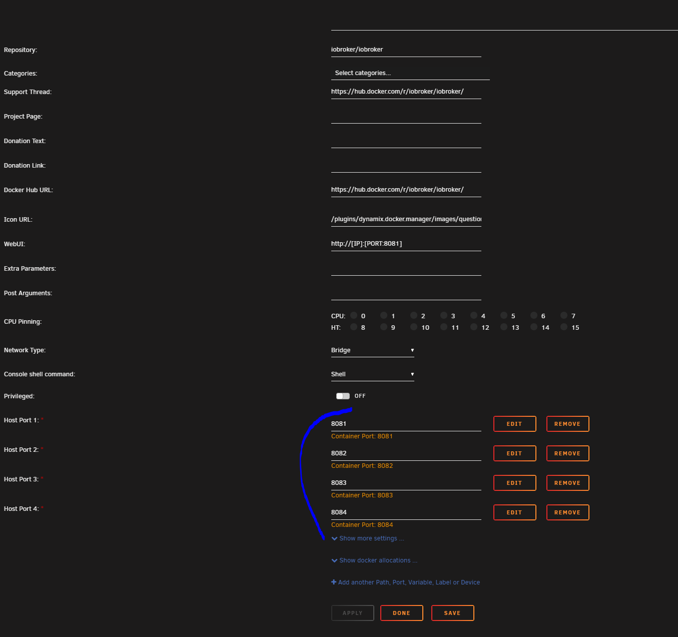

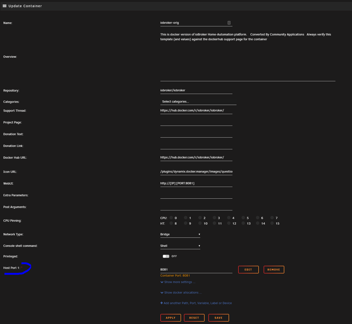

June 7, 20206 yr @Squid Hi Please could add some more hits how to run it? Ive picked https://hub.docker.com/r/iobroker/iobroker/ 2y old Then i added even more Ports: But still not loading the WebUI Tried also https://hub.docker.com/r/buanet/iobroker/ which seems more recent / updated, but the same problem. Thanks

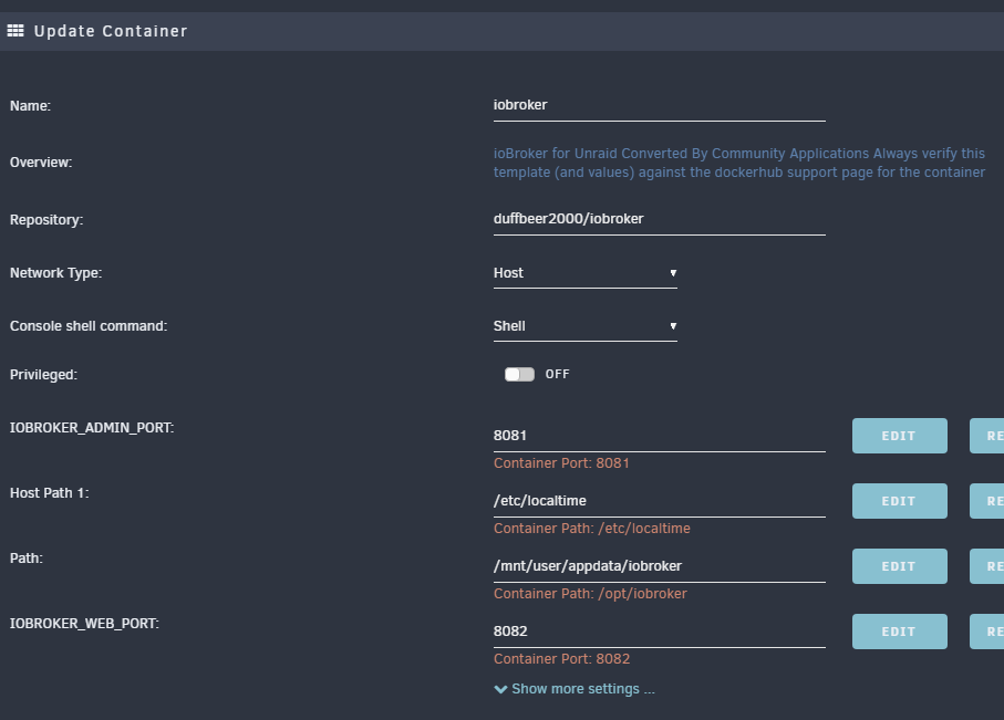

June 17, 20206 yr Hi guys, I was messing around with ioBroker aswell and found that the container https://hub.docker.com/r/duffbeer2000/iobroker/ was working for me, it hasn't been updated for 8 month as of today, but still better then nothing. Based on the Description in DockerHub I added the following variables: Hope this helps!

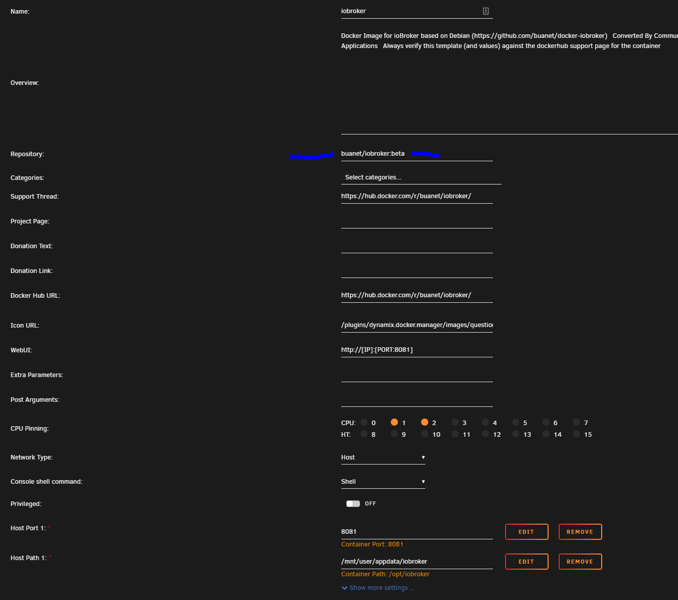

June 17, 20206 yr Hi Thanks for the reply, i got it working few days ago with help of one user in unraid Discord channel. Problem was that the default "latest" repo wasn't working, soon as i added "beta" all good and is pretty recent also https://hub.docker.com/r/buanet/iobroker/
