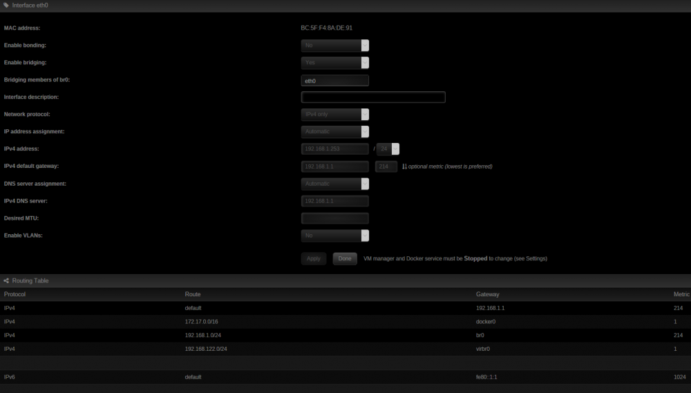

from Unraid?
Unraid itself gets its IP from my DHCP, wich has a static entry for unraid 192.168.1.253/24

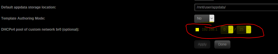

Gonna make a wild guess and say that needs to be enabled ( since when was that there?never noticed)
checked the box, started Docker and now it works
Thanks @bonienl
PS there is a Bug with the Subnets
After entering the Docker settings (dockerd off) shows /25 with 256 Addresses
Schould be /24 with 256 or /25 with 128...
