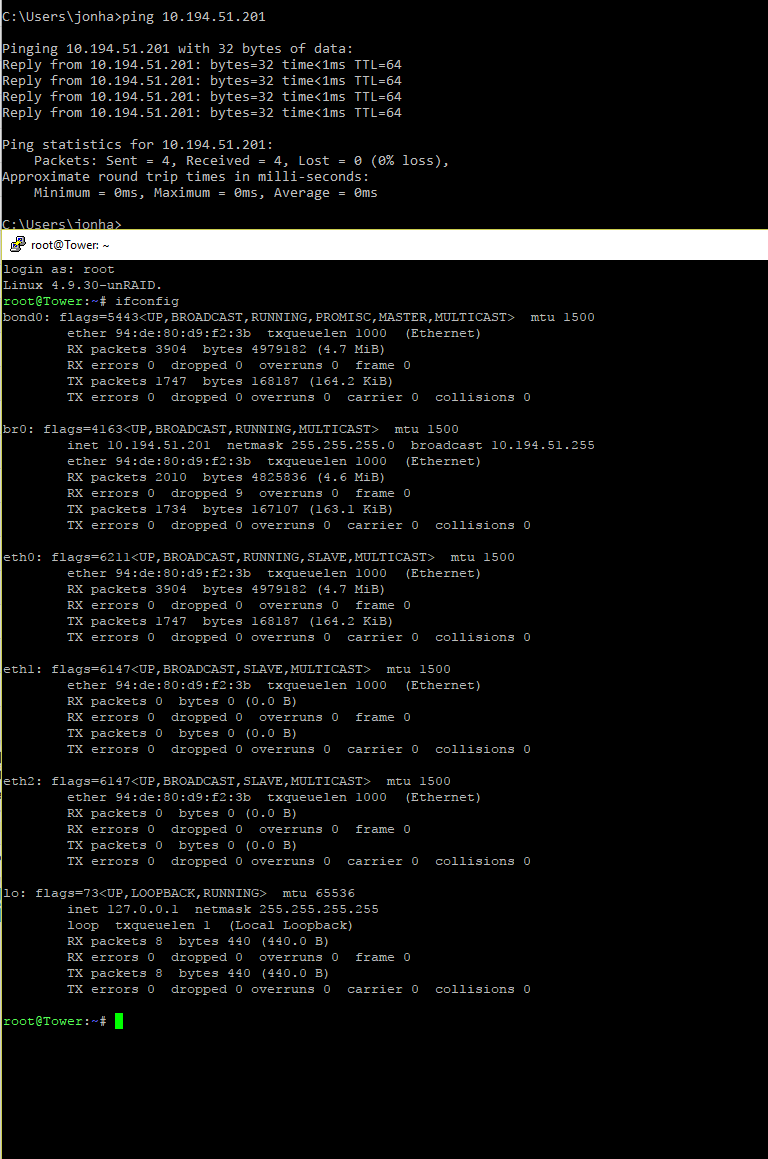

Attached pic of the network stuff from unraid. Anything seem out of the normal stuff?

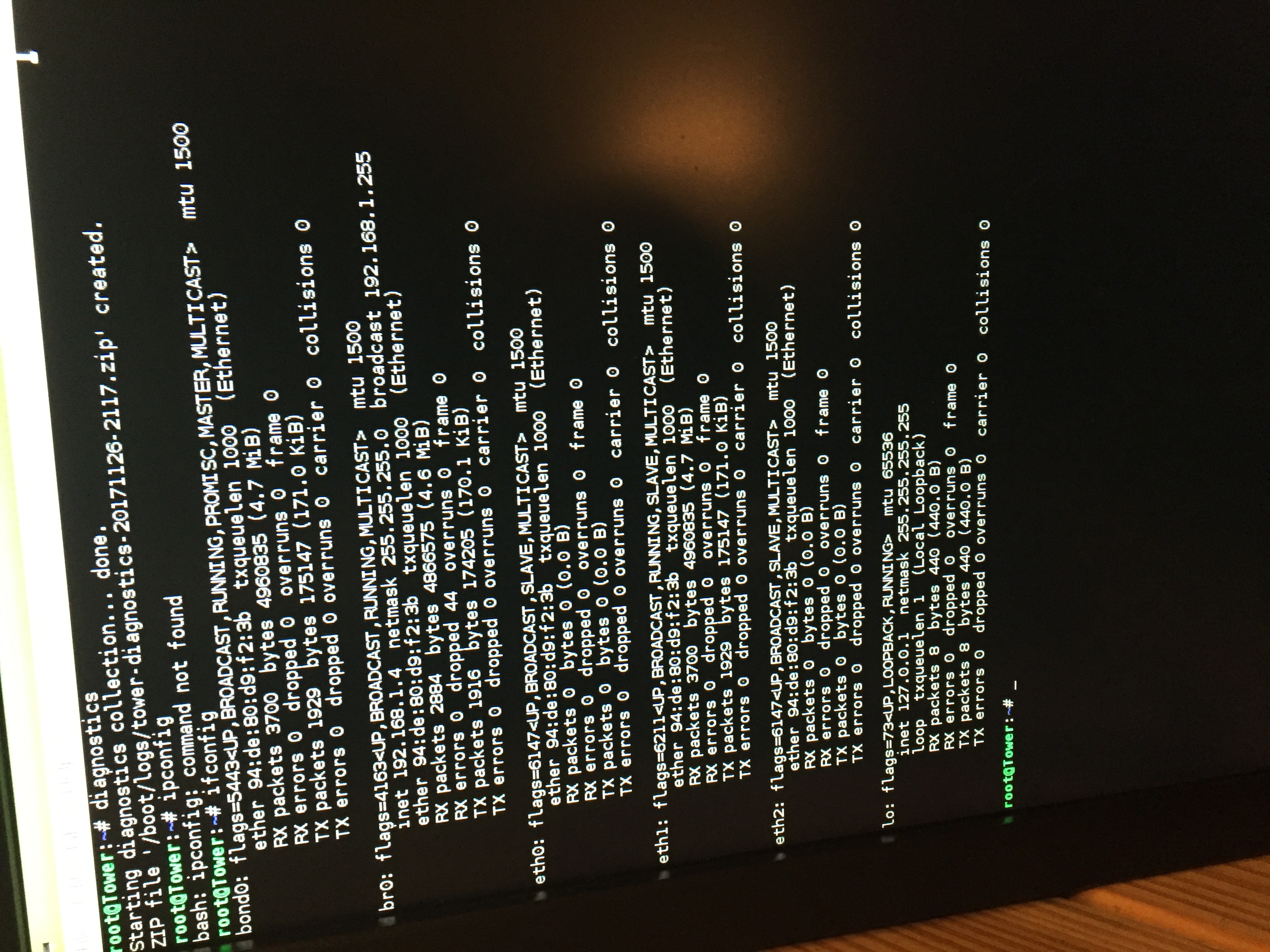

Sorry about it being sideways - monitor in portrait mode and phone switched when I took the pic.
Just looking over the br0 it has dropped 44, also the inet says 192.168.1.4, pfsense is static mapped as 10.194.50.201 for the tower - not sure if this is what's causing my issue?  if so, any ideas on how to fix it?
Ok so i thought i figured it out and when i was the 168 ip i checked the router and AP mode turned off and the router was assigning dhcp instead of the pfsense box.  Fixed that and thought I was going to be good for a second.  Still dropping on the server end... =/
You have captured at least one diagnostics file.  It is in the logs folder of your Flash Drive.  (See sideways photo in your third post. if you have changed anything since this file was created, generate a another file.)   Please post it up BOTH files.  The diagnostics file contains much information that is used by Gurus to troubleshoot problems, it can save hours/days to get to the solution by eliminating countless exchanges of posts requesting information!
