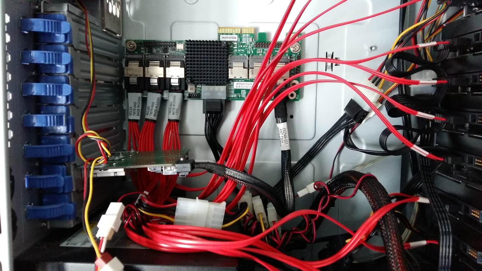

The expander can be mounted anywhere, inside or even outside the case. Just needs power and SAS feeds from HBA - and to not short out. It does not need to plug into a slot, although that is a convenient place as it supplies power and avoids need to mount it somehow.
Yep, this is how I'm using one of mine:
