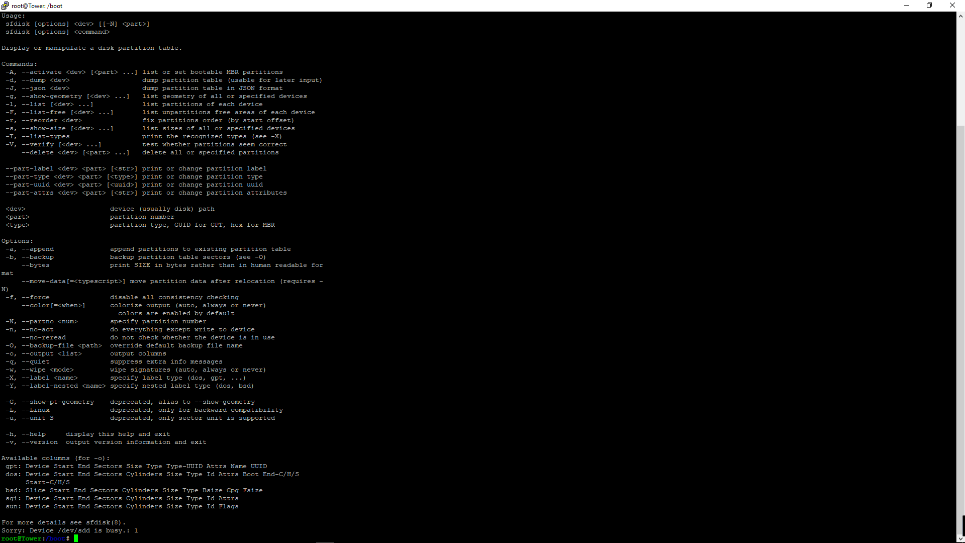

I used the preclear plugin. But when I try to run the script, it keeps telling me the drive is busy! Why can't I get this thing to preclear? I'm thinking of just putting the drive in the array and forgetting preclear.

Not sure what is there to kill. I rebooted the unRAID machine and it still says the device is busy. It looks like an error in the script to me.
Yep, looks like different issue.

johnnie.black,
Thanks! That did the trick! Preclear works again and reports my drive was successfully precleared. I am rebuilding my parity drive now.
