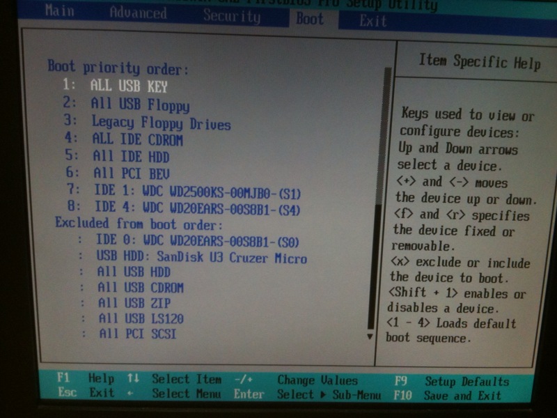

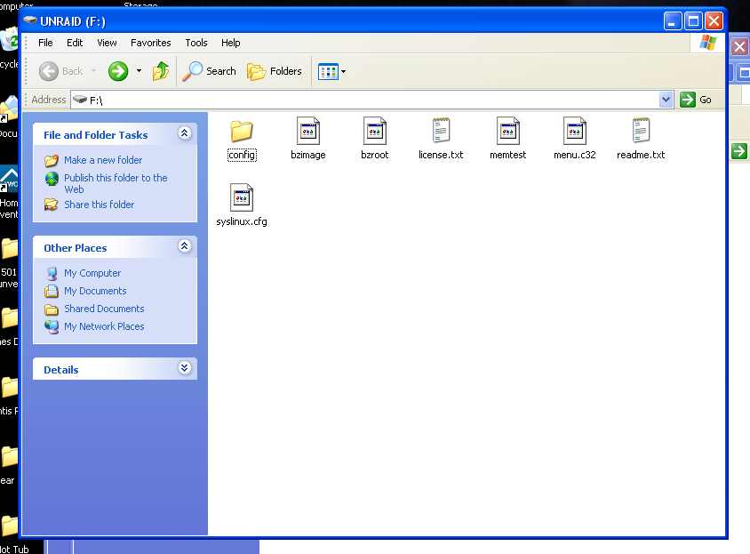

I will attach images of both what my USB files look like and what my BIOS boot options screen looks like.
As you can see, the BIOS sees the USB drive, but it lists it in the "excluded from boot order" list.  This is true regardless of which USB port it is plugged into.  Despite the BIOS options that appear to be available on the right, those only do anything with the drives listed in the "boot priority" list.  The only option that does anything to the drives listed in the excluded column is "<shift + 1> enables or disables a device", but that doesn't help either.  In fact, I think that it was already enabled and using that option disabled it.
Looking at my USB I cannot see the hidden file "ldlinux.sys".  The image attached is with the view hidden files option enabled.  Is this my problem?  Am I not properly installing syslinux?
Correct.  You have not installed syslinux correctly.
You must perform that step in a DOS window as "Administrator" if under Vista or Windows 7.
Under Win-XP you should be able to run it in a DOS window.  Just be sure to use the correct drive letter for your flash drive.
You must FIRST remove the U3 software, before you use the HP tool.    It sounds as if you used it.  Are you sure you gave it the correct drive letter?  The name in the BIOS will not change, so don't worry if it still says U3 in its name.
The big clue is the lack of the ldlinux.sys file.
Exactly what command are you typing to load syslinx on your flash drive?  I know I had huge problems getting my 1Gig Sandisk Cruiser to boot.  It was before it was known that you needed to use the "-ma" options to syslinux.  (are you using them?)
Joe L.
I originally tried to extract syslinux to it's own folder, but after that did not yield a bootable USB, I extracted it directly to my C: drive.  Then I used (first in the run menu and later in the command line) "c:\syslinux.exe -ma f:"

As I mentioned above, I can't see (in windows) a ldlinux.sys file on my USB.  I have show hidden files selected.  I have followed (I think) directions from the unraid wiki and then later instructions from several other sources.  No matter what I do, I still don't see ldlinux.sys on my drive.
I don't get it....
You also need to have "show system files" enabled to see it.  It might be there.
I have the same motherboard. I remember I had to fiddle a little with the default BIOS settings to get the system to boot from USB for the first time. Basically you have to have the USB stick in the top list (Boot priority order). In my case that list was already full with other devices, so I could not add anything to it until I freed a slot.
You first have to delete at least one device from the "boot priority order list". I am not sure how, but looking at the screen you posted I believe you have to select the device, then press "x". Once you created at least a free slot in the top list, you'll be able to add you USB drive to it from the bottom list. I would then just move you USB drive to the top of the list, just to be sure the system is not trying to boot from a different device.
Beats me why Supermicro would choose to implement such a convoluted way to change the boot priority.  ::)
Success!  I never thought of there being a limited number of potential boot devices.  After moving one out of the included list, I was able to move the USB drive into the included list.  Worked like a charm.  Many thanks to all for your help.
Oops, that was it...it was there all along

I've gone through this very same thing step by step.  I've gotten to the point where I no longer get the 'no operating system found' and have my flash drive as the #1 boot priority (actually it's the only thing now listed).  Now when I boot the machine the fans fly and nothing shows on screen.  I can't get to the screen where I have a menu to choose between unRAID or memtst.  I have a blank screen.  Any thoughts on this?
My hard drives all show, btw in the BIOS.
By having:  All USB Key, All USB HDD AND USB HDD: Flirefly (the flash drive I am using) all listed in the boot order list (top list of the one shown in first post) I have been able to get to the unRAID or memtst choices.

Looks like it's working but I noticed on the screen shot that it shows the USB HDD as being Excluded from the boot.
